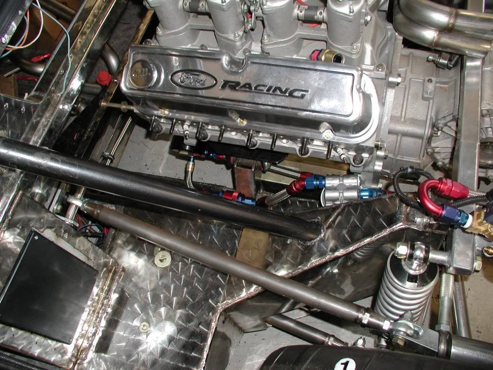

I sized my A/C system as the smallest they had, the Mini Gen II from Vintage Air. The compressor is a Sanden unit and the back of the compressor is even with the first head bolt about an inch beyond the face of the head. I don't know about the engine compartment of your car but with the DRB 40 the engine bay WAS a sloping surface from 30 inches(there about) at the top to a narrow 18 inches at the lower frame. Here is a pic of the original with the rear part already cut away.
I didn't like this arrangement when I started my build along with the welding of the steel panels on the car. I removed all the panels and replaced them with stainless and better welding. In the engine bay I removed the sloping panels and squared them off leaving a shelf arrangement.
This gave me a lot more room to work with, and it still left me with a 4 inch alley way to the rear of the car for the wiring.
and allowed me to do the alternator and compressor this way. Otherwise the engine would have sat much higher in the bay. and the clearances much tighter. The engine was moved slightly forward and the alternator which is on the front pully grove is 2 inches from the firewall framing and the valve cover is 1 1/2 inches from the top frame rail.

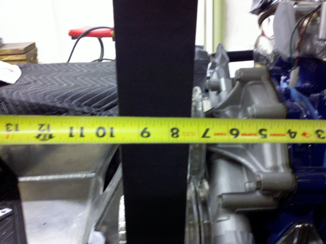

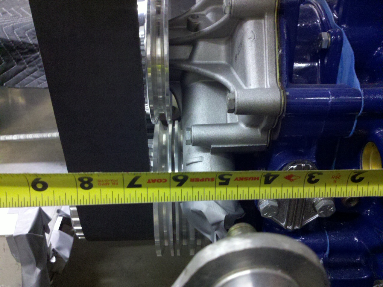

Thanks for the post everybody i will look up sanden unit later today.here are some photos of the space i have to fill distance from face of head,i would like to use second groove on pulley but it may not fit,if it does not fit i may have to go to plan b electric water pump and run alt and air off one belt.i have room forward of motor as fire wall will be in front of blower pulley but it is the sides of the motor (the frame) that is close.
