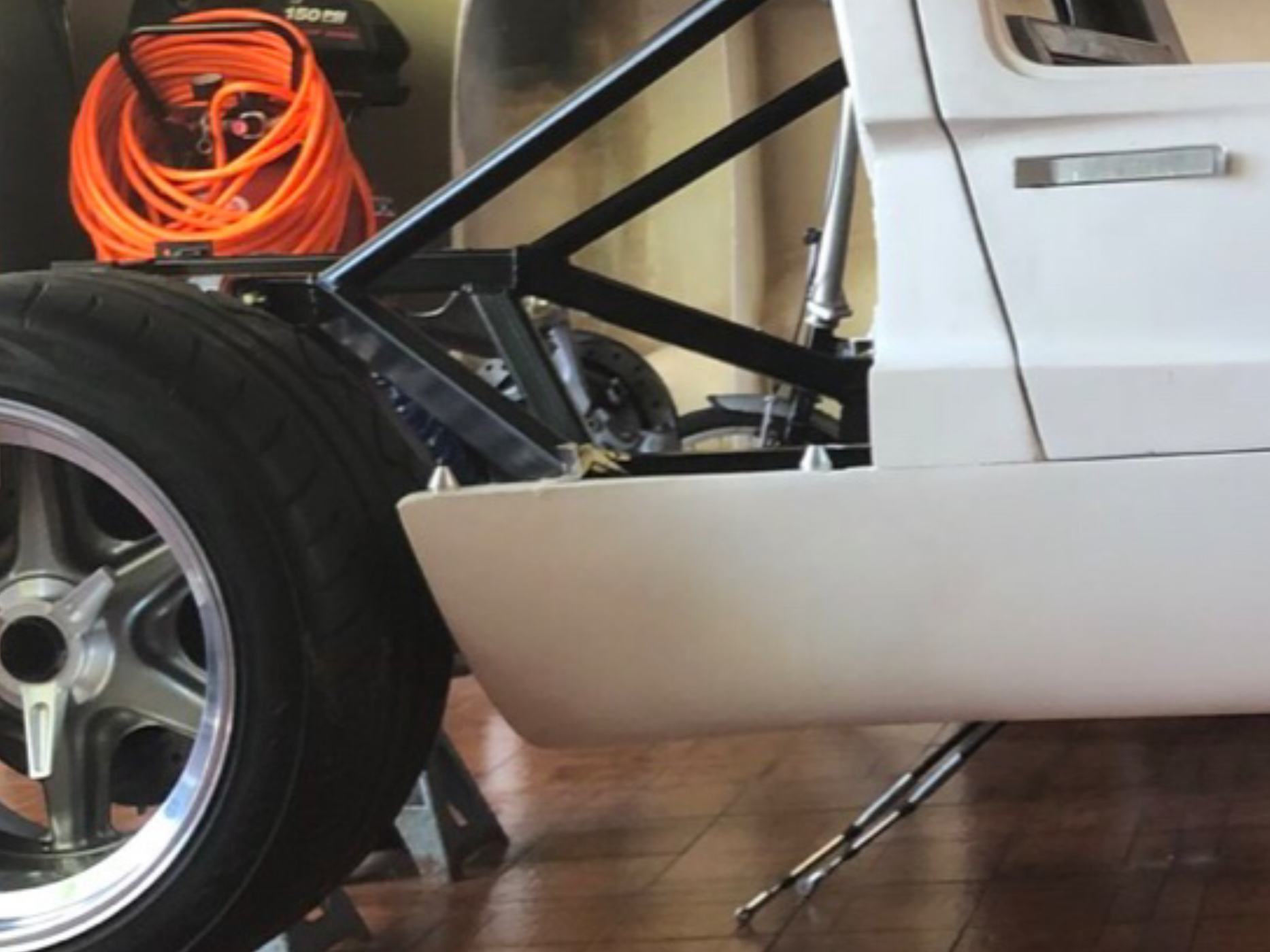

N Steve Borneman Mar 24, 2019 #1 Does anyone know what these silver body guides are actually called and where can I find them? Attachments 4517734C-86C1-4D92-A0F9-6B8C4DD9D0C3.png 2.1 MB · Views: 618
P Paulbav Mar 24, 2019 #2 Body location cones, triumph make something similar and Mick @ SouthernGT also makes some, get in the queue though
Ian Anderson Lifetime Supporter Mar 24, 2019 #3 Chris, Flatchat on this site makes them He is in Australia but posted mine to the U.K. in about a week Ian
N Steve Borneman Mar 24, 2019 #5 Paulbav said: Body location cones, triumph make something similar and Mick @ SouthernGT also makes some, get in the queue though Click to expand... Thank you
B Brian Kissel Staff member Admin Lifetime Supporter Mar 24, 2019 #6 I got mine from Flatchat (Chris), also. VERY fast shipping and excellent products. Highly recommended. I'm in the US, and shipping was fast. Regards Brian
N Steve Borneman Mar 28, 2019 #9 Hey guys, I contacted Chris and I’m getting 6 of them; 2 for the front and 4 for the back. Also, does anyone have any close up pictures of the body mounts on the chassis and body so I can see where the plastic rubber guide is mounted. Thanks a lot
