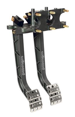

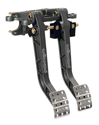

Trying to decide if I want to put the cylinders through the front bulkhead or back toward the driver (and reachable via the top access panel).
What do most of you do?
Will be using top mounted pedals so one of these will be getting ordered. Note accelerator needs to be separate and is supplied along with the PCM for the Coyote.

Darrin, have you looked at sizing? I built this exact model of pedal in CAD based off of the drawings on wilwood's site, and dropped it in my Tornado assembly. To get room to fit the masters, your pedals end up literally touching the floor. This is why the choices are pretty much limited to a build-your-own hanging setup that usually has a ratio of 5:1 or less unless you get VERY creative with packaging, or mount a floor pedal box (which becomes close to impossible if your steering rack is mounted low down as well.)

Looking at things and doing some measuring, I think facing outward (which means drilling holes in the paneling...no big deal) will give me the most room to work with the steering (no cylinders in the way) so that's the way I'll go with it. Think I may opt for the shorter pedal length though (12.25 total height with about 10 of that in the pedal swing area) to give me some more room to play with. It will make it 5 to 1, but that's fine for power assist.
Thanks Ian.
I did some more measuring last night and ended up up going with the shorter, reversed Wilwood pedal assembly here: Wilwood High-Performance Disc Brakes - Pedal No: 340-4828
I'll need to route the hydraulic lines to and from it from outside the bulkhead since it is reverse which might be a pain, but it was the only option to get the shorter pedal length I wanted. Going to be fun getting this part done....not!
