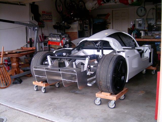

Make some of these. I have been using them for almost 20 years now.

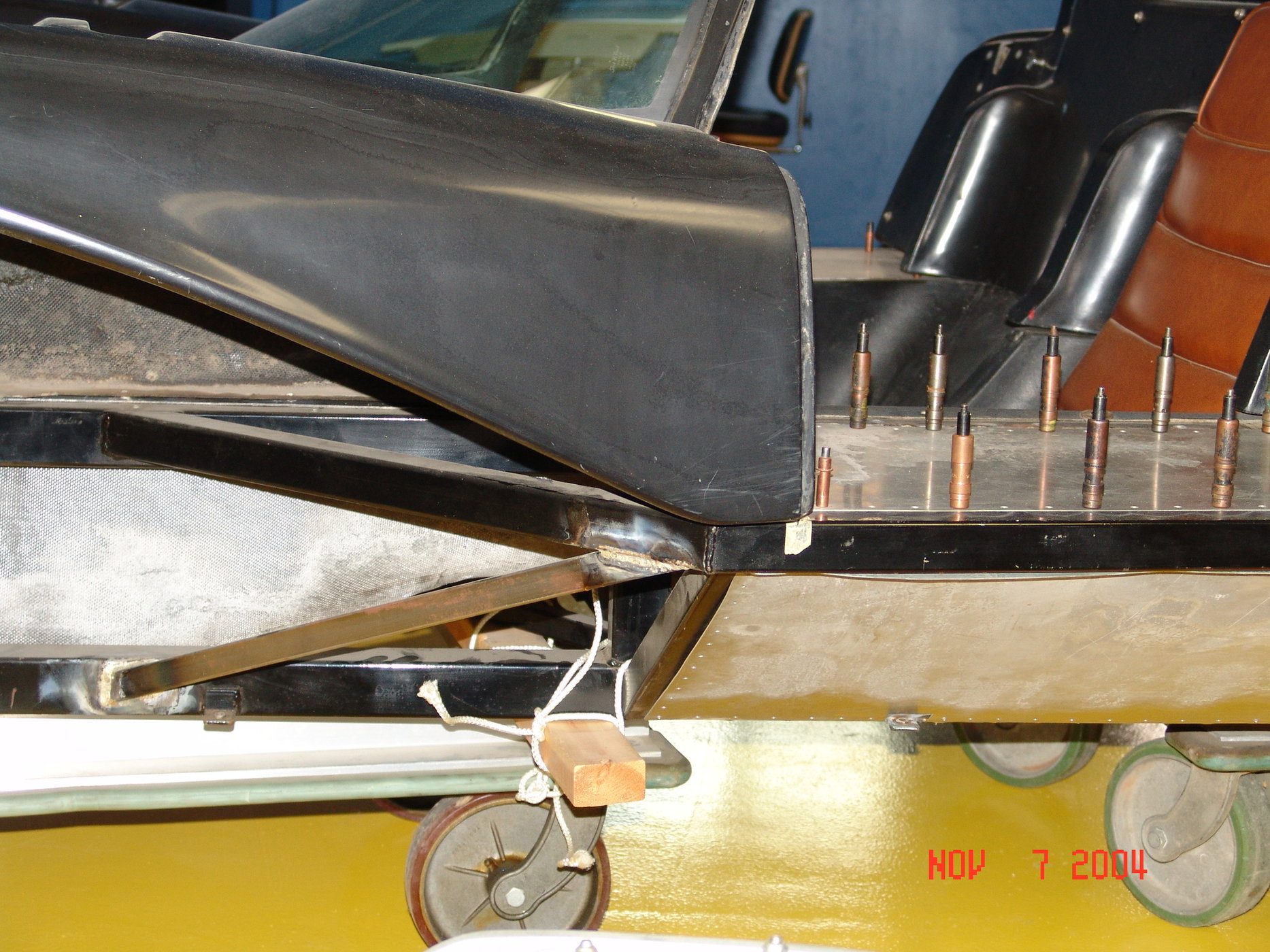

I wish I had taken some better photos of the dollies that I used to roll my project around the shop but they are gone now. I bought a couple of surplus guided missile carrier dollies from Raytheon here in Tucson. They had an aluminum frame with four ball-bearing swivel wheels with thin polyurethane tires. They rolled easily and could be locked into position. I don't know their load capacity but it must have been in the 2000 lb range.
@Howard Jones Thanks but I won't have the wheels mounted all the time so these are not so useful. However I have 1 pair of similar things and currenly one is serving as transaxle dolly :)

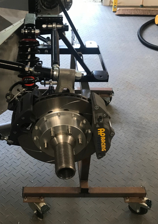

I got a set of these from Paul B when he had his SGT on wheels, what I love is the height they give its so much easier working on the car at a reasonable height but its best to "fix" to the chassis with big cable ties as its possible for it to slip.
They move perfectly round the garage. I think originally they were made by Mick at SGT, simple enough box section and decent castors, when done with I shall be passing them on to the next mad person who builds a GT40 :)
