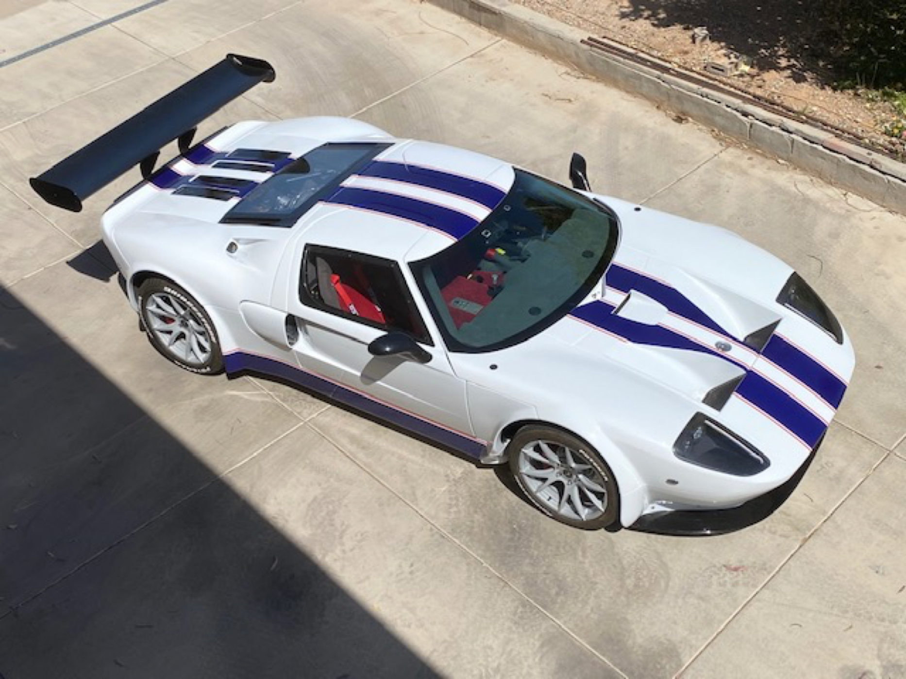

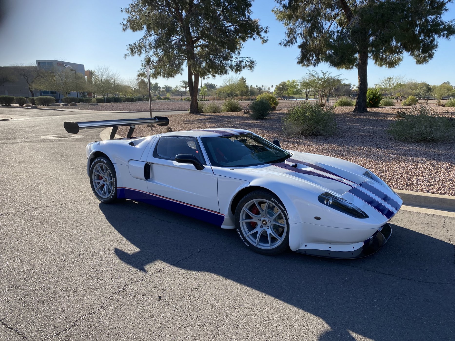

This build log is going to be very different from the usual log. Instead of starting at the beginning of a build and working my way through to the end, I am going to start at the end as I have just completed building my RCR GT-R. As I am an amateur builder, my estimated build process of 1 year actually took 5 years from the time I signed the contract to when I completed the project. Along the way, there were some high and low points throughout the build. As you can see from the pictures, the car is painted white with two blue stripes down the center and each stripe is highlighted on each side with red accent stripes. The lower side panels also have blue and red stripes that start at the front lip and extend back to the front edge of the rear wheel opening. The rear deck is hinged and the entire forward hood is built to tilt forward although it still requires two people to open and close as was the intent of the original RCR design. As this build was under a limited budget, I elected to use as much of the RCR furnished hardware as possible and fabricate as many bits and pieces as necessary either by myself or by local shops.
