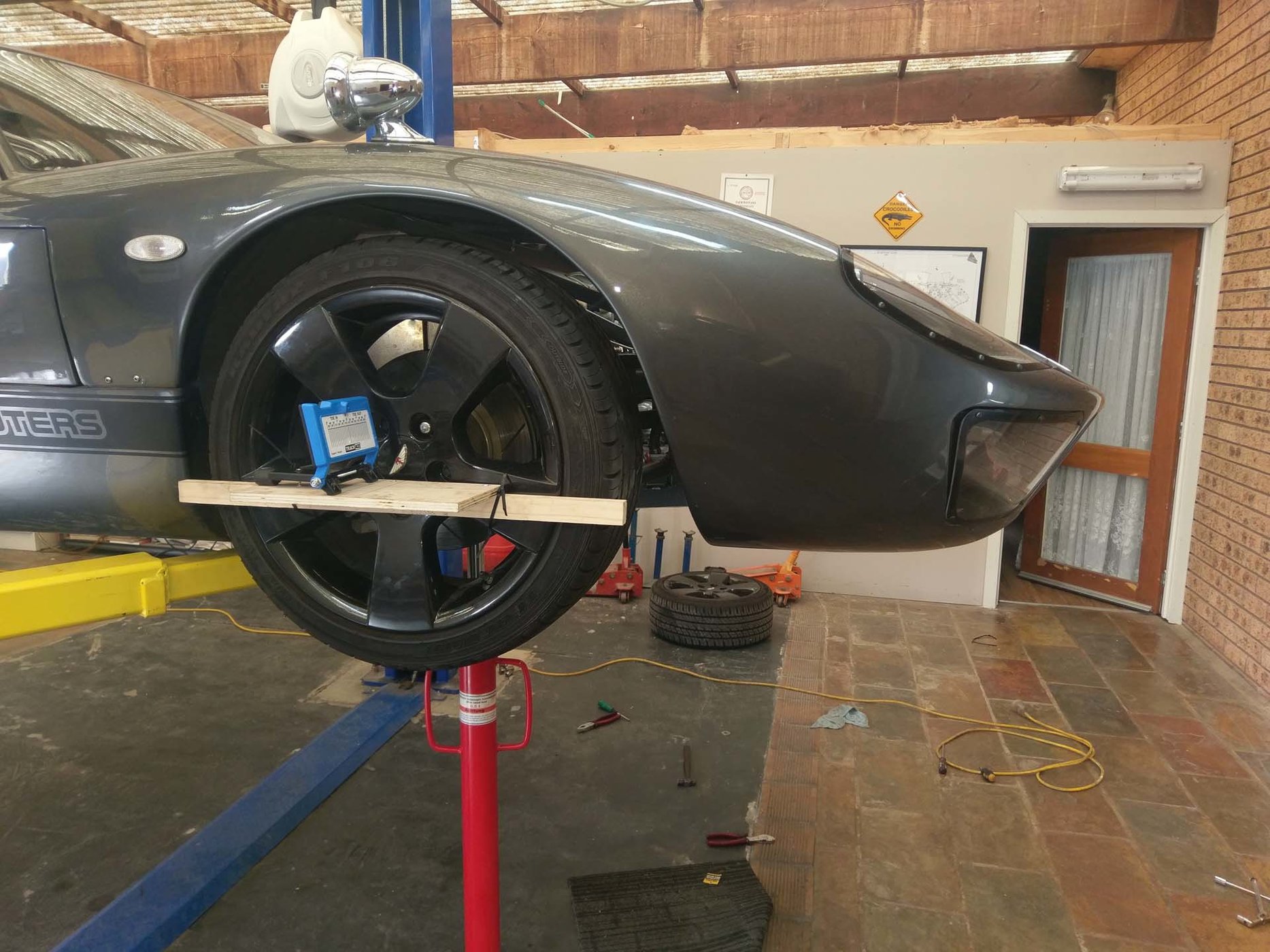

Hi I have been trying to get my GT40 to stop wandering and get rid of the bump steer at high speeds ,I watched this
and made one up myself and found I had over 15mm bump,I moved the rack up 25mm and got rid of it all,what a difference to drive.Such a simple thing to build with big results
Check bump steer

You don't have to make it that complicated.
If you shoot the laser 90deg out from the wheel onto a target (sheet of paper).
Draw a centre line on the paper ,pump the wheel up in the working range any deviation off the line is bumpsteer.
Adjust to the minimum amount of deviation.
