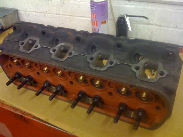

Please advise if you can recommend sources of data or original Ford part numbers to blue print a pair of C6FE heads.
These heads have 1.88"/1.625" valves and were formerly ported by Valley Head Services. Canoga Park, Calif.

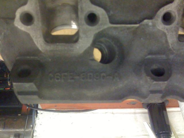

The part numbers on the castings read C6FE-6090-A, both on the fronts and in the top wells ?
I have considered using HiPo parts (C3OZ series) but would prefer original GT40 racing programme parts if these were ever made for these heads.
James, You must be quoting the numbers cast on the head. The numbers I gave you are the actual Ford p/n if you had to look for them in a Ford Parts Book.
( I have a Ford Muscle Series Books) which I found those from.

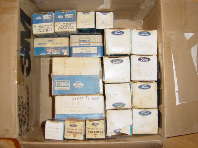

James, all the good 'oil' comes from NZ. Read on.
"LeMans" Camshaft p/n C7FE-6250-A ( I have one new still in carton)
Spring/Damper C3AZ-6513-B ( 390 GT)
Retainers C90Z-6514-D
Keepers ( Hardened) C9ZZ-6518-A
Pushrods " C9OZ-6565-F
Guide Plates C9OZ-6A564-B
Rocker Studs C3OZ-6A527-B
" Nuts C2DZ-6A529-A
Oil Deflector C9OZ-6524-B
Jam Nut 45218-S8
Rocker arm C2OZ-6564-A
Tappet C3OZ-6500-A
Jac Mac

Jac Mac,
Christmas has come early.
I received your complete set of parts today from JD Larson of All Classic Motors, USA. Well recommended.
Many thanks for your help in this.

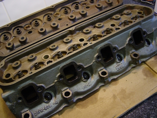

Came across a set of them myself today that were also stamped on rocker cover mating surface with "ported by Valley Head Services. Canoga Park, Calif" and also what the owner claims to be an original 4-bolt development block for 40s. An 'XE' I think he said, but it had machining for coopers rings and on original bores. One of only 4 made and only two now existing, or so he claimed.
Didn't Boss Mustangs use these heads too? and if so surely they are not too rare?

I think he might be of the impression that the block is a rare item, the heads were fairly common being fitted to most Hi-Po 289's which were OE on several Ford cars as well as an over counter option for others. De Tomaso Mangustas, most of the Cobra Small Blocks Incl coupes, Sunbeam Tigers etc etc. The engine guys used to grab the castings straight out of the sand molds & weld up the cresent shaped waterway on deck face to help with deck stability/head gasket reliability, in later years we used to 'post' them down thru three of the exh rocker studs ( you had to avoid the one above exh port crossover:)) and in four places on the deck surface just outside the gasket line.
Jimmy Mac, I have some reasonably good pics of the VHS head work being done if you want them scanned & sent.
C6FE heads were never installed on any normal production car by ford. They were used on FIA cobras, Daytona Coupes, R model Shelbys and Gt40 Competition Coupes. These are not 289 HP heads. All C6FE parts were classified 289 HD by ford and only used in select racing applications. Even Mk1 GT40 street cars had standard 289 HP engines. The intake port is better and the exhaust port is huge and high as compared to 289 HP heads. Some C6FE heads were raced with 2.02 intakes valves.
