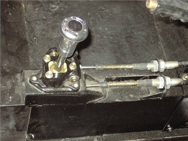

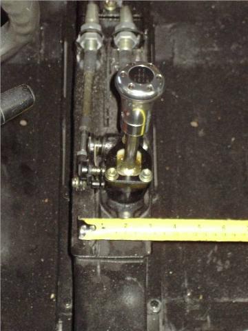

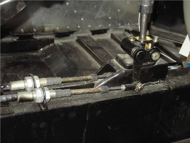

Yes, most, well at least a lot, of the GTD's that were sold in the USA had center shift LH drive. Lotus something or other shift parts. Very hard to find now-a-days. I would be interested in photos of a MR2 shifter and or one installed in a GTD.
Dimi Terleckyj
Here you go Howard
Toyota Tercel shifter one of the smallest shifter assemblies around.
This one is installed in my DRB #68.
Dimi
