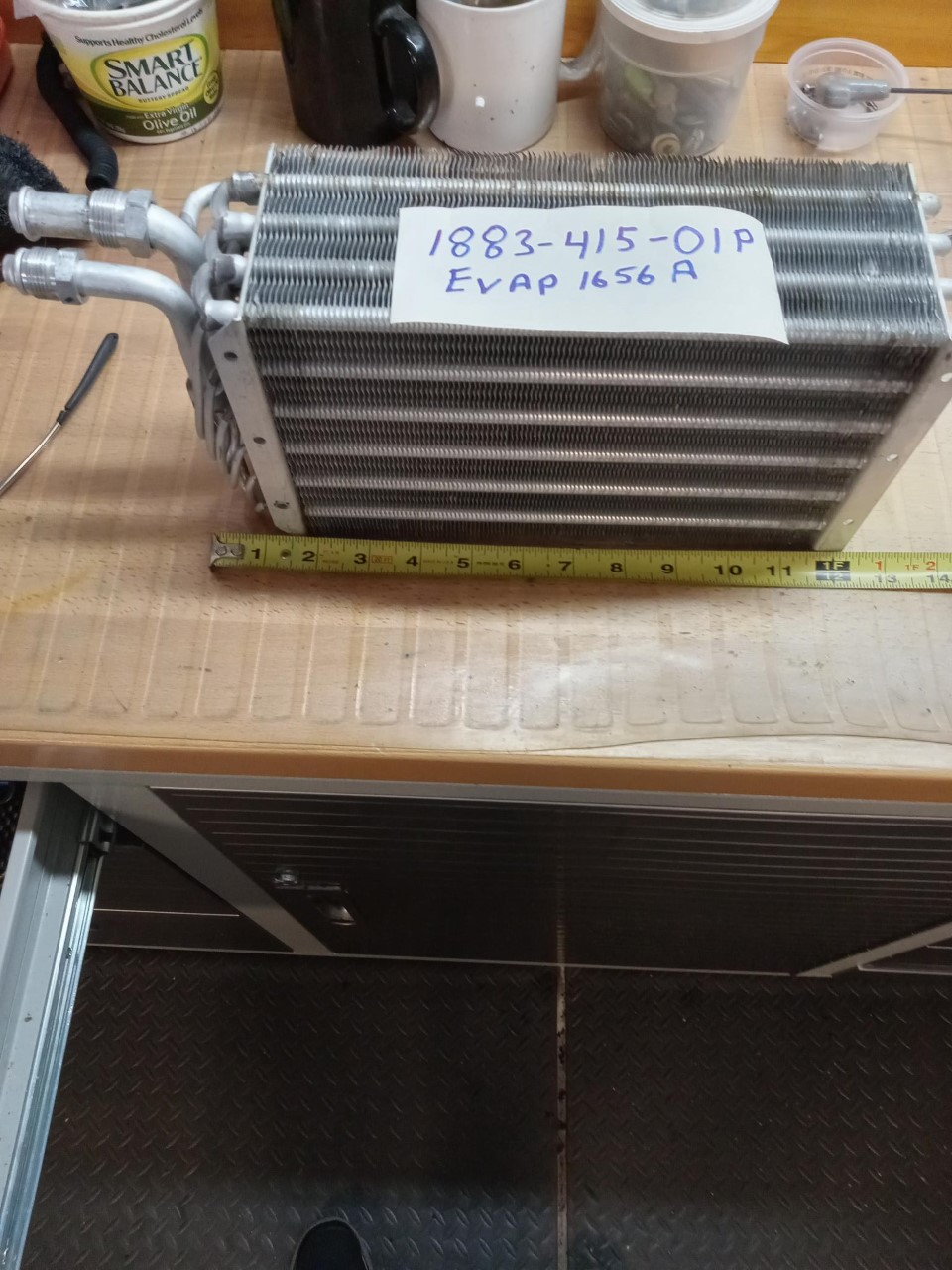

I NEED A EVAPORATOR COIL FOR MY CAV . I CAN NOT FIND ONE . ANY HELP WOULD BE APPRECIATED .
THANK YOU IN ADVANCE
WALT

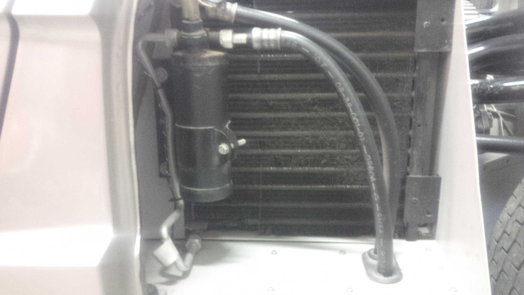

I've been looking for a compact condenser in the aftermarket with no success. Suits the left sill box location as per the original a/c equipped GT40s and first 100 CAV GTs.
It may an Asian or African market sub compact car or industrial air conditioner part but as I said no luck so far. We've had to go with front mounted condensers on new builds. Probably works better given the heat soak in the engine compartment.

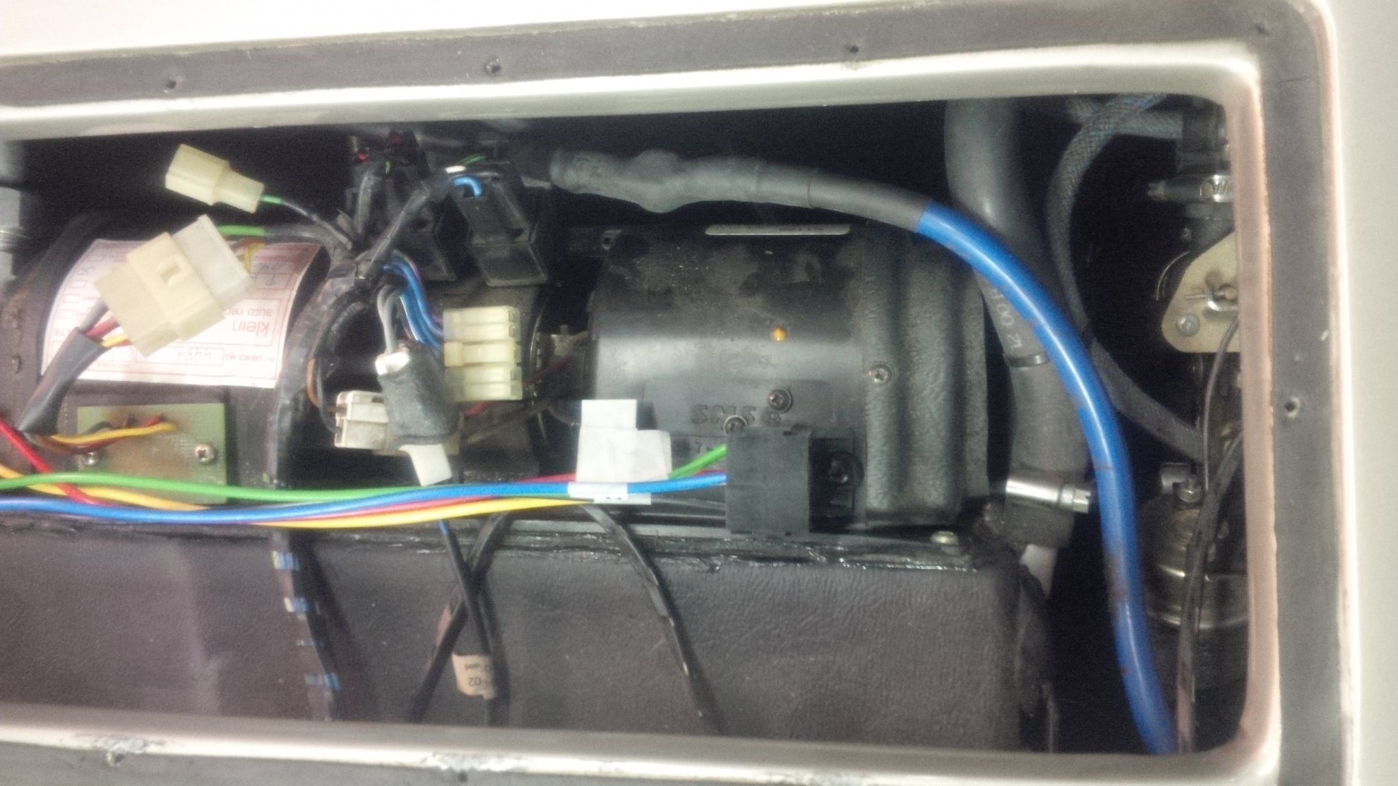

The Heater/AC unit was sourced from Rover I believe. First pic, just for reference, is the condenser unit on the CAV sill box. The second pic is the Heat A/C unit with dual fans. The unit itself is very close to the Vintage Air under dash universal kit unit. Can't say if the evaporator will cross over. Both the OEM Rover and the Vintage Air units have vacuum formed cases.
