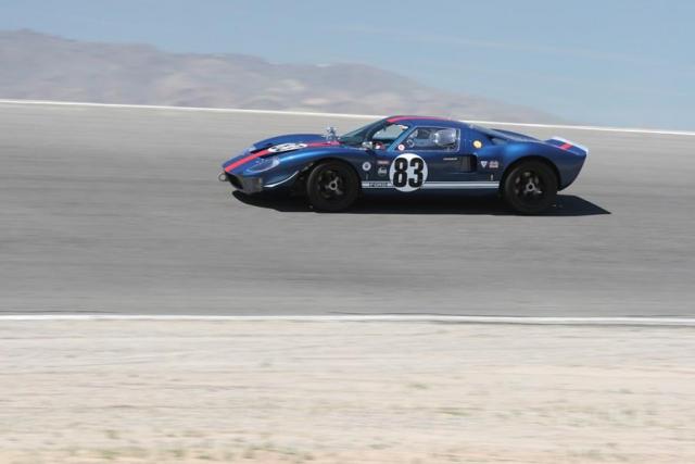

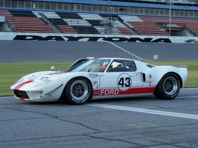

Mine are made of steel and painted with silver/aluminum header paint. I have a subconscious feeling they do a little at about 100 mph. At least I think they put a little down force on the front. A 110 MPH corner at my favorite track SEAMS better.

Cool pics Howard, had to download them, thanks. You probabably are getting some downforce from the canards along with the areodynamic pressure centre moving forward a bit. So it's partly downforce (or reduced lift) and areo balance favouring the front somewhat more. And they look fabulous too! Cheers
