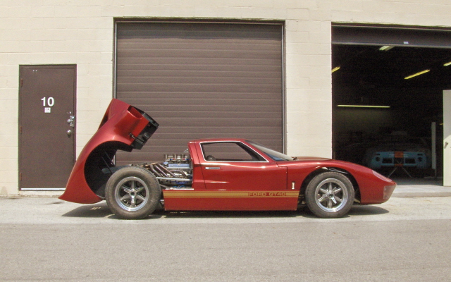

Here's a pic of our latest escapee, with the Ford Racing 347/ Z Heads with Webers, CAV Headers modified to fit. It's a land based missle!
