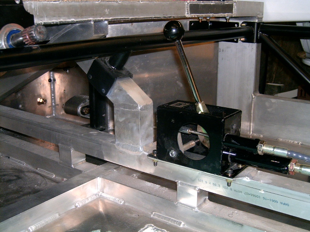

This may fall into "Gee-wiz" but, what grade aluminum is the SLC Chassis. Yes, I could look at mine,, if I wasn't 8000 miles away in the middle east...lol.
Looks like its 6061 T6
There goes concours! They welded the beam in upside down, how will the judges be able to look past such horror and lack of detail.
JK of course
