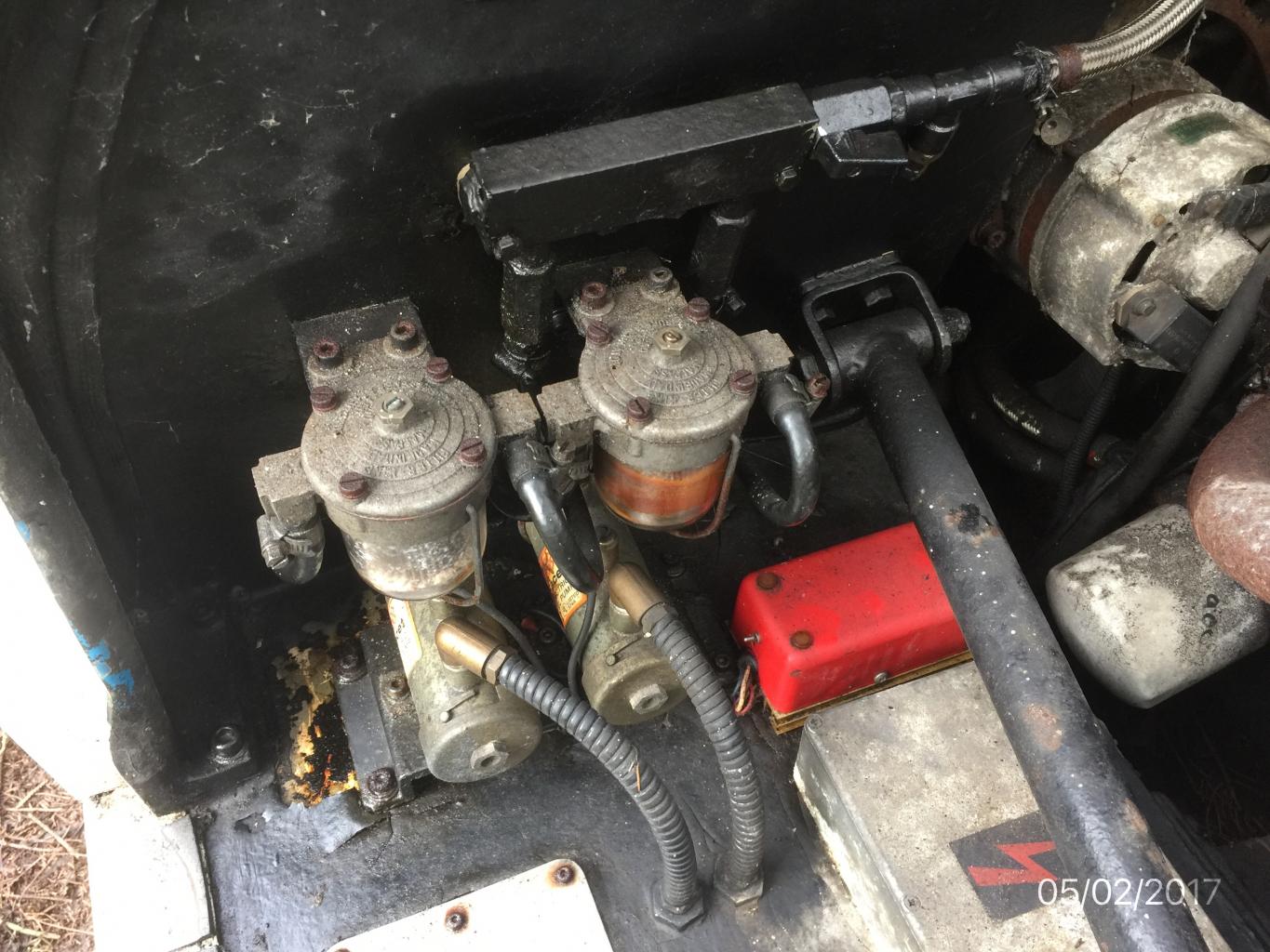

Once I start the restoration of my GTD I'm going to need to give the fuel tanks some serious de-gunging
If you take a look at the fuel filters you'll see what I'll be dealing with!
Any suggestions? It'll need to be pretty strong stuff.....

Are they bladder tanks? If so they probably should be replaced, if metal tanks, you may wish to pull them out, get them cleaned with hot solvent and coated internally with a proper sealant.

If the tanks are steel?. the rust in the filter I'm thinking they are.
You would be better off to have them stripped and plated.
The rust will likely be on the bottom, you can fill the tank with white vinegar and neutralize with bicarb soda afterward.
