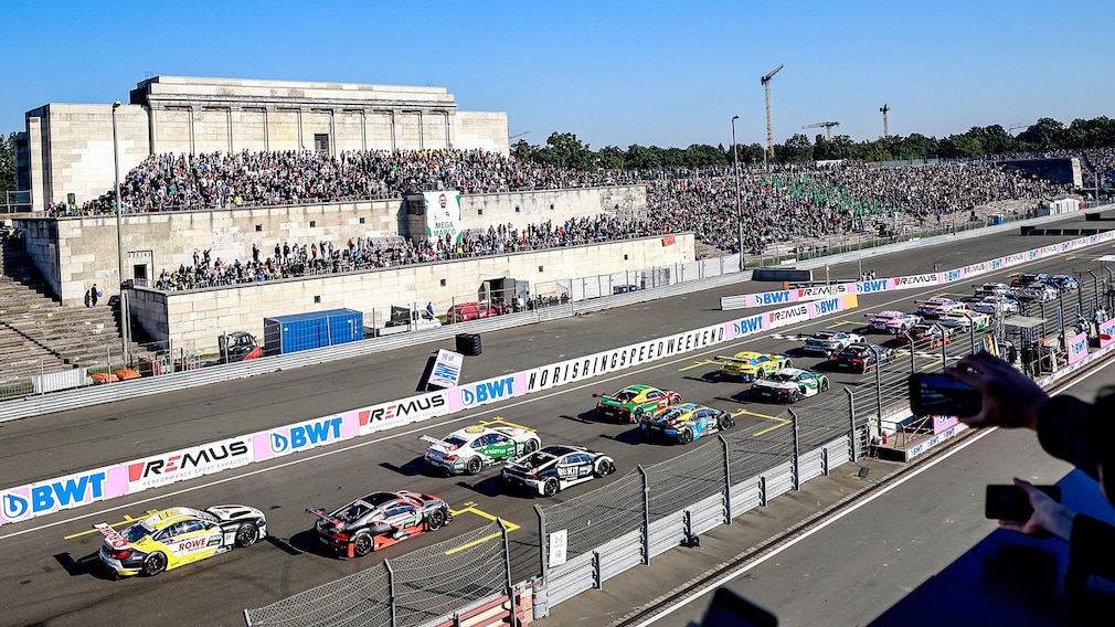

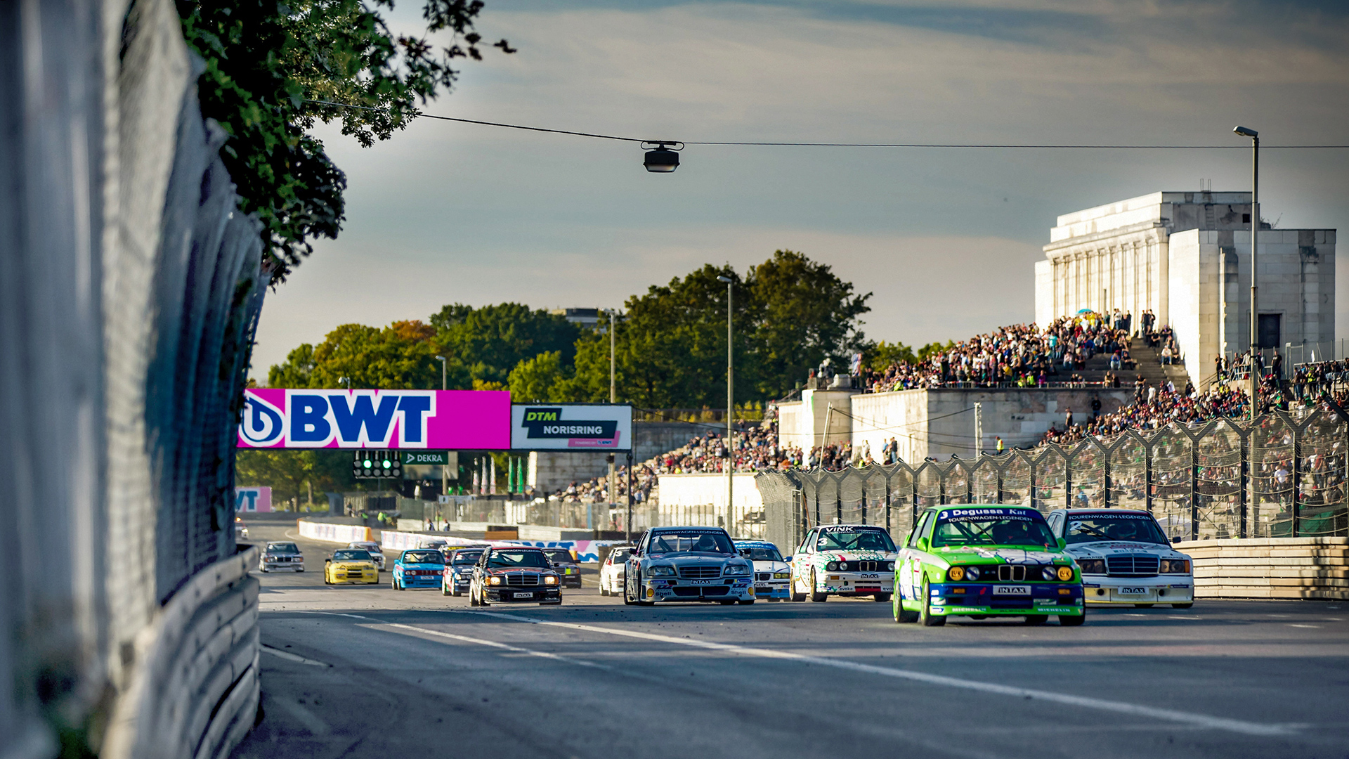

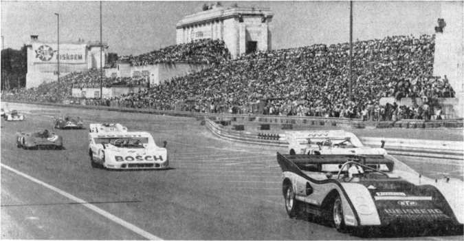

If thats the case, i dont think the 65 race was at the norsring.
It looks more like it was at the Nürburgring

I don't think the 65 race was at the Norsing, Circuit looks too small and in the wrong location compared to photos of the area.

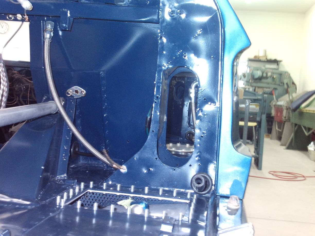

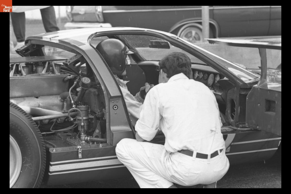

Does anyone know what the round fitting in the B pillar was for?
The mechanics could do the oil level check and refill from the filler breather just behind the B pillar, so it’s not engine oil. Brake and clutch fluid would have been up the front in the usual place (have seen photos of 103 to confirm).
Could it be a valve to allow refilling of the cooling system?
The header tank is right behind there?

More time spent researching, and the answer was here in another thread all along.
This photo from @Mark Clapp shows the connection and the route of the hose during restoration. You can see the hole in the B pillar, a 90° fitting inside the duct, and a hose that runs up to where the header tank would be. Also note the perforated lightweight bulkheads in the ribs that made up the side sill structure as well as the revisions and additions to the upper rear radius rod towers.

@Mark Clapp thanks for sharing the photo.
