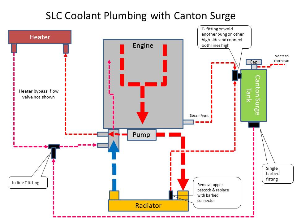

One last bother (I hope). I took what you said and combined with the WIKI, drew the attached diagram. Do you mind giving it the once over? Did I capture it correctly? :stunned:
I work better with pictures...go figure. :thumbsup:

You nailed it Dan. Nice diagram. Just remember that when the heater flow control valve is installed it should be to the left side of the 3/4" heater hose tee.

The only issue I see relates to the high/low comment you were confused about. I too was confused at first because I read it as upper and lower (location) instead of High pressure side vs low pressure side. I had to read it twice then I got it.
Anyway...you still have it on the high pressure side. Maybe that's because you only have one petcock and that's where it is. Might have missed that.
Is the vapor vent from the radiator necessary? Most production cars don't have them.
I'd guess that higher operating temperature make them more important as well since you could generate/carry steam outside of the heads as well. Most production cars won't be ran at such high temps.

High pressure versus high location......makes sense now...but
The radiator I have does have a second petcock which is in the opposite corner (on the return to engine line) lowest physical location (drain petcock?). In review of the build manual picture below, it looks like the radiator vent line is the same as the upper petcock on this SLC radiator (is RED high pressure, or hot fluid?).
I assume the intent of the vent lines is to help eliminate trapped air/steam. Not sure but I thought the engine steam vent is considered part of the high pressure side of the plumbing like the high side of the radiator, but to your point maybe not.
In the grand scheme of things when/where does the flow transition from high pressure to low pressure?
How would you change this up?
The high pressure side correlates with the red side and low pressure side with the blue side and doesn't necessarily have to do with the temperature in this cause but rather (or mostly) the proximity to the pump outlet. The vent line are also "low" pressure. The closer to the pressure created by the pump the higher the likelihood that fluid will want to escape to low pressure. So in theory when the fluid enters the radiator tank on the hot side it may went to be pulled into the vent line instead of traveling through the radiator. There is less of a chance of this on the cold side tank. In practice I'm not sure how often that happens. In the SLC the coolant has a long path to travel before entering the radiator and could lessen the affect. If I had petcocks on top left vs bottom right, I probably wouldn't worry about it, I just happen to have petckock top left and top right.
