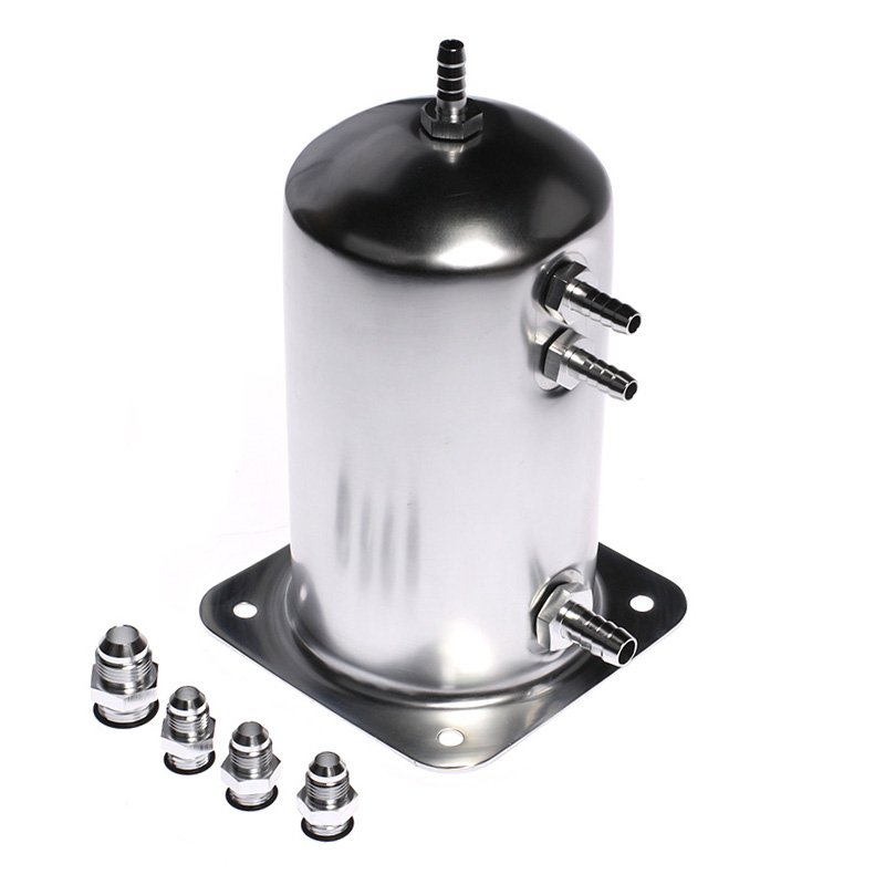

I was thinking of using a recovery tank to complement the pressurized expansion tank with expanding fluid.
My ideas are revolving around the standing cylindrical type. (See attached picture)
Would it be historical accurate or atleast plausible compared to an original GT40 or racecar of the 60s?
Placement is to be around the same area as the oil coolers was on some original cars.

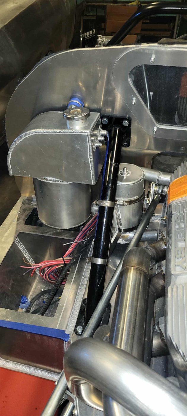

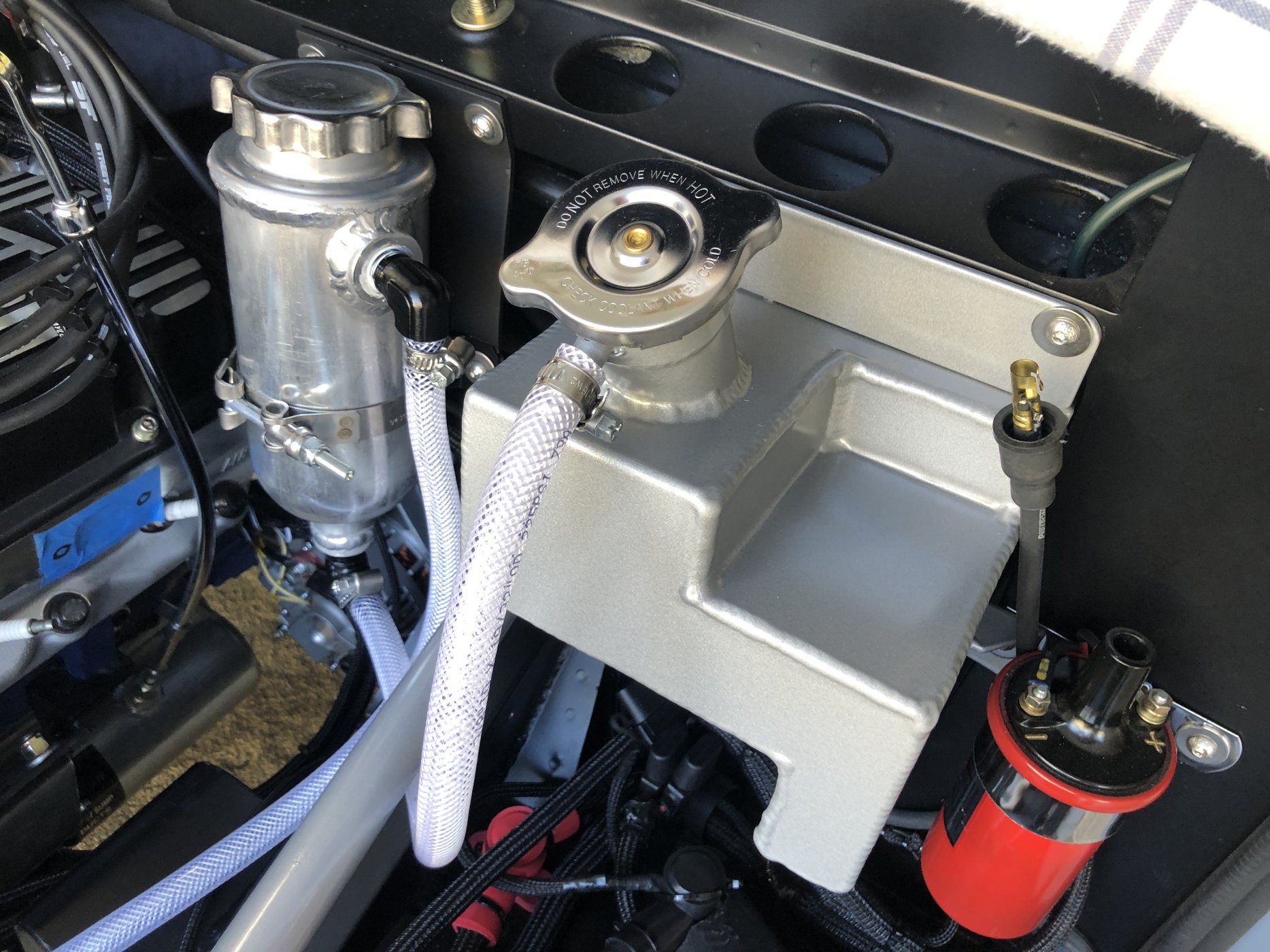

I used this Canton on my SPF. The SPF radiator cap is set up to simply piss coolant on the ground when its expands past the cap which I did not like. Even my 72 El Camino has a recovery tank. I also replaced the SPF cap with a 16 lb. non-vented MotoRad (which used to be STANT). I fill my header tank to the top. You don't want a gap of air there. So far this is working as I expected if would. I ran the recovery overflow out the back of the car connected to the lower subframe.

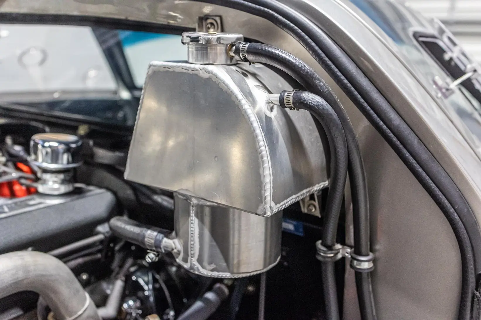

Looks nice Randy but will it fit as high as it needs to be?
My guess too wide to allow the rear clip to close hence the one above with a reduced height side
Ian, I might have to cut away the top corner of the recovery tank. Before I buy, I will make a cardboard mockup.
