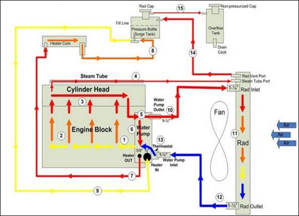

In review of my C6 Corvette cooling system (pic 1, heater connection is simplified), I note that a line from the surge tank is attached to the radiator and the steam port from my LS2. I also note from the build manual a similar setup (pic 2).
The RCR provided radiator has two petcock valves but no place to connect a line from the surge tank like both the Corvette and build manual drawings. Also the Corvette does not have an overflow bottle but simply dumps any lost fluid overboard. Since I am not going to race this car, compliance with a sanctioning body is not an issue, so I will use one of the RCR provided surge tank ports as the overflow port without a pickup bottle (for now anyway). I presume that the RCR tank has a pickup built in to allow for expansion/contraction of fluids (But not sure which port).
The question now remains, where will the second small port on the surge tank be connected? Is it only to the engine steam port, by passing a connection to the radiator?

I removed the top petcock from the radiator and replaced it with a hose barb, then ran a line from one of the small barbs on the coolant tank to the radiator. I connected the steam tube to the other small barb on the coolant tank.

The stock Dorman tank has two hose barbs at the top. One is for the radiator and the other for the engine steam ports as Pete said. You cannot use one of them as an outlet for an overflow tank. The reason being as the overflow tank is open to atmosphere. If you connect it as you describe your coolant system will not be pressurized.
An overflow must be connected at the rad cap area. The hose barb would attach at the neck of the cap mount (after the cap seal). This is not possible with the plastic Dorman tank.

So based on pete's mod, using the supplied surge tank, the system is completely closed with no overflow and under constant pressure. The Dorman is set for 16 PSI and would boil over the cap if it got too hot.
The Dorman tank would need to be changed out to include an overflow tank....correct?

Yes if you wanted to capture any fluid that escaped. The Dorman tank has no provisions for that.
Does the Corvette have a pressure cap at the top of the rad? If so than your corvette surge tank is actually a overflow tank.

Did you adapt the high side petcock valve to connect to the overflow tank like Pete did? Is there another way to connect the surge tank back into the radiator, or is it even necessary? Will fluid get sucked back into the system via the engine vent tube
