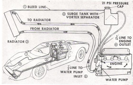

I am getting closer to starting my motor and need to set up the cooling system. I have poked around for the proper way to do things and I know there must be a thread, but I couldn't find it (easily enough, at least). I have scoured a few build logs (Tom, Chuck) for pics of cooling systems but haven't found detailed info or pics.
The first of my questions is what comprises a proper cooling system on a 40?
I am thinking the answer is all the requisite gear to the rad and back as well as to the heater, but presumably somewhere in there also needs to be an expansion tank as well as an overflow/catch tank.
I am familiar with the components as generically used on "normal" installations and I can conceptually place or duplicate those components in the 40, but is there anything different needed? I was thinking of an expansion tank near the firewall (should be the highest thing in the system as well), a catch can conveniently located somewhere else with a feed in and out of the bottom, a small diameter vent line from the top of the rad running back to the expansion tank, am I missing anything else? Seems too simple... Thoughts?
