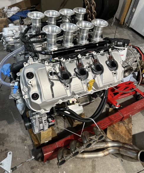

I discovered a gem that I need to share with GT40 builders that are using a 5.0L Coyote engines. Ford Performance makes a sells a die cast aluminum cam covers for around $300 per pair. Have been considering the aftermarket billet options to help mitigate heat from bundle of snakes, but they can cost thousands! I was about to pull the trigger on some heat shielding to better protect the stock nylon covers, until I found these. Anyway received yesterday, they are nice pieces, direct replacement, includes seals, fasteners and studs for coil covers.
