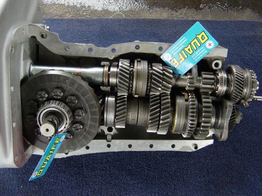

You all need to speak to Chris Coles nicely...
Ohhhh, so then that would be $10000 for the input shaft alone. You can buy TO bearings from him for around $90 /ubbthreads/images/graemlins/wink.gif
Greetings Faili /ubbthreads/images/graemlins/cool.gif
As I recall - Chris is doing the 'one-piece' shaft conversions for about £1750 (NO VAT) + the cost of ATB diff if required. Details in next club mag...
