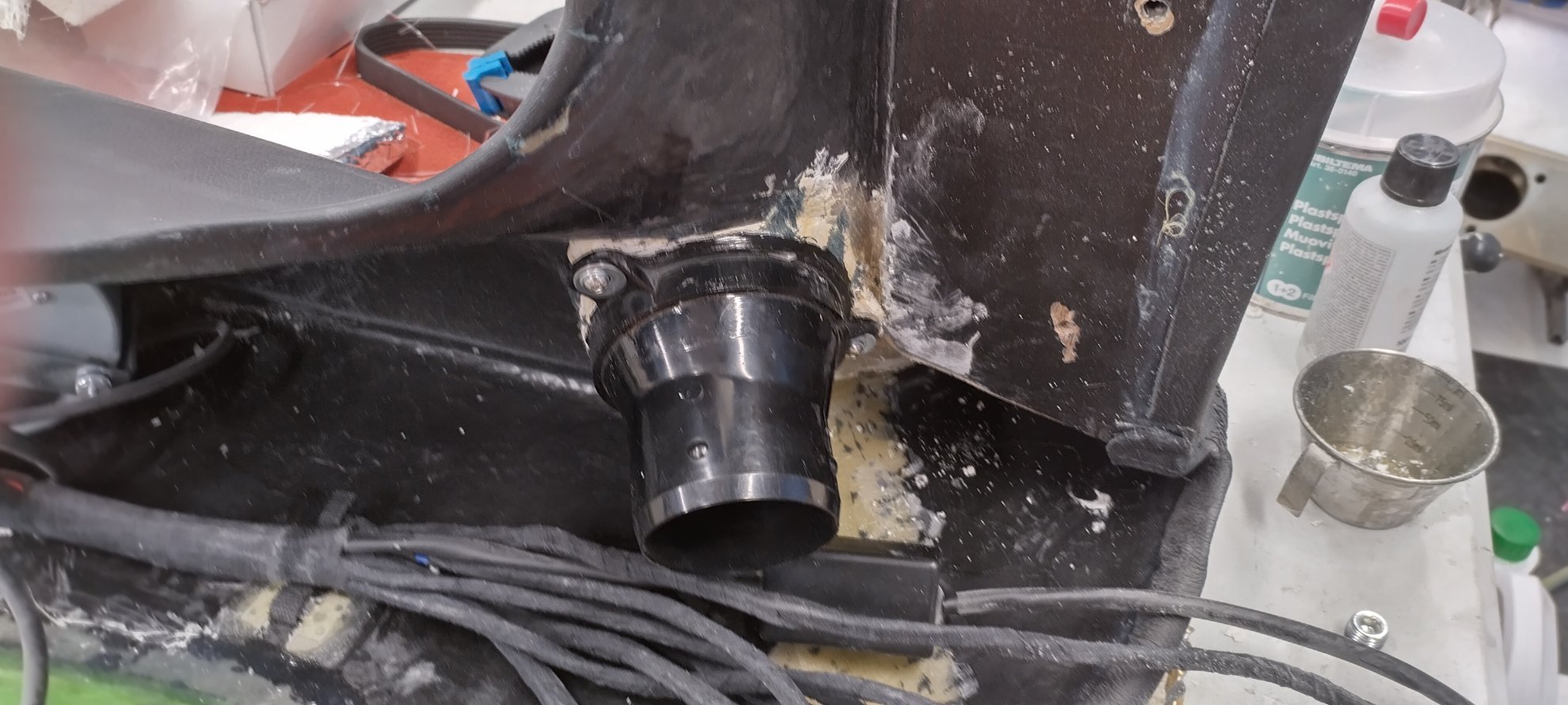

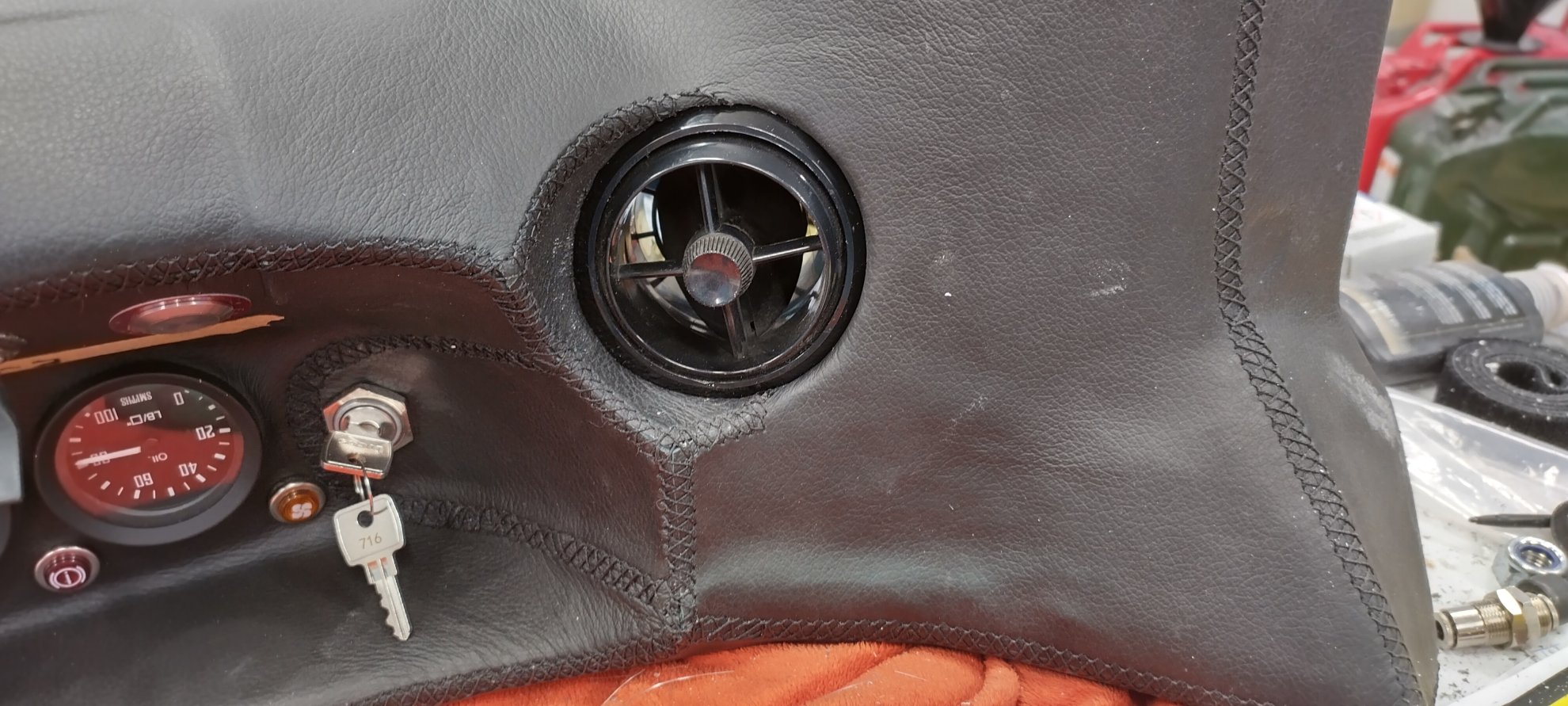

I'll add a pic of mine for starters.

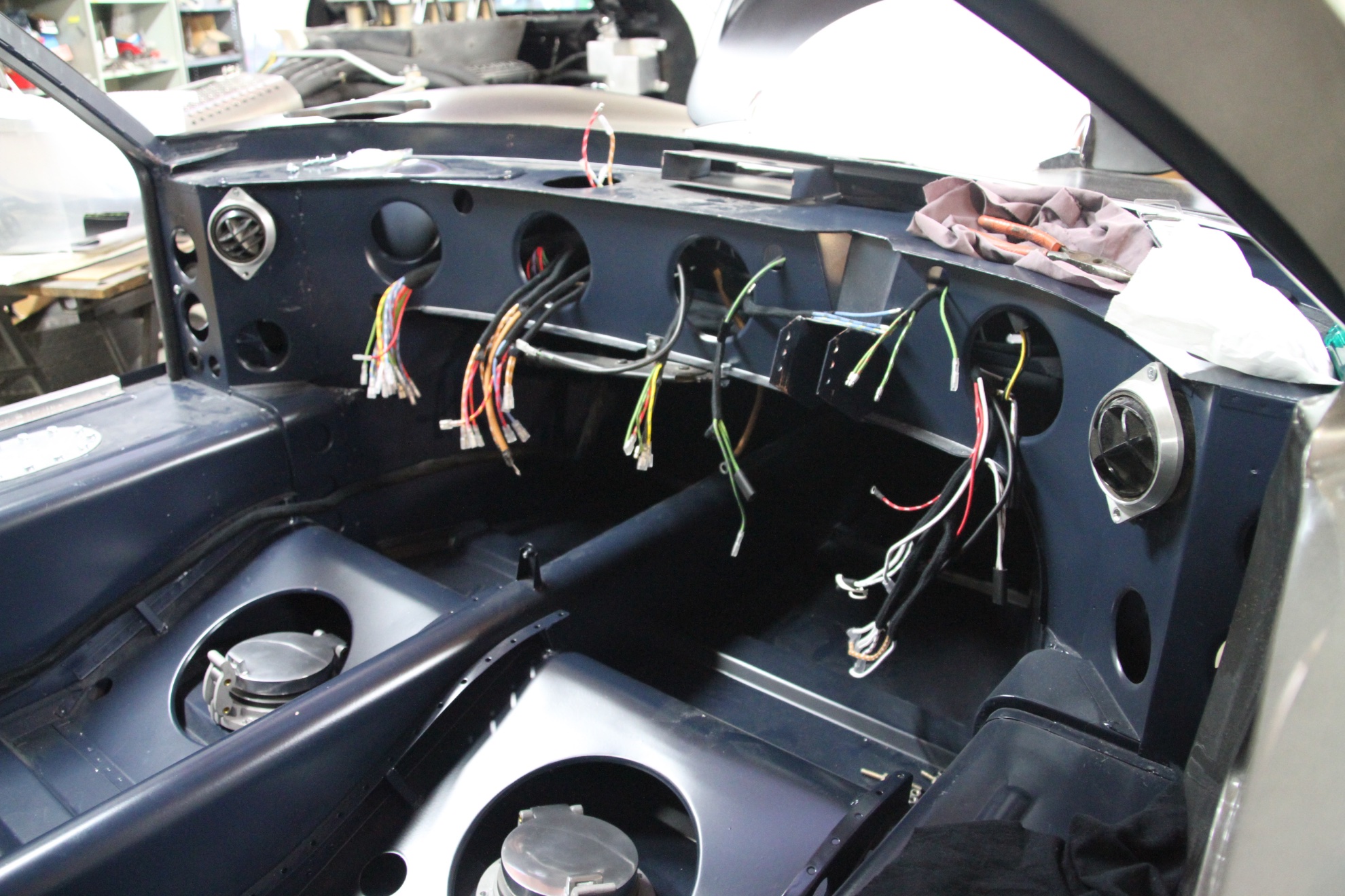

The originals had them bolted to the base of the A pillars/chassis underneath and the dash just pushes up to meet them.
If you are using the original style Mk IV Zephyr or even slightly latter Cortina/Falcon/Escort units then you could replicate this mounting. I guess you also need to consider how they are plumbed and how you will connect all the plumbing. Do you want to be able to do this before or after the dash and windscreen goes in?
Brian Stewart
Picture sowing the original style vents and their retaining rings. Dash simply fits over the front and doesn't actually hold the vents in place.
