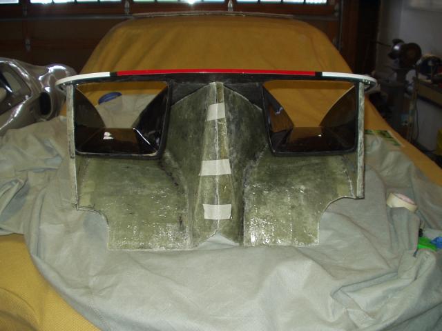

Deep twin nostril conversion

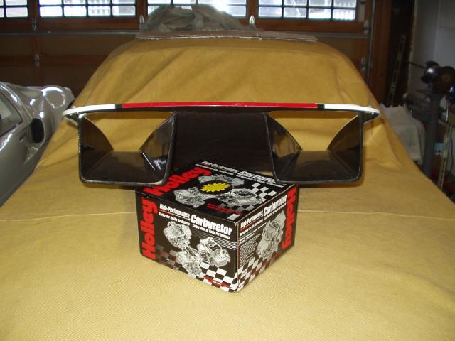

Fearing that I would not be able to push enough air through my stock GTD twin hatch to cool the rad, I had Bill Hough, "The Master of Fiberglass" cast an original twin deep nostril piece to graft on to my own. It's a real nice nice piece of work and looks like it will have maybe 6 times the surface area to allow more air to come through. As you can see from the picture , the hatch will now be open to the bottom of the rad and is going to look real sharp. If I have time I'll cut the bottom from my hatch and graft Bill's on this weekend.

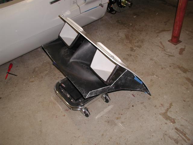

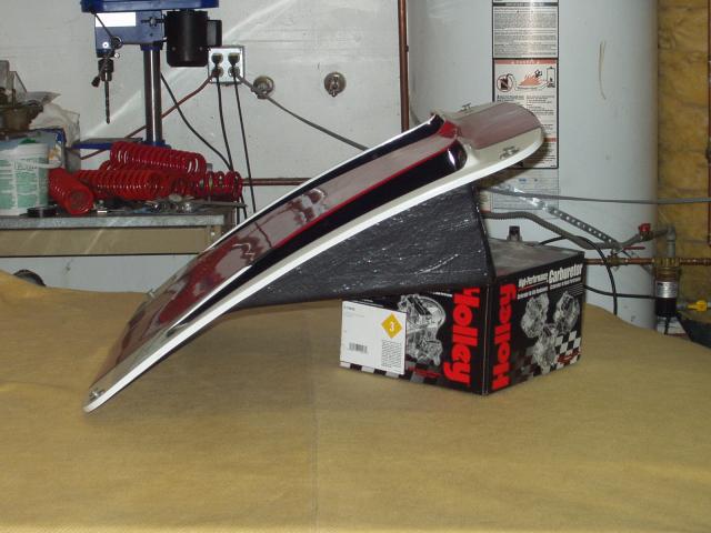

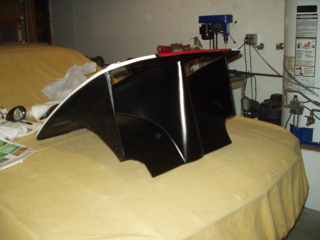

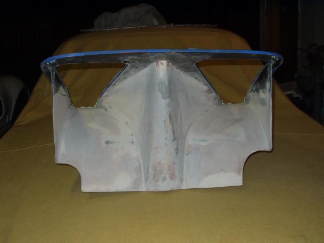

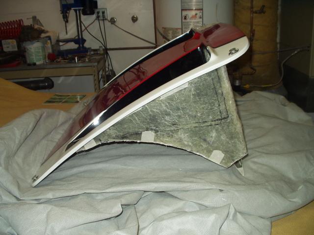

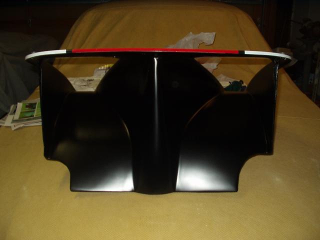

I did this myself, turned out real nice, Bud Jones loaned me his mould and I modified it from there, here are some pics of the process. I had some professional help both in the construction (I went to a sailboat guy locally) who helped with the structual foam which was used, we then cut the original at the corners and splayed it out to meet the new form, an auto body shop did the final paint with a semi flat paint .
My thought was it was easier and less expensive than a whole new piece, especially in matching 17 year old paint, looking back on it I dont know if that is true.
