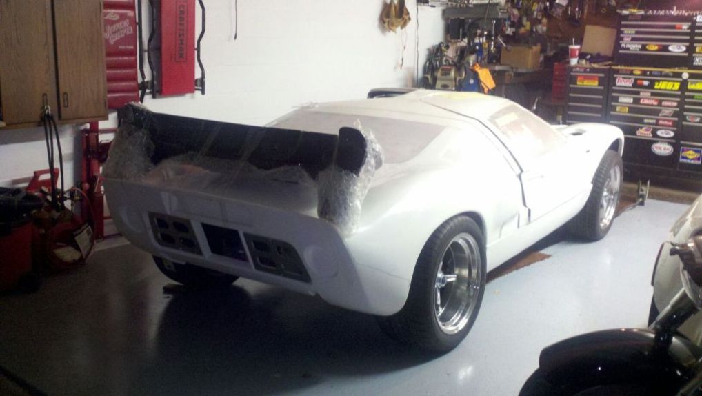

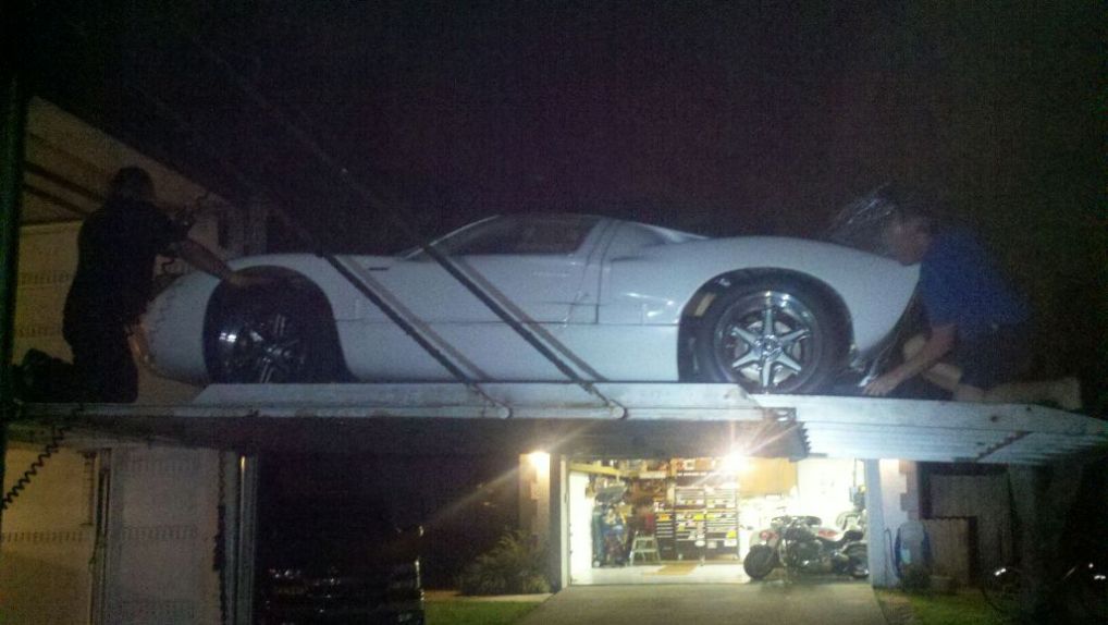

The car arrived March 10 as I was in Daytona for bike week my brother and a buddy moved it into the garage for me, then sent pic's

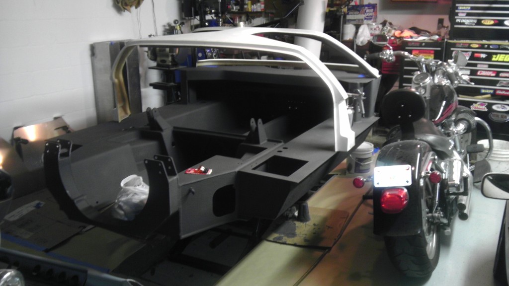

The dash is APITA, work going slow there. After stripping the chassie down I mounted the brake/clutch reservoir's, centered the stering colum, and wrapped the coolant lines then reinstalled in the spine. I Lizzard skined the chassie to keep some of the noise down I'm hope it works better than dyna mat that I put in the Lotus. I got the suspension rods back from the powder coater, and the billet suspension parts back from the anodizer. I now have a rolling chassie again.

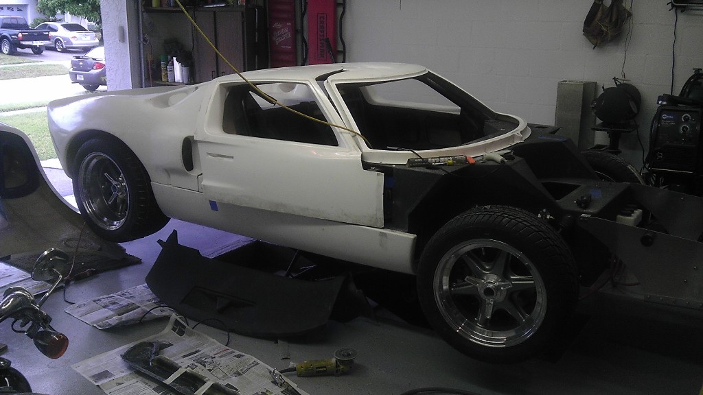

Body alignment
After reading all the issues with everyone having alignment issue's like the dash for me I just half way mounted the doors, front clip, spider and rear clip. Then used my motorcycle tie downs to hold the rear clip against the spider this leaves everything in a fluid state. Then using plenty of gorilla duct tape to hold everything in place I marked the spider rear location and tightened the rear clip hindges. I half way aligned the doors and front clip. I removed the body made a permanate mounting for the spider then reassembled the body and once again used tie down to secure the rear clip to the roll cage to reset the rear hindges. I thought this would take two weeks but only took two days.
