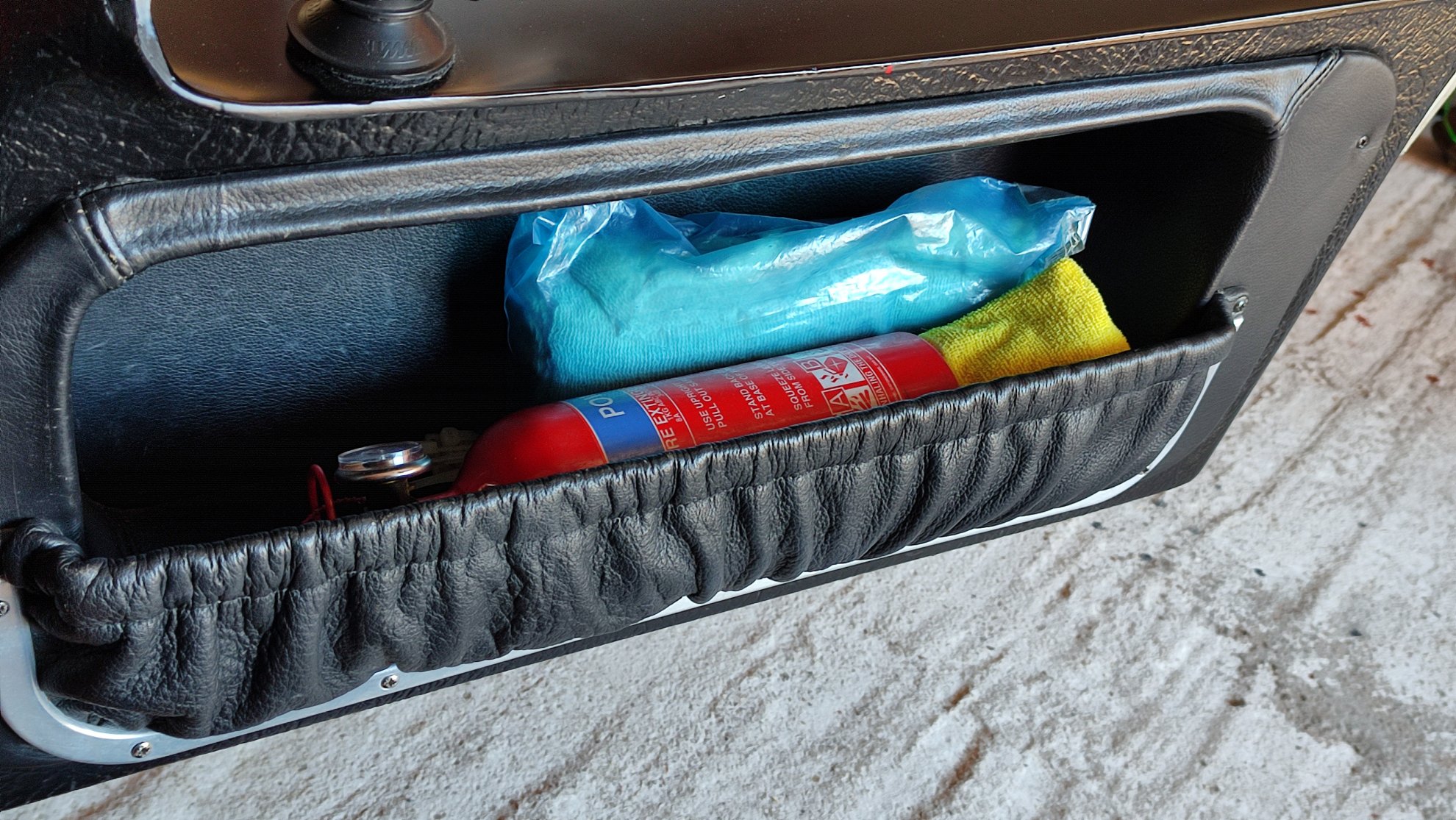

Leather door pockets. Attached to aluminium frame. Can use the frame as a handle for door closing.Holds lots of stuff, Very useful as storage in a 40 is very limited.

Thanks Mike, thats a neat solution. I hadn't considered the frame idea, but I had thought that whatever I do, someone will likely try to use it as a door handle!
I quite fancied the net idea as I dont have any other leather trim in the car (apart from the seats), but that looks good.
How did you manufacture the lower frame that is profiled for the door pocket shape?

They remind me of the early MK1 Mini Cooper door pockets which adds a little more storage due to their protruding shape. Nicely done.
Devin

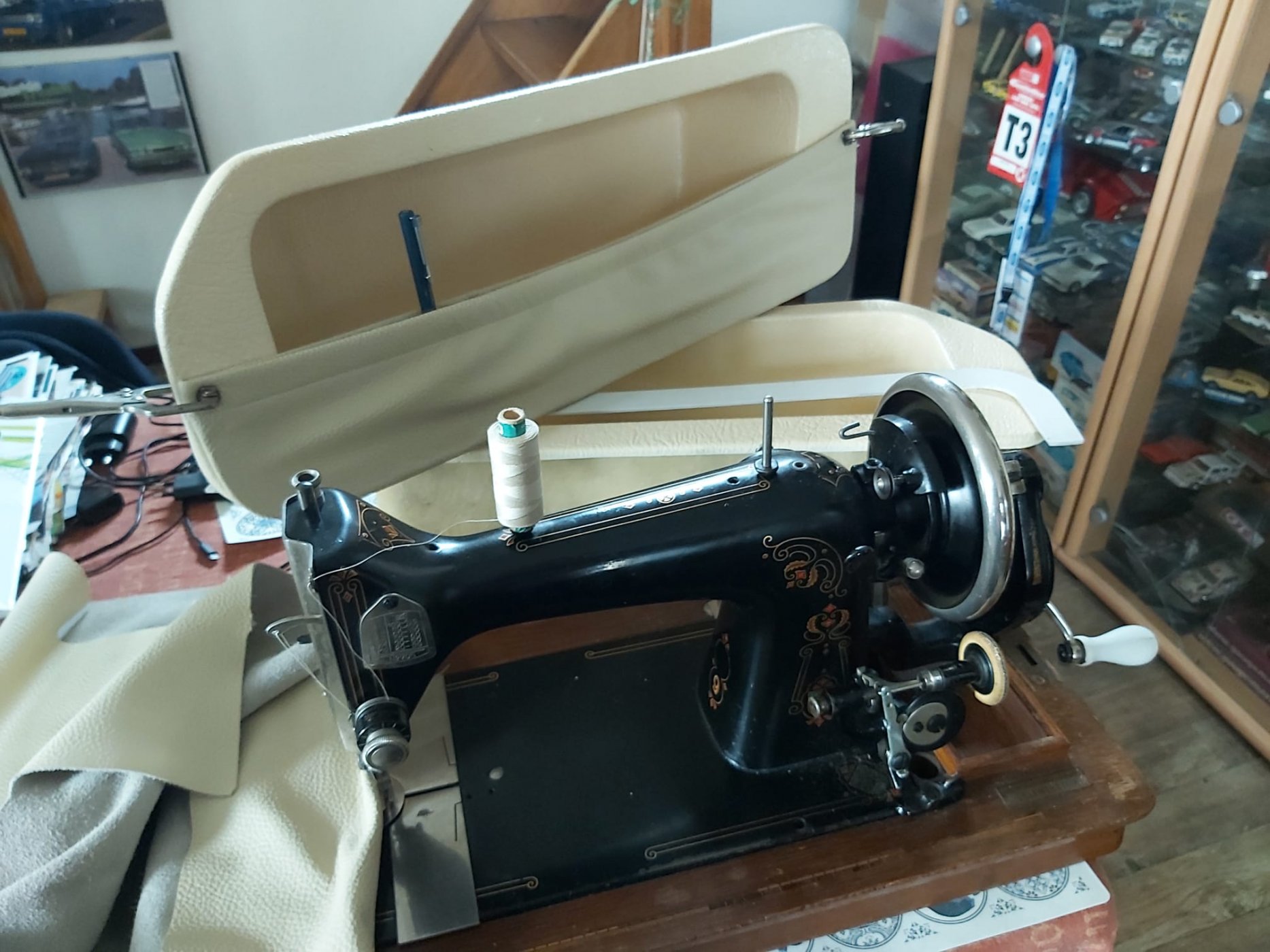

Two layers of leather sewed along a plastic strip with a few bolts between to bolt it onto the door pockets.
There's a pen sitting between the two layers. Two layers can sit my phone or papers between.

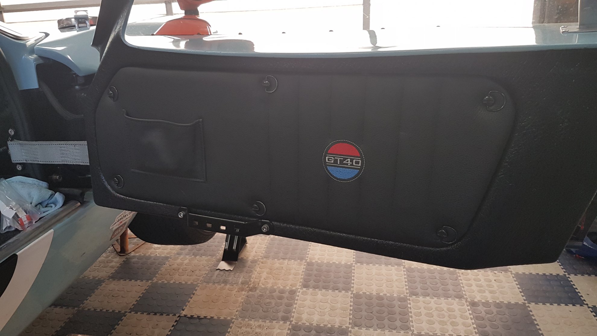

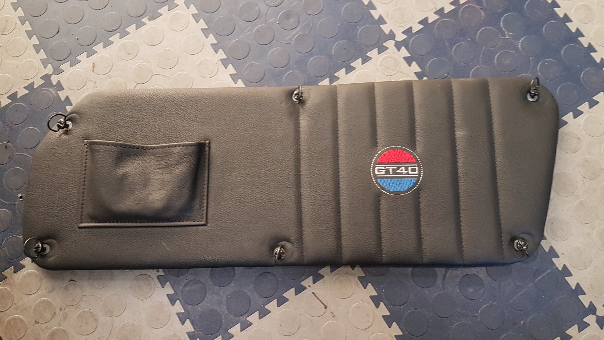

I removed the pockets and made up some door cards which are covered in leather to match the seats in my SGT. They fix with 6 dzus fasteners with D rings.
Allows for luggage to be stored, and hidden.

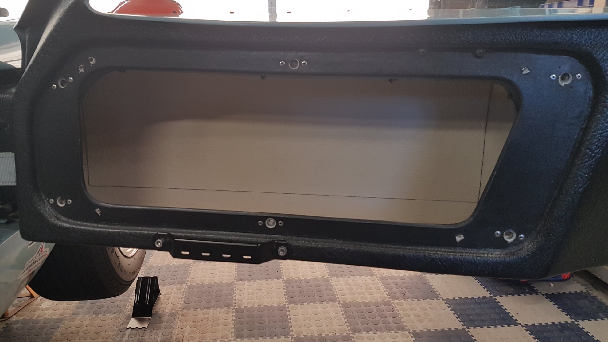

I carpeted the inside of the doors
Added a door cards with c
The whole door becomes storage
make sure the hinges are securely glassed in
