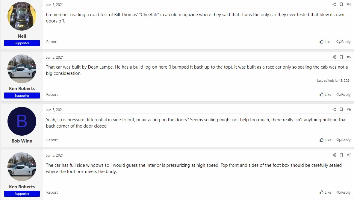

I remember reading a road test of Bill Thomas' "Cheetah" in an old magazine where they said that it was the only car they ever tested that blew its own doors off.
Ken Roberts
That car was built by Dean Lampe. He has a build log on here (I bumped it back up to the top). It was built as a race car only so sealing the cab was not a big consideration.
Yeah, so is pressure differential in side to out, or air acting on the doors? Seems sealing might not help too much, there really isn't anything holding that back corner of the door closed
Ken Roberts
The car has full side windows so I would guess the interior is pressurizing at high speed. Top front and sides of the foot box should be carefully sealed where the foot box meets the body.

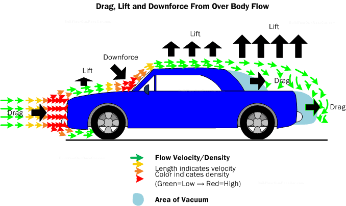

This is the same problem 40s have, air rushing over the screen creates a low pressure area above the door tops which causes lift.
On a normal car with standard roof you'd never notice it. Simply lower pressure above the door than below it.

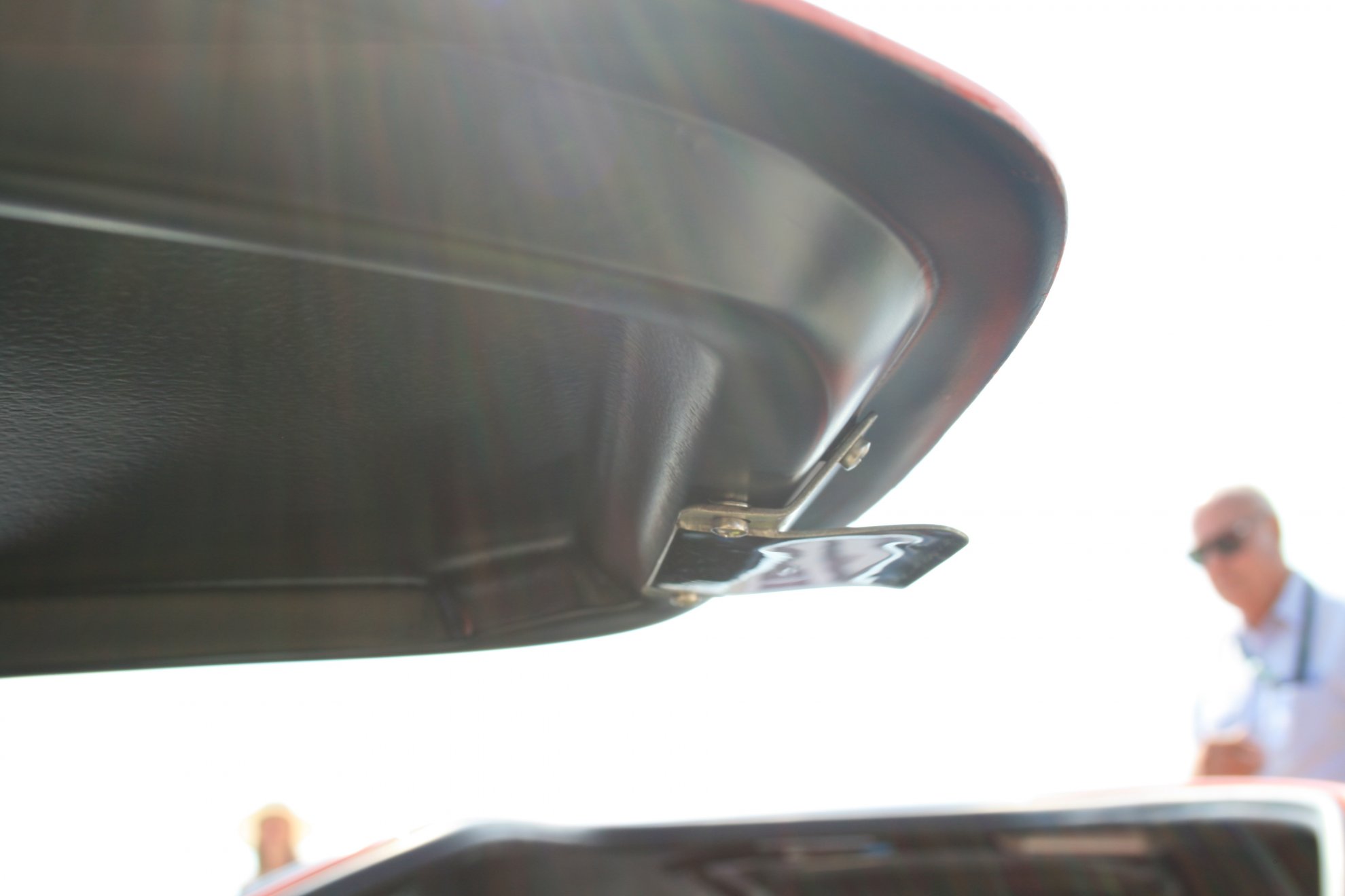

You guys aren't dealing with high pressure in the car, you are dealing with Bernoulli's principle. The high speed air over the car is causing a negative pressure on that wide upper part of the door, sucking it upwards. If it's not cracking the paintwork, I wouldn't worry about it...does it even happen at less than 120mph? To fix this, you need to make the door part of the roof, like the tab modification posted above, or suck the interior of the car down to vacuum... which may kill the occupants.
Those bolt-on tabs look rigged, even if they are effective. If it's a race car NBD, but if someone's going for a finished street car look those tabs are ugly. Anyone tried something else like a hidden fixed pin/hole or a tab/slot on the edge of the door/body that meet at that corner when the door is closed to keep it from lifting? I don't have the car yet to answer my own question, but is there any way to stiffen that part of the upper rear portion of the door so it doesn't flex so much?
