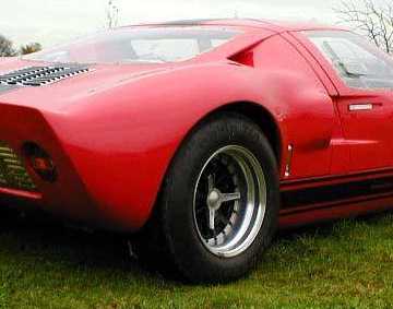

here are the notes I made regarding my leakingRHS. You will see that I moved the wheel out 4mm, with my 255/60/15 tyres they are still within the wheel arch at the top. The way the wheel arch curves inwards as it goes down, a fair bit of tyre shows outside the arch once you get toward the wheel centre anyway, so the 4mm didn't make any difference for me see photo.
