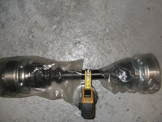

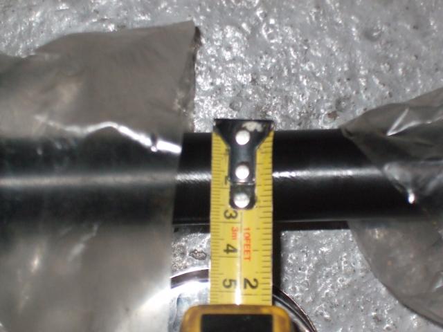

Pictures of Southern GT drive shafts which may be useful.
