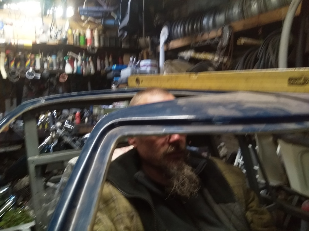

Whats common drop size for a dropped floor tray. I need to build one.
I have an issue a Gurney bubble won't solve..
So I like to know what a common drop would be.
Got a sheetpanel floor now and would like to upgrade to alluminium. What thickness should I use.

It probably will be a combination of dropping the floor and bubble on top.
First thing to tackle is my knees get stuck under the dash meaning I can not move my feet from pedal to pedal and I can not push the brake.

Next thing is my head.
Another thing is ground clearance, thats why I asked everybody.
I need 3.5cm floordrop atleast, so the all suggested 1½in which is about 4cm floor drop should still work OK with ground clearance.
