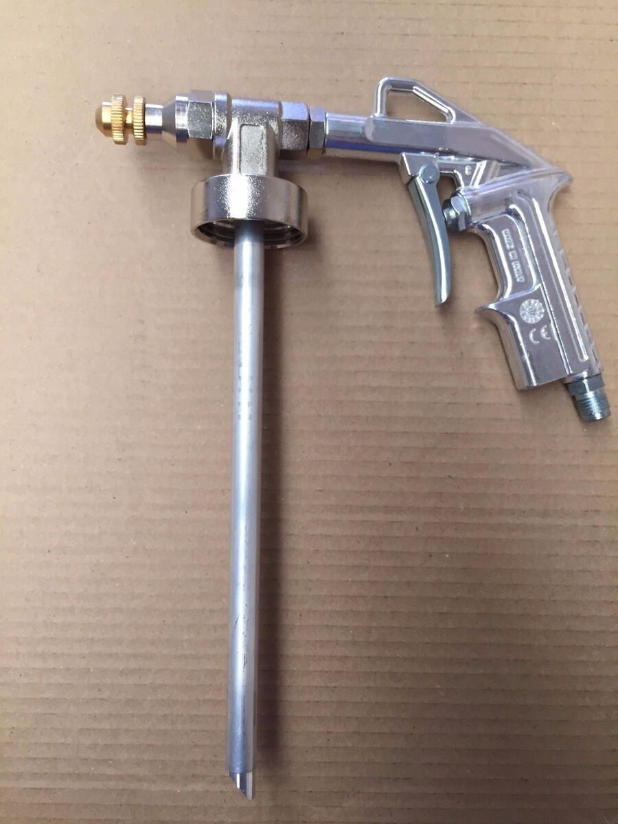

Others experiences may vary, as I am talking specifically about UPOL Raptor truck bed liner, but as UPOL produce a specific product for the underside of vehicles that is far easier to apply with the variable tip application gun, I recommend you look into UPOL Gravitex. It has the toughness of a bed liner, but with more plasticity. Storage is far easier too as you buy it in bottles that you slip the feed of the application gun into. I've had some (unopened) on the shelf of my garage for 6-12 months+ at a time with no application issues. Once dry, you can also paint over it if desired

Ryan, Thx for the guidance. Did you use a gun like this? Which primer did you use?
