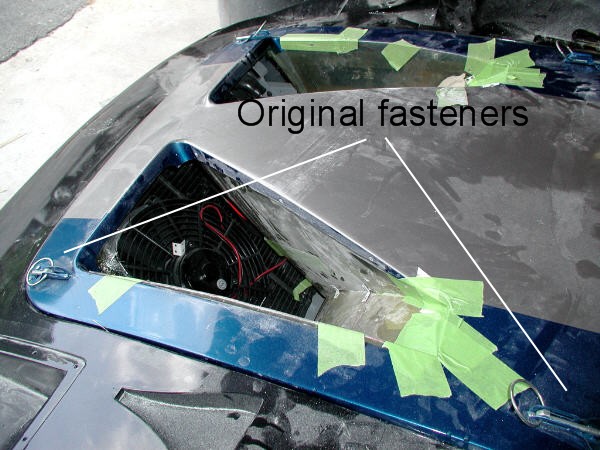

Anyone an idea if they are available and where. ( i wonder how the originals have done it, becuase on the pics you can see holes, meaning the spring need to be on the other side, dimensionwise itshould be th same)

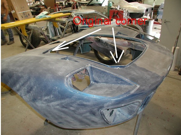

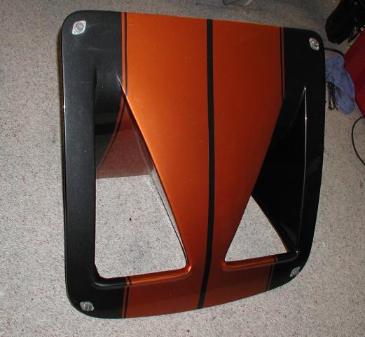

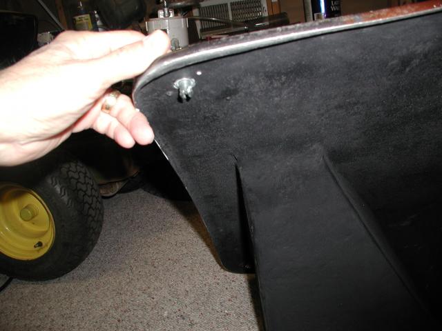

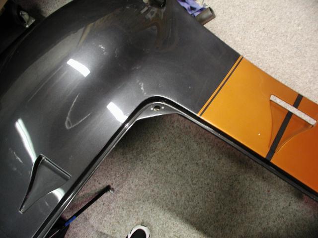

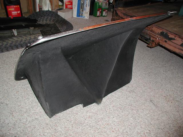

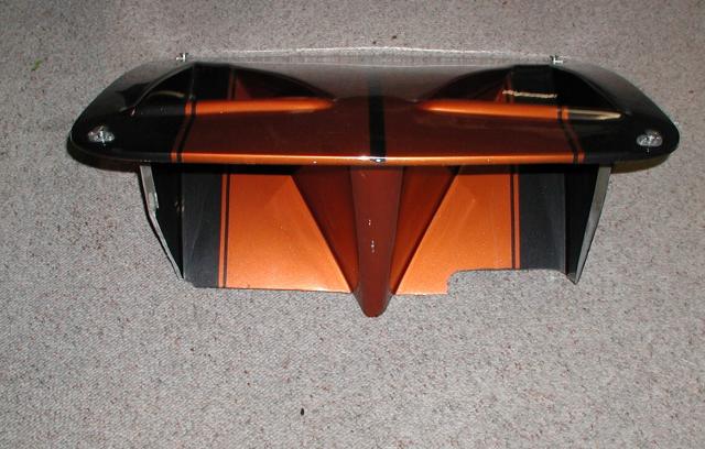

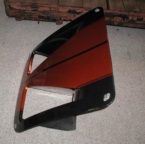

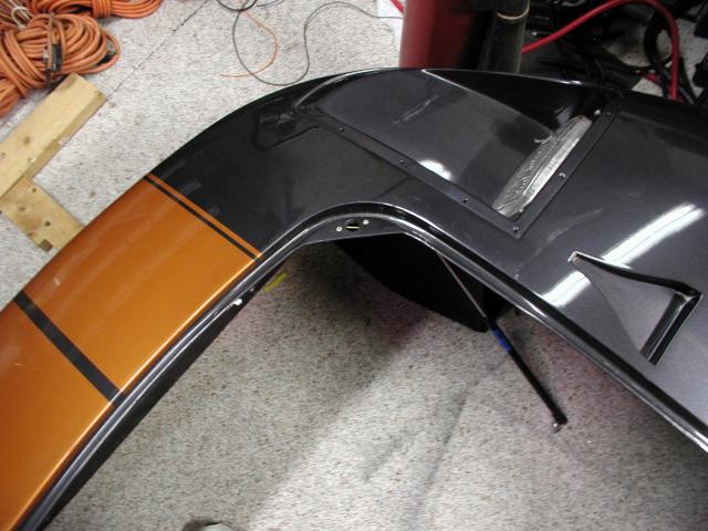

Rather than send you an email to my solution to mounting the hatch, I thought I would post it here for the benefit of the others with the same problem. When my car came it had some wierd latch mechanism I had never seen before. They were O K, but not what I wanted. When the car went to the painter I expressed my concerns to the owner who was a renound fiberglass guy. He suggested the Dzus fasteners. Upon looking, I couldn't find the ones long enough as well. When I told him that he put his thinking cap on and came up with an out of the box idea that was so simple that none of us had thought of it. What he did was cut out the corner, flip it over and reglass it in. This moved the mating surface up to the hatch surface and the regular lenght fasteners worked beautifully. Problem solved. You can see how he did it by the pics. Tom, I am sure this won't be a problem for you with your glass skills. I plan to replace the pop rivits with small button head screws and locking nuts. The underside expansion of the rivits doesn't loook real encouraging. They have held for about 4 1/2 years, with a lot of on and offs, but the car is still in the build stage and hasn't been stressed by the wind YET.

On the matter of them being used on the nostril panel, I don't see why you guys want to get longer fasteners. To me, any distance between the two panels gives less surface area to hold the panel rigidly in place and is prone to amplify the vibration . If the two panels are locked tight to each other, without any space between them, the lock will hold them better. I am no engineer, but my common sense tells me there would be less movement of the panel and fastener if there is no space between the two surfaces. I am sure some engineer out there will set me straight.
To that end, I still think my fiberglass guy did the right thing by inverting the corners under the panel and bringing the two surfaces together.
