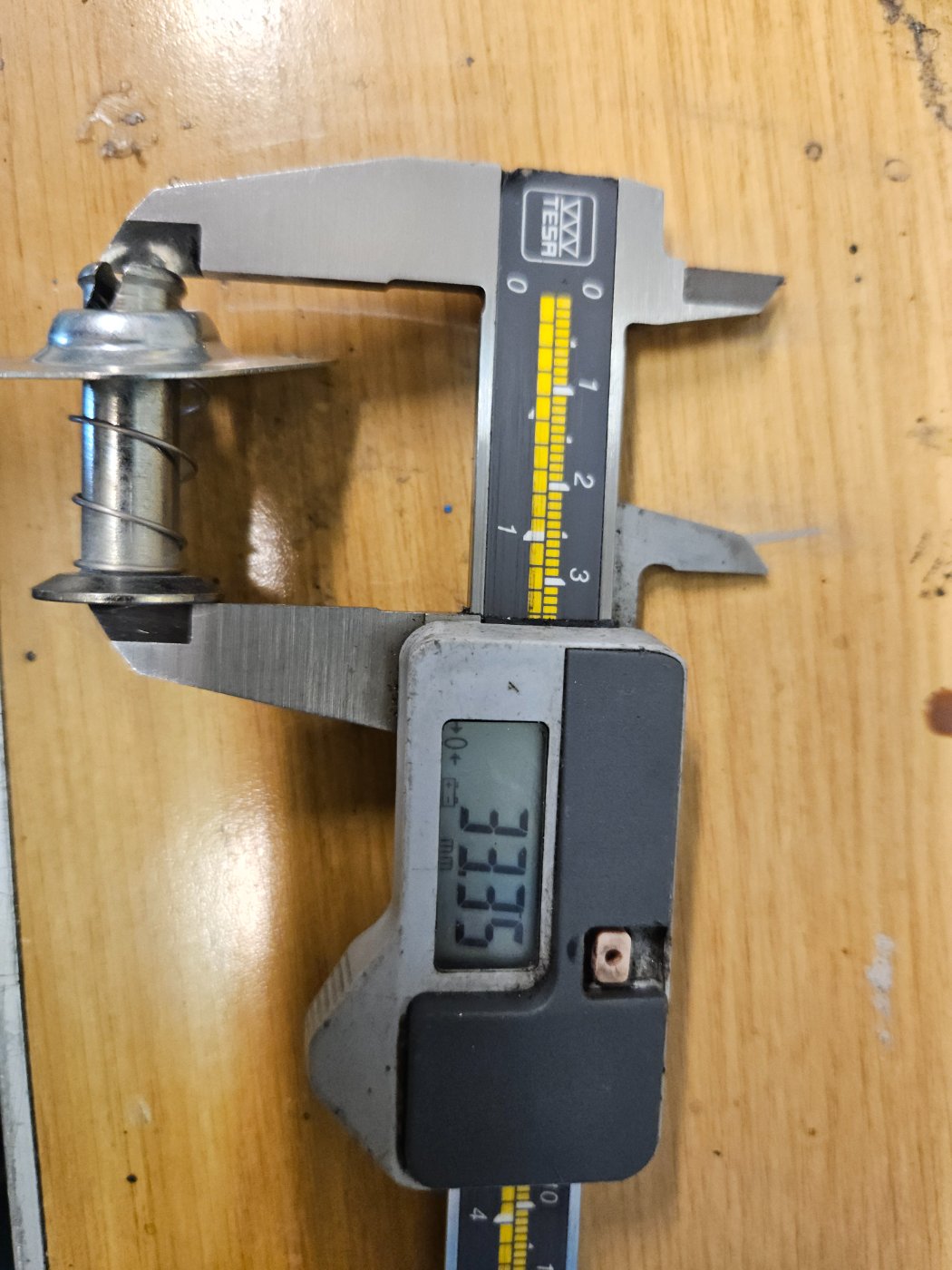

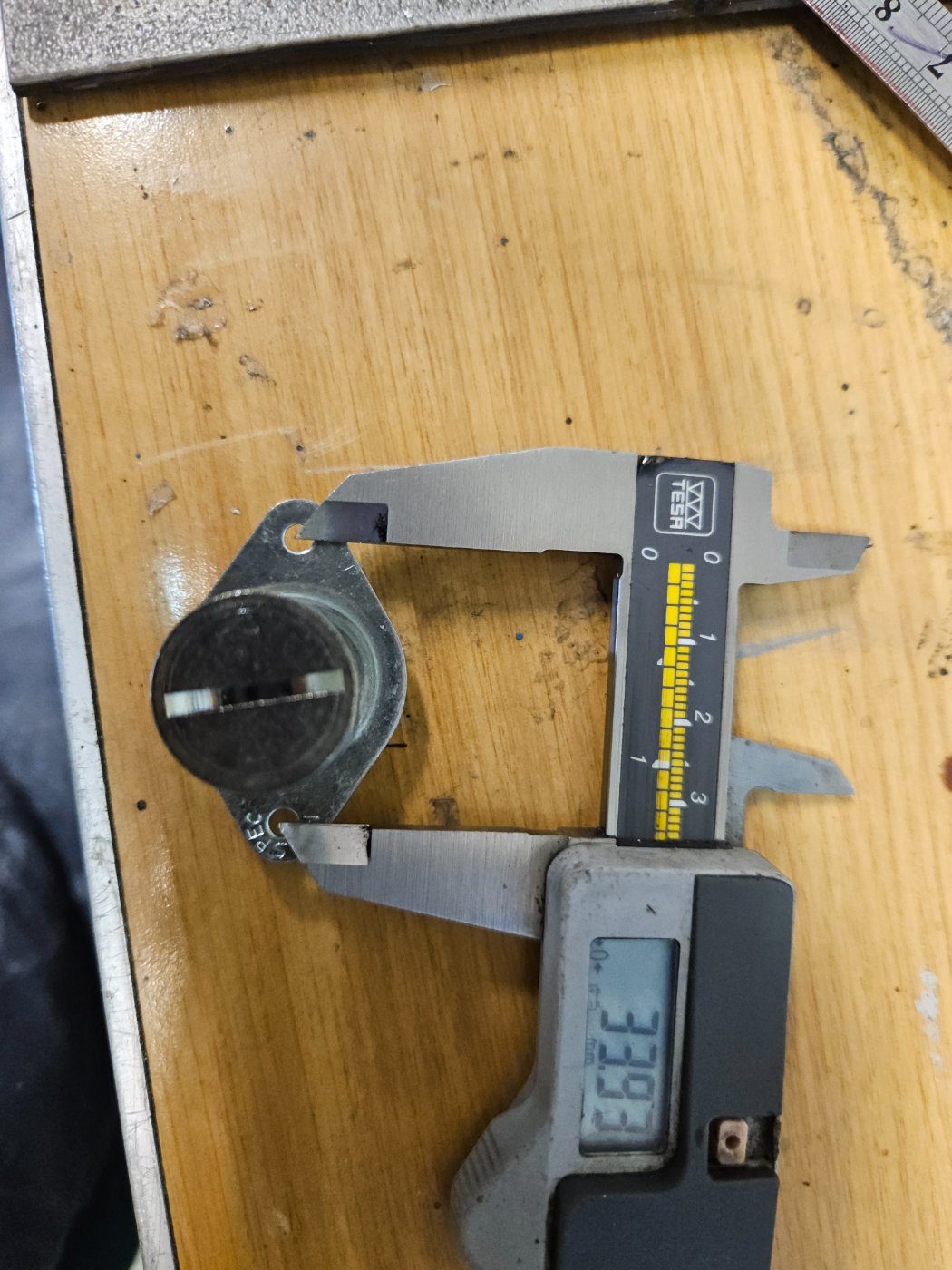

I am looking for DZUS fastner, apparently longer than standard ones (see photos), I cannot found them in Europe.
By mistake I found on a web page, that tells those parts were specially manufactured for RCR.
The length in inches is 1.31".
I have already 3 of them but one is missing.
Does anybody knows were I could buy some ?

Jerry, scott, thank you for your imput, but length is a problem even with the spring adjust at the minimum. Ian good input but diameter is too small.
The problem is coming from a mistake during the assembly of the car before I bought it. The spring wire was mounted on the top of the fiberglass panel with two screws instead to be mounted underneeth. In this case the nostril panel is not correctly hold in place and if the screws are going out (I know it is difficult) the panel can fly out. Normaly the spring shall be mounted underneeth the bonnet panel and the DZUS 1/4 turn fastner is going throug the hole to catch the wire of the spring.
I know that plenty of cars have a wrong assembly.

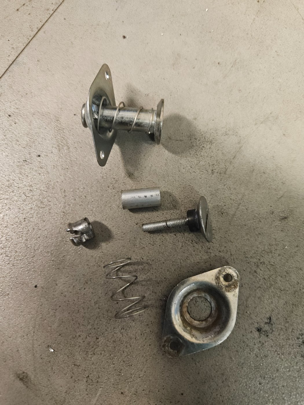

Thank you Charly, at this time, I solve my problem, only one long Dzus was missing and I decided to cut a standard one and machine by turning a spacer to reach the right length. I drilled the center to put a threaded rod and glued the assembly with epoxy. It seems OK. I will probaly change them later but now I cured the urgency.
