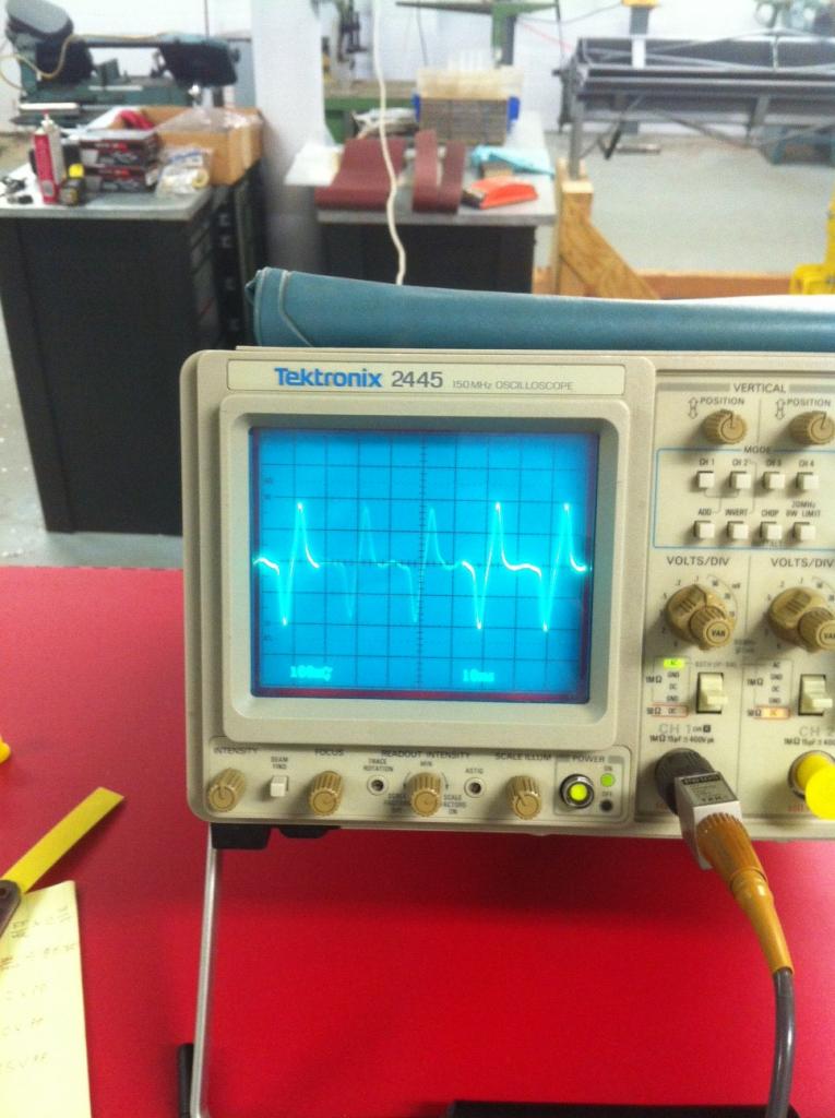

The typical variable reluctance probe is going to generate very low voltage pulses, especially at slow passing speeds. As the gap between the ferrous material you are sensing decreases and the relative passing speed increases the voltage will increase. With a DMM set to a DC milivolt range you might be able to see some numbers flicker on the meter as you rotate your bolt heads past your sensor.

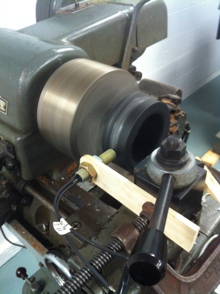

For my speedometer application on my GT40 I needed 10 pulses per reveloution with my wheel and tire package. I machined 10 spot faced locations (about .040 deep) around the outside of one of my CV joints and made a bracket to hold the VR sensor about .020 off the OD of the CV joint. Seems to work fine and speedo reads from about 4-5 MPH on up. I attached a couple of pictures of when I was testing it on a lathe.
You can "share" the output of a VR sensor with multiple electronic devices, however, they must all be very high input impedance (would suggest at least 1M ohm or better). The very small magnetic flux change results in this type of sensor generating a very small amount of voltage / currrent.
