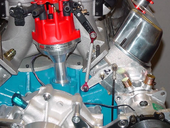

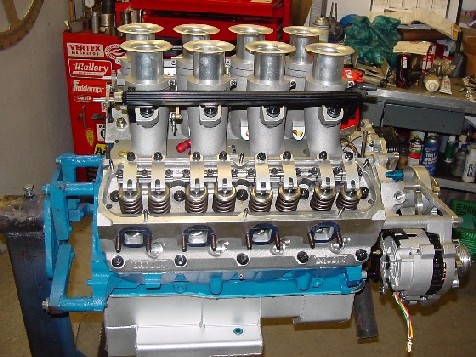

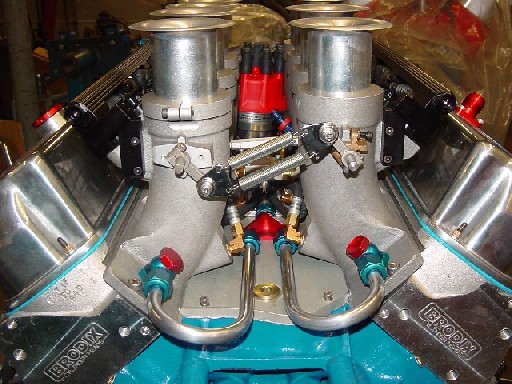

This is the mock-up of the Hilborn EFI with a view of the Jesel rockers.

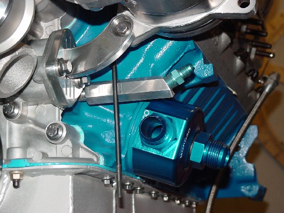

Compressor mount, oil pressure, and oil cooler in & out.
The black rod hanging down is a clearance mock-up for the throttle linkage.
Throttle linkage.
The bell crank he designed lets the cable come up from behind the seat and pull straight down, thereby avoiding another bend or two. Close clearances.

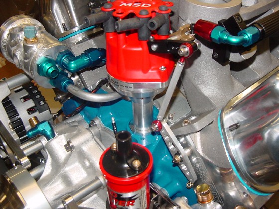

Thermostat housing.
We called this Frankenstein's (?sp) Baby. It was pretty ugly when he was done welding, and before it was polished up. It started life as a piece of tubing.
The two of the three blue lines are returning water from the front corners of the intake manifold. The lower line is returning water from the two in the back to avoid steam pockets as discussed by Blackjack in "HEY, ROB LOGAN ---".

Here is the other end with the two rear water jackets merging into one line.

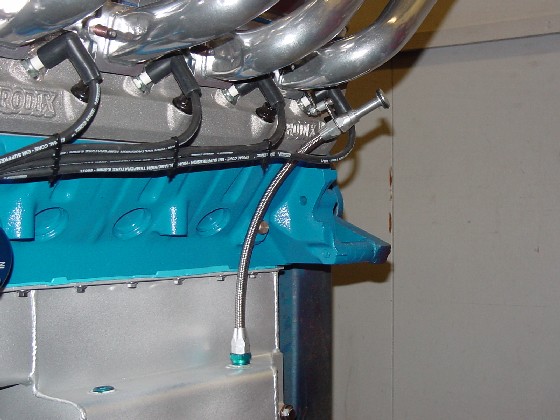

Mmmmmy kinda motor--just looking at the oil pressure "switch" extension,if its the aluminium one,then its gonna break at the thread into the block--and you don't want oil spraying all over that nice motor.From my experience I use a steel one.
Anyway good luck!
Chris DRB sheik down engineer /ubbthreads/images/graemlins/cool.gif
Buzz,

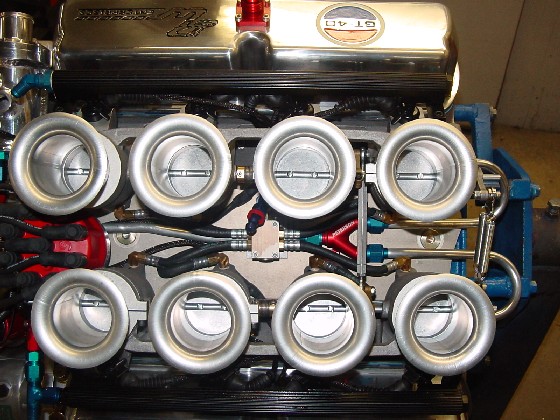

Looks great, and good luck. I agree that the aluminum oil fitting might be a problem. You could run a braided hose right off the block to a remote mount sensor. This is what I did and it worked great. Rember to ground the shell of the sensor to the chassis. Also What are the lines going in the bottom of the trottle bodies on the inside. I assume that is for idle air?
Take it easy,
flatchat & Gary:
Thanks for the heads up. I'll be asking Ron Whitney, my engine builder, in a few hours.
Here's another shot of those vacuum lines Gary. They go to a raised central plenum, then one fitting exits near the top of the plenum in this pic.

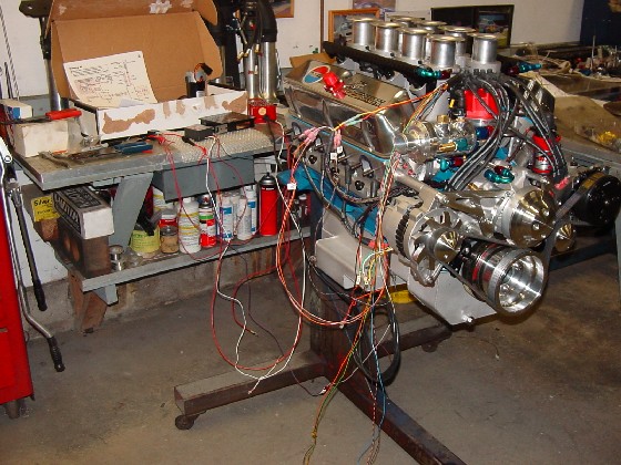

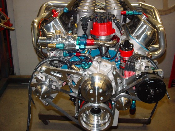

Almost there! Just a few ignition wires to hook-up.
What a work of art. Beautiful attention to detail, Buzz. Let us know how she does on the dyno. I had an engine dynoed a couple of years ago about this time. I wasn't able to be there for the session and I remember waiting anxiously for the builder to fax me the dyno sheets--

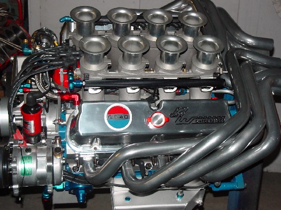

I picked the Hilborn ECU as a mid-point between a carb and a Motec controlled stack injection. Easy adjustment with a screwdriver, fewer wires, and no extra circuitry.

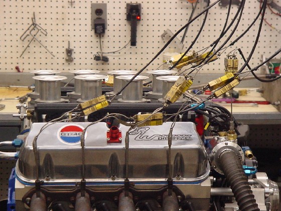

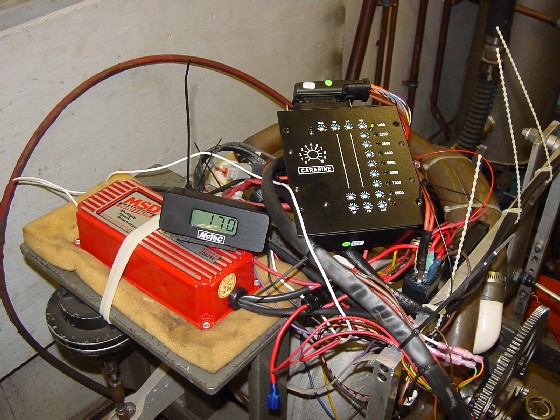

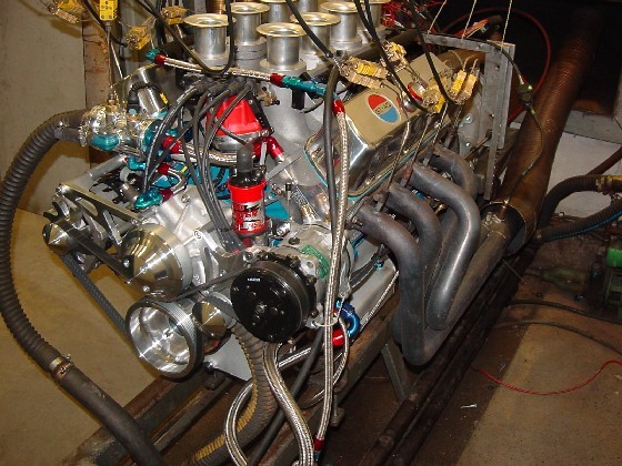

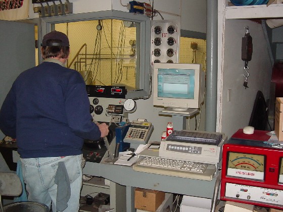

Hooken-up that Puppy.

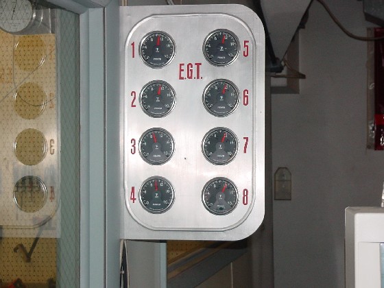

He couldn't dyno it with the bundle of snakes because he wanted the info from the Exhaust Gas Temperature probes.
