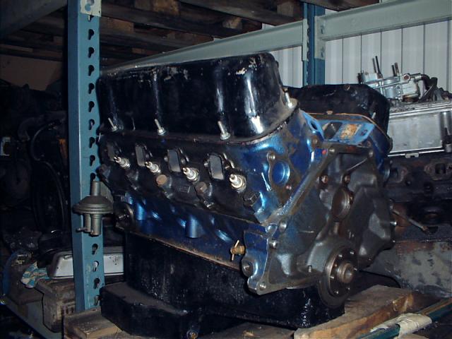

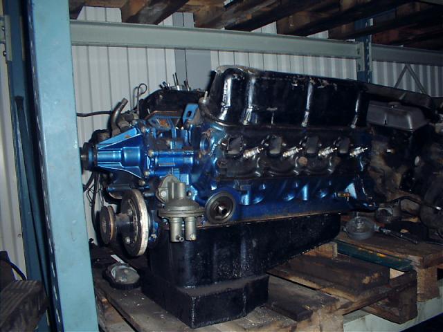

Just got these pictures, but they do not tell me what engine, I'm very glad that You can supply me with help here
Rune

It would appear that they are 289 heads ( the only clue is the exposed thread area on the heads for the 4 corner bolts of the intake manifold-- on later 302 heads these are enclosed by the head casting ) and the narrow width of the outer damper ring also points to a standard 289/302 crankshaft etc. Looks like the heads may have some porting work done and the fact that rocker covers have been extended to clear either roller rockers or stud girdle suggests that there may be some good bits inside.
Ask them to remove a rocker cover and take a close up shot of the valve spring pocket etc and into the ex port , along with any casting numbers . Of course if they are up with the play the price may change if they know what to look for.
Jac Mac
