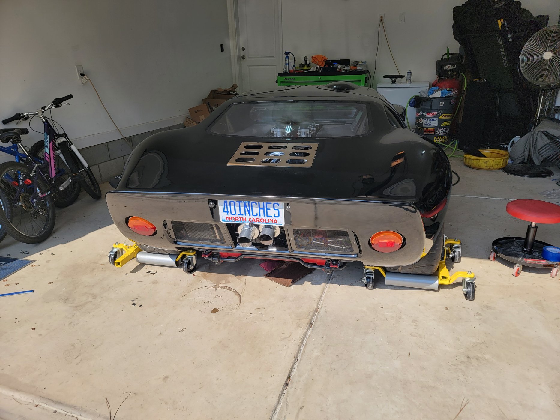

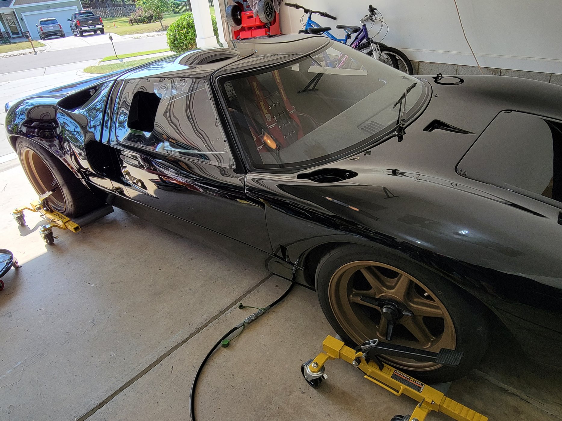

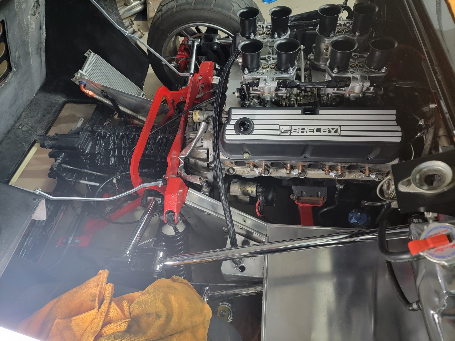

Thank you for all the replies this was all extremely helpful. I actually recently acquired the car a little over a month ago and bought it from a fellow member on here. Car had been sitting for awhile so I am in the process of going through the car while making some changes and updates. There is definitely still a lot of work to do but over all it is in good shape.
As I am going through the car I have recently replaced both fuel pumps, plugs, wires and all of the fuel lines. The car did struggle to idle initially but the idle was set to low so I raised the idle to about 750rpms and now it idles much better.
The carburetors definitely need to be rebuilt and one of them is spray a large amont of fuel in even at idle. All of the old plugs were super black when I changed them so once I work through a few of these other issues I plan on taking the car to Olthoff Racing to have them go through the carbs.

As you have changed the fuel pumps you may need to check the fuel pressure. Weber carbs need no more than 3psi or the pressure will push the float needles open. This will result in fuel overflowing leading to the black plugs you describe.
Once the fuel pressure is correct the next thing to check is the float level on all 4 carbs. This is easy to do using a 10mm drill as a feeler gauge. These two steps may be all that is needed.
Use a piece of tubing to listen to the idle airflow to balance the carbs or use an air flow meter. Check the idle screws are all set the same by screwing in and counting the turns to close and then open again so they are all the same. That will get you pretty near until you can get the car on a rolling road to do the fine tuning.
However Weber IDAs are easy to strip and rebuild if needed. Rebuild and setting info can be found on line.

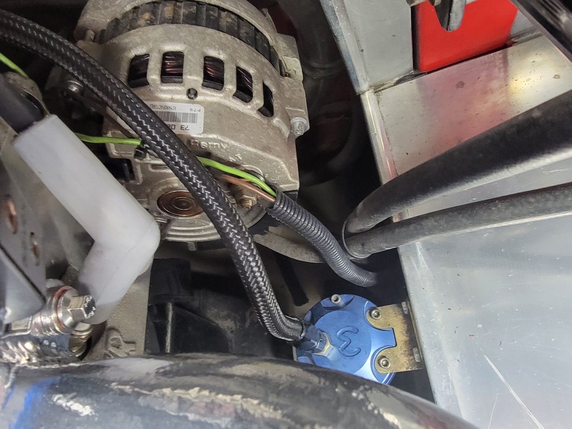

You would probably be well advised to change the routing on the two wires rubbing on the pole at the back of the alternator also could be a future problem,car looks nice
