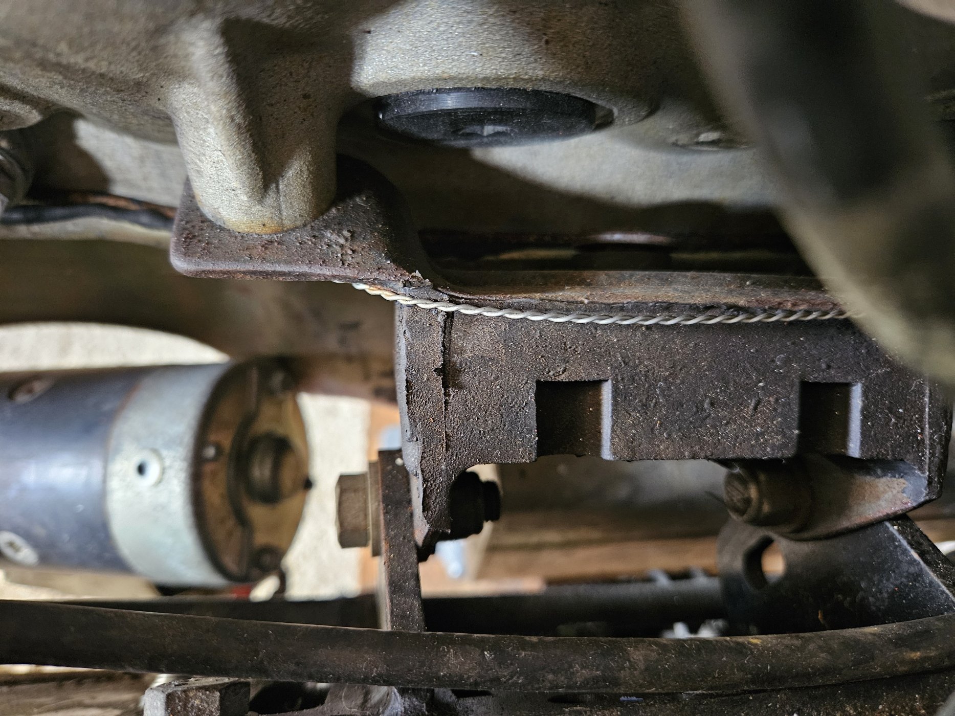

I checked how my engine was assembled on the engine mount (done by the previous owner) and it was done with lock wire on the engine side (hot) and nyllock ont the frame side [cold)
Thx much. Nyloc on the inside makes sense to me. The chassis is a pretty big heat sink so should be fine. I am planning to add a steel doubler on the inside of the tub to make it a bit more robust.

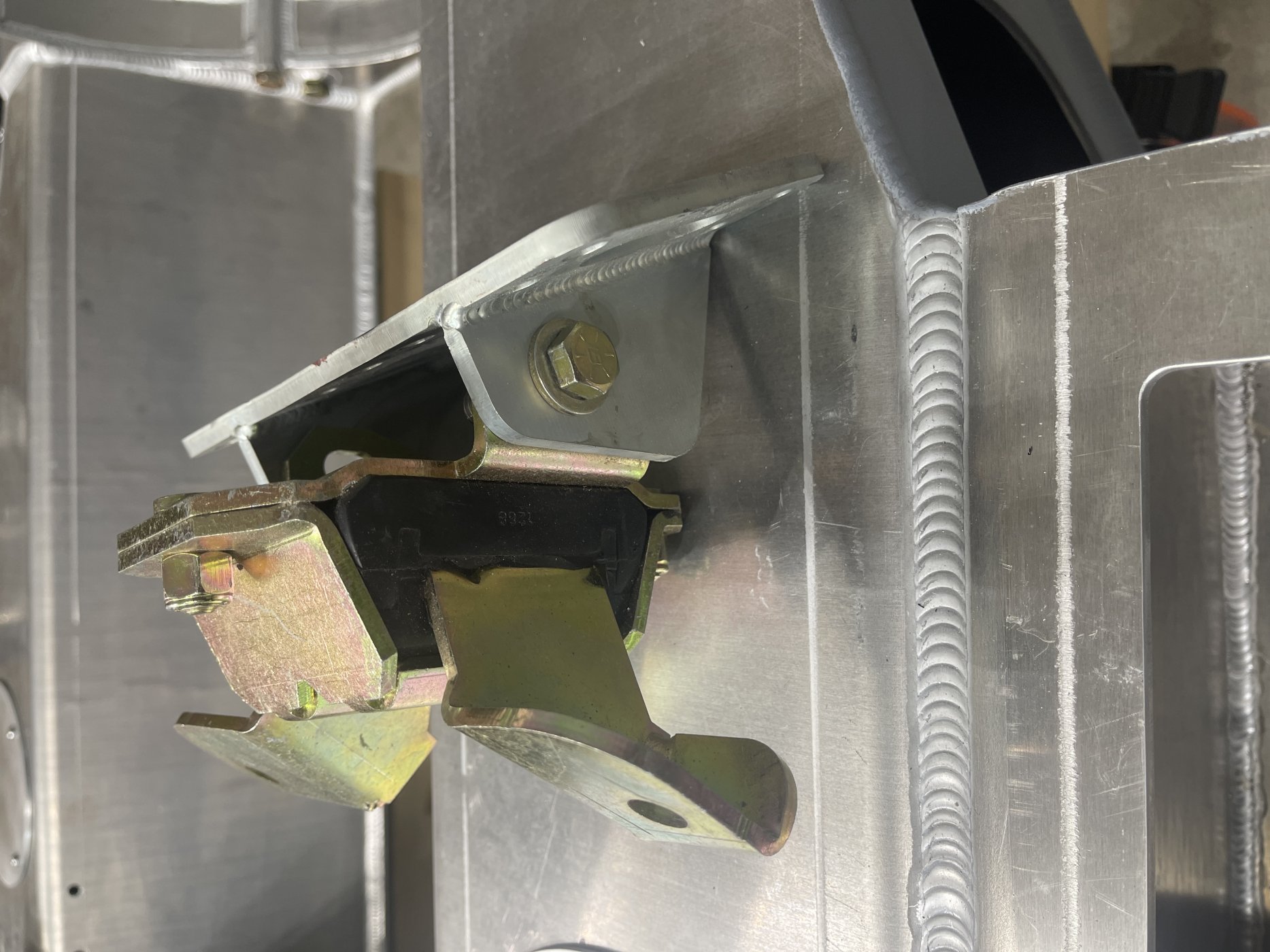

If one bolt, then it can’t be tightened down. There would be total reliance on the locking nut. Over time the tabs would likely bend inward allowing the engine to move back and forth. That would get progressively worse.
The solution is to insert a piece of pipe between the tabs.
I found out that using these mounts requires unbolting them at the tub mount because of the oil pan. A single bolt with a spacer pipe will make that much easier because reaching the nuts inside the mount takes a bit of contortion.

I used a 20 ton press to "squeeze" the Prothane mounts together a bit to fit inside the RCR mounts. The steel used on the Prothane mounts is way overkill in my mind for this application. A steel spacer/bushing will solve any concerns, but these mounts are massive compared to the stock 67 Mustang mounts suggested by RCR.
