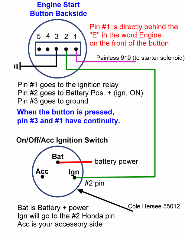

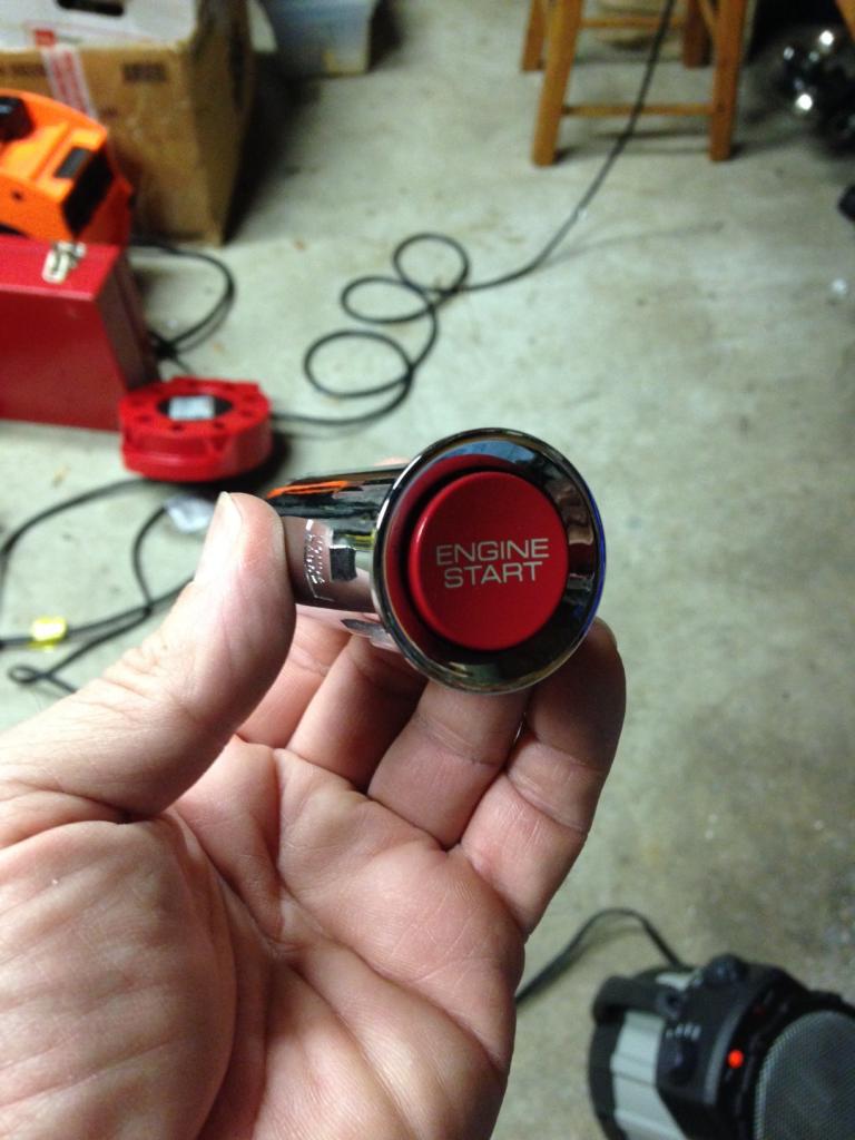

I think, I'll just pick up one of the Honda switches off Ebay. There is also the connector available on line.
