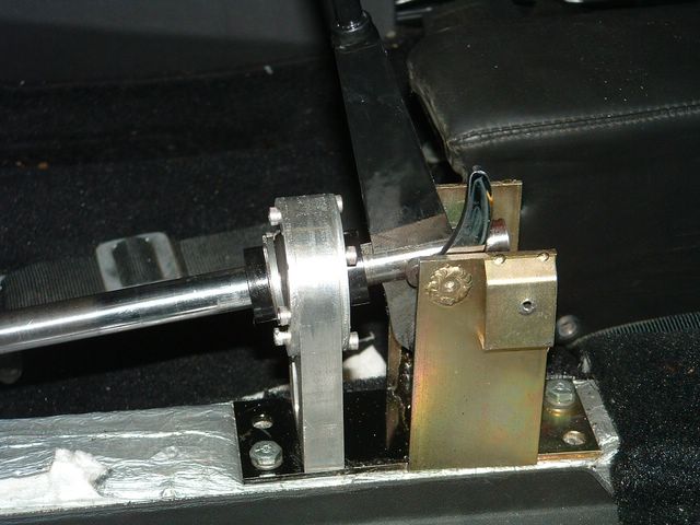

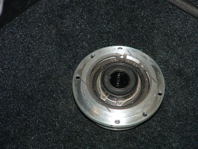

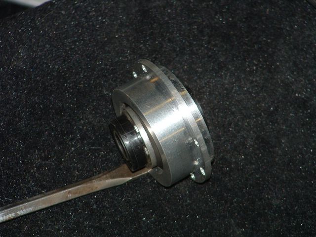

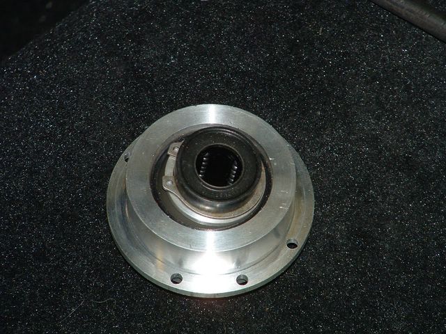

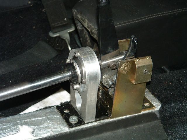

Anyway, I got two 5/8" Thomson ball bushings (model with seals), and two 30mm spherical bearings. Made small spacer bushings to fit the ball bushings into the spherical bearings, and housings to mount the spherical bearings, one to replace the firewall bearing and one to replace the heim joint at the shifter. Had to drill the hole in the firewall out bigger and cut the heim joint off the shifter mechanism housing. Got them to fit with no cutting or other modifications to the z bar or remaining rods. It was a fair amount of work making the housings and difficult to put the one in the firewall with the engine in,but......the results are fantastic.
Had the car on a 3 hour drive today to get it good and hot. A good modification that was worth the effort.
Cost was about $40 for the bushings and bearings (gotta love ebay!). Had aluminum stock, so it was "free".
