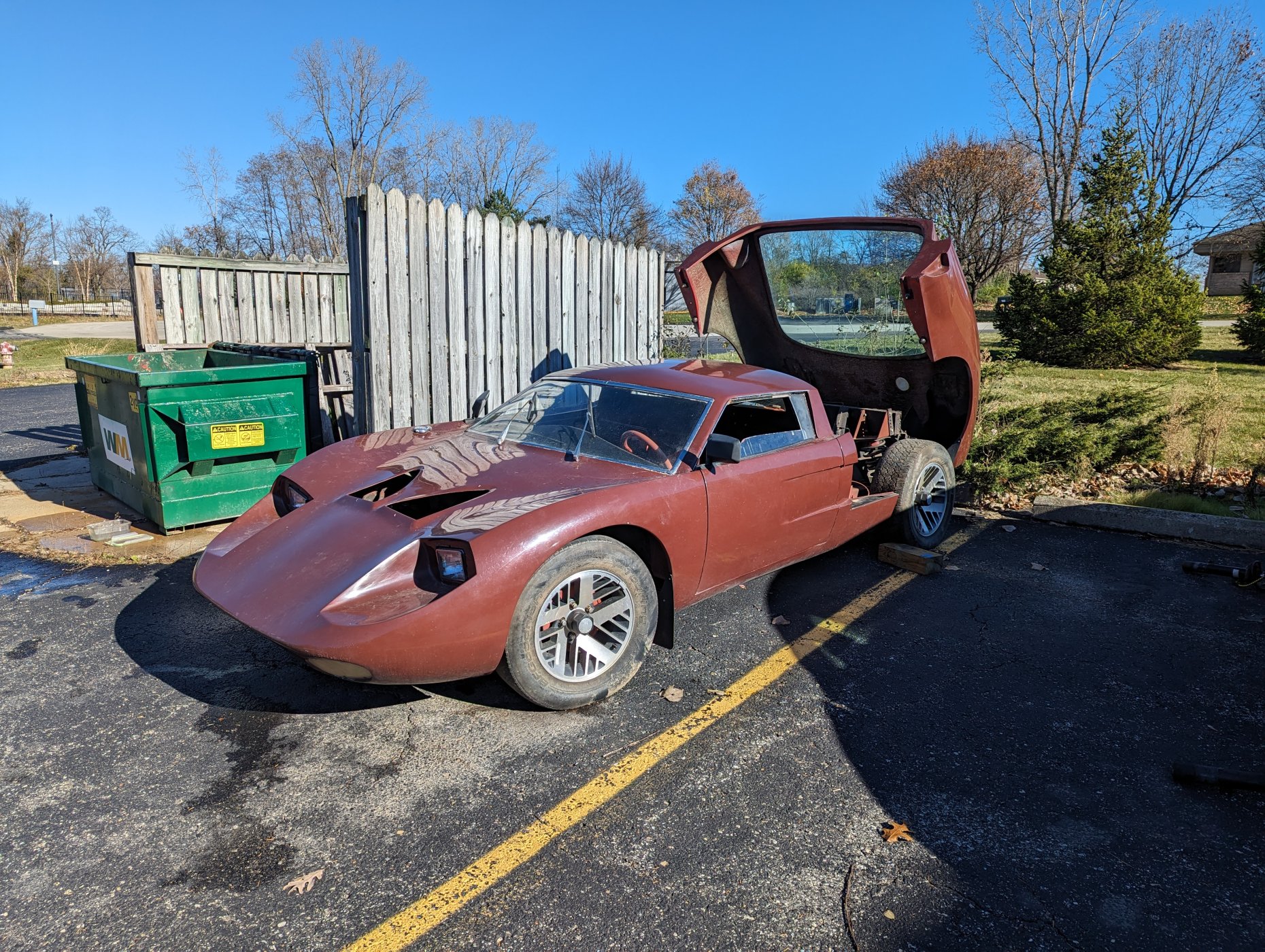

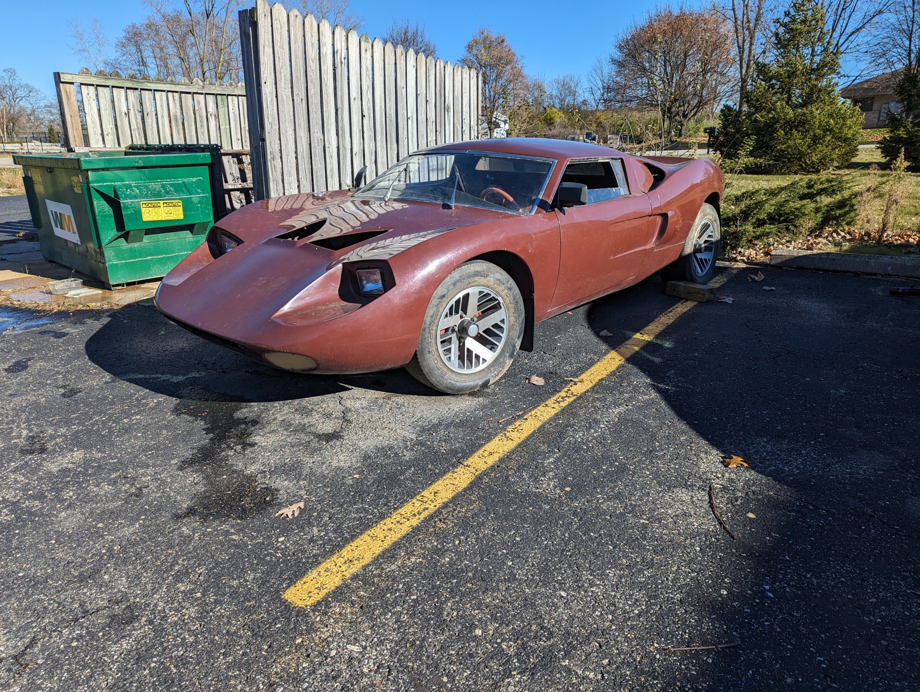

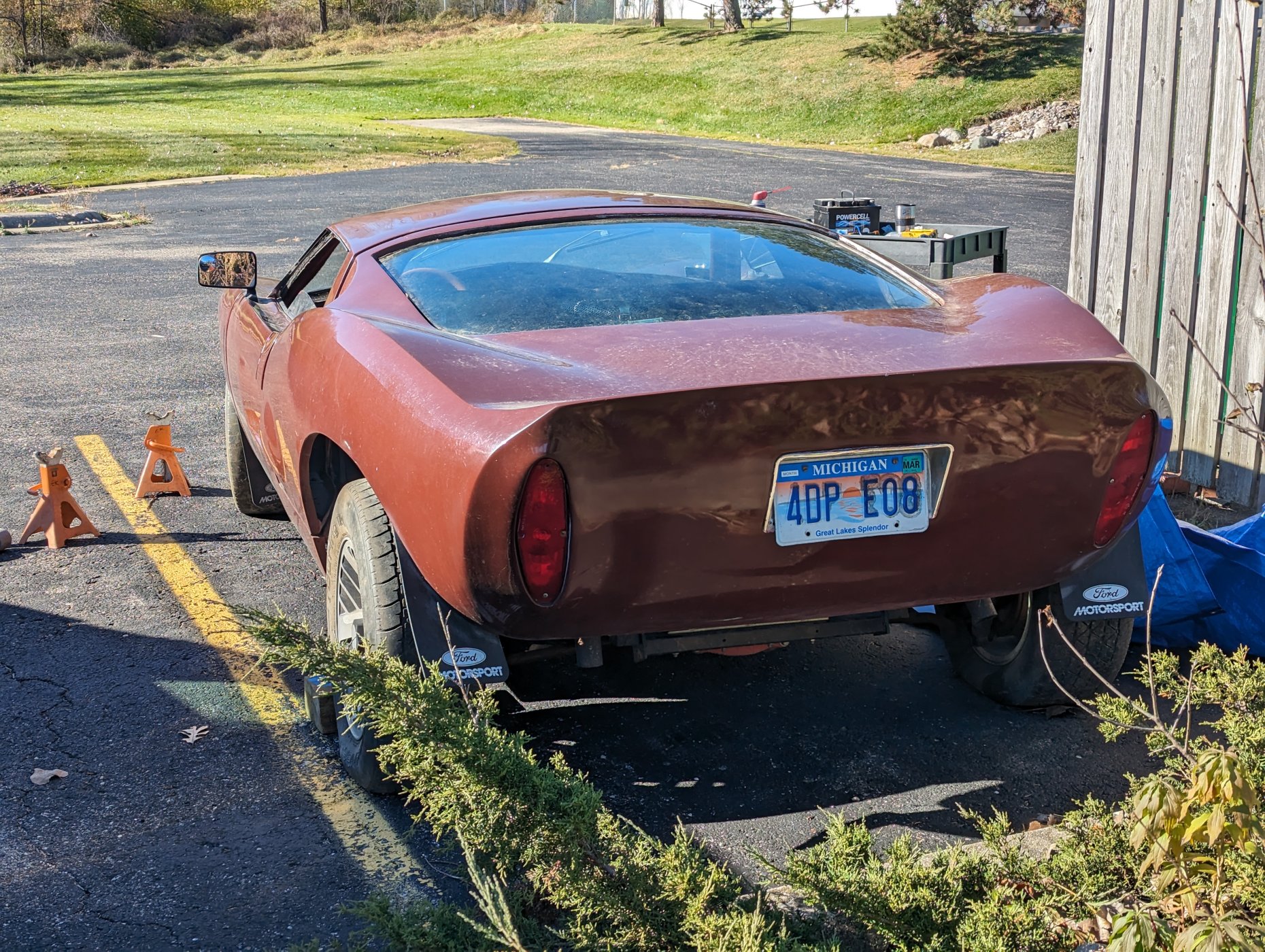

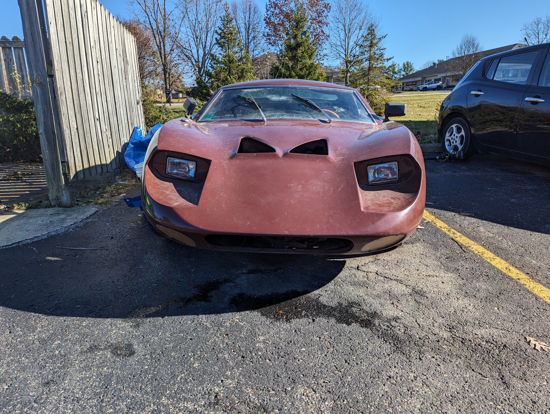

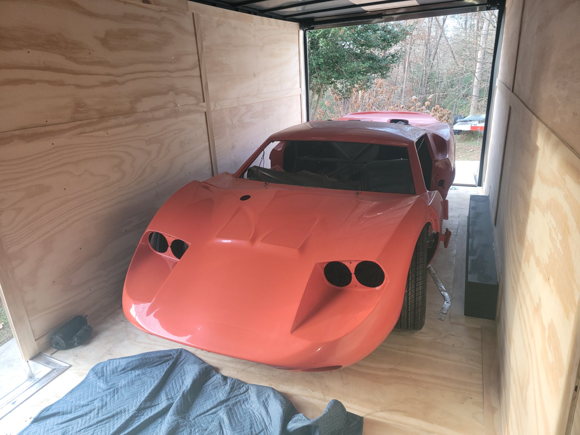

Here are some photos of the FiberFab Valkyrie I just purchased. Yes I know it's not a close replica of a GT40 but it is certainly inspired by the GT40. As am I. :)

Some details:
2" x 5" rectangular tube frame, not a VW floorpan. So it's clearly a Valkyrie not an Avenger.

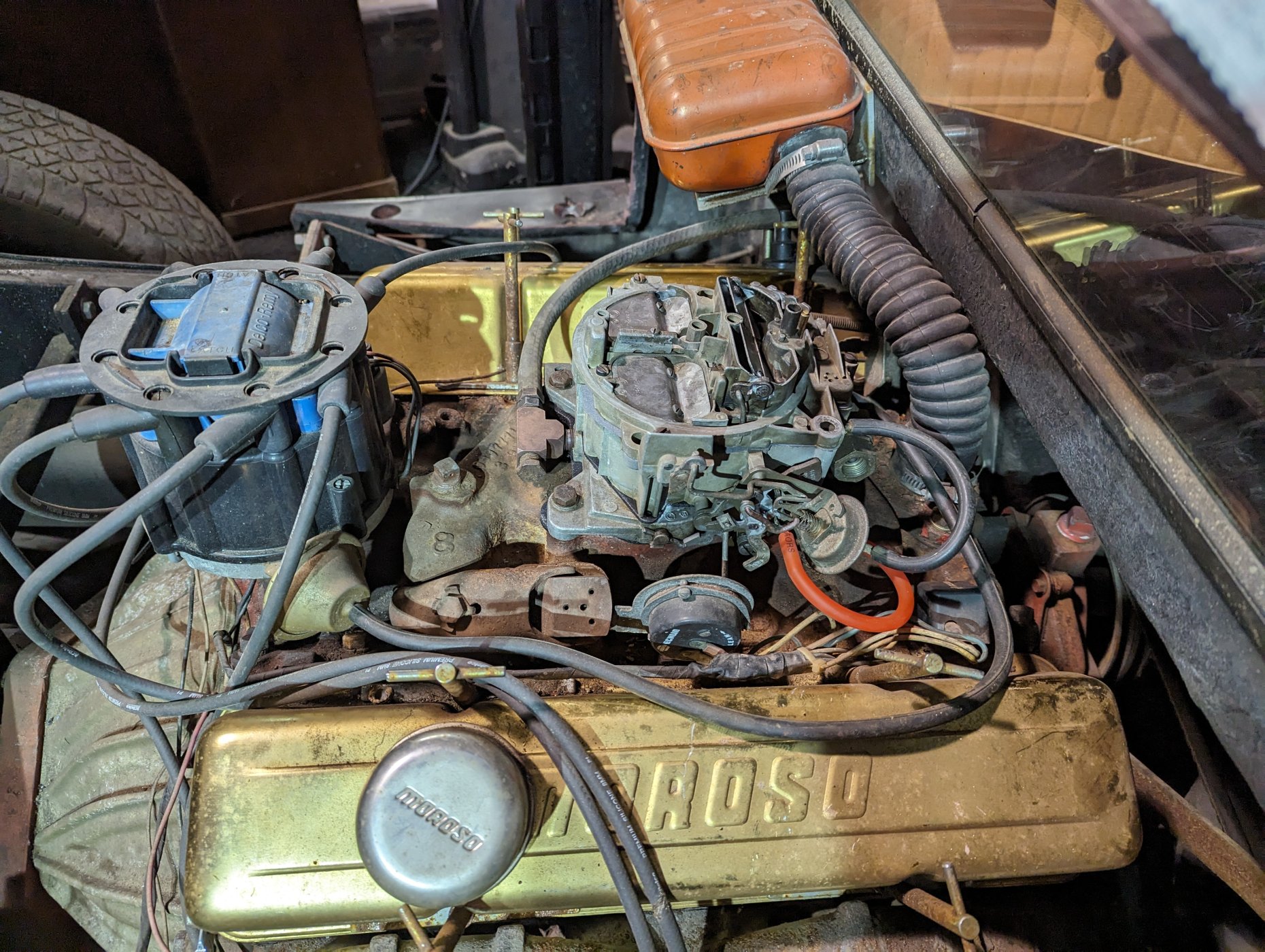

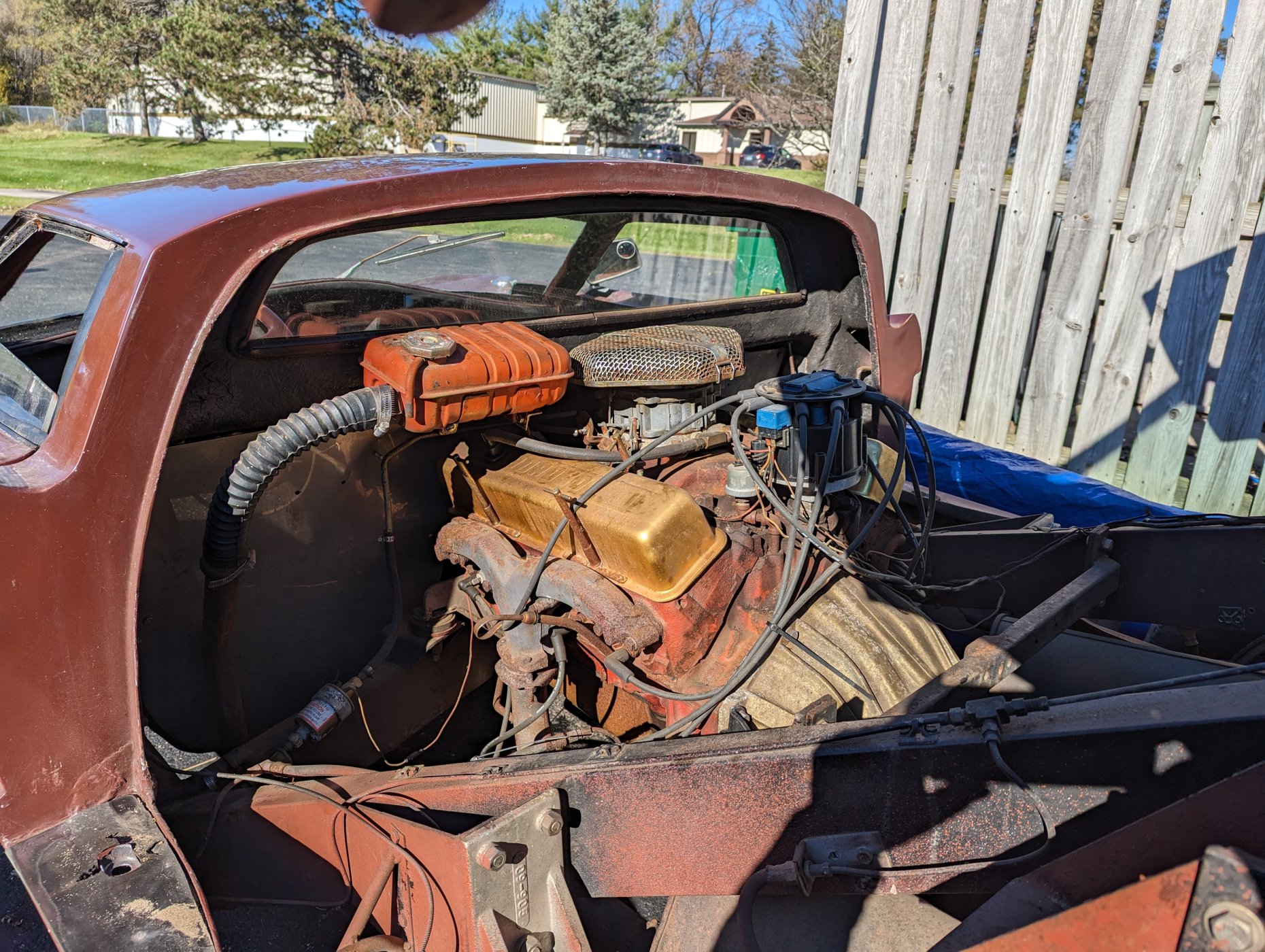

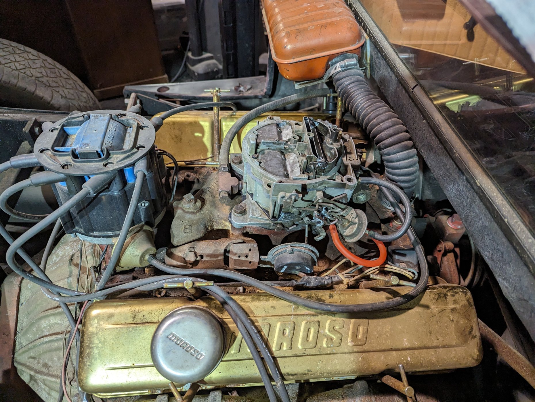

Chevy small block, I'm told it is a 305. Appears stock, with iron manifolds, Quadrajet, and HEI distributor.
Corvair rear suspension, Corvair transaxle with Fiberfab adapters (similar to Crown?)
Production looking front suspension, I'm guessing Corvair since the drum brakes :-( look the same as the rear. But it has rack and pinion steering.
I'm told the previous owner parked it in a barn in Michigan before he died. I bought it from his widow and her family friend. "Ran when parked" is good news in this case, it's a complete car not an incomplete kit. The body is in remarkably good shape and the frame is rust free. But it has not run in 16 years.

- Removed carburetor to rebuild it.

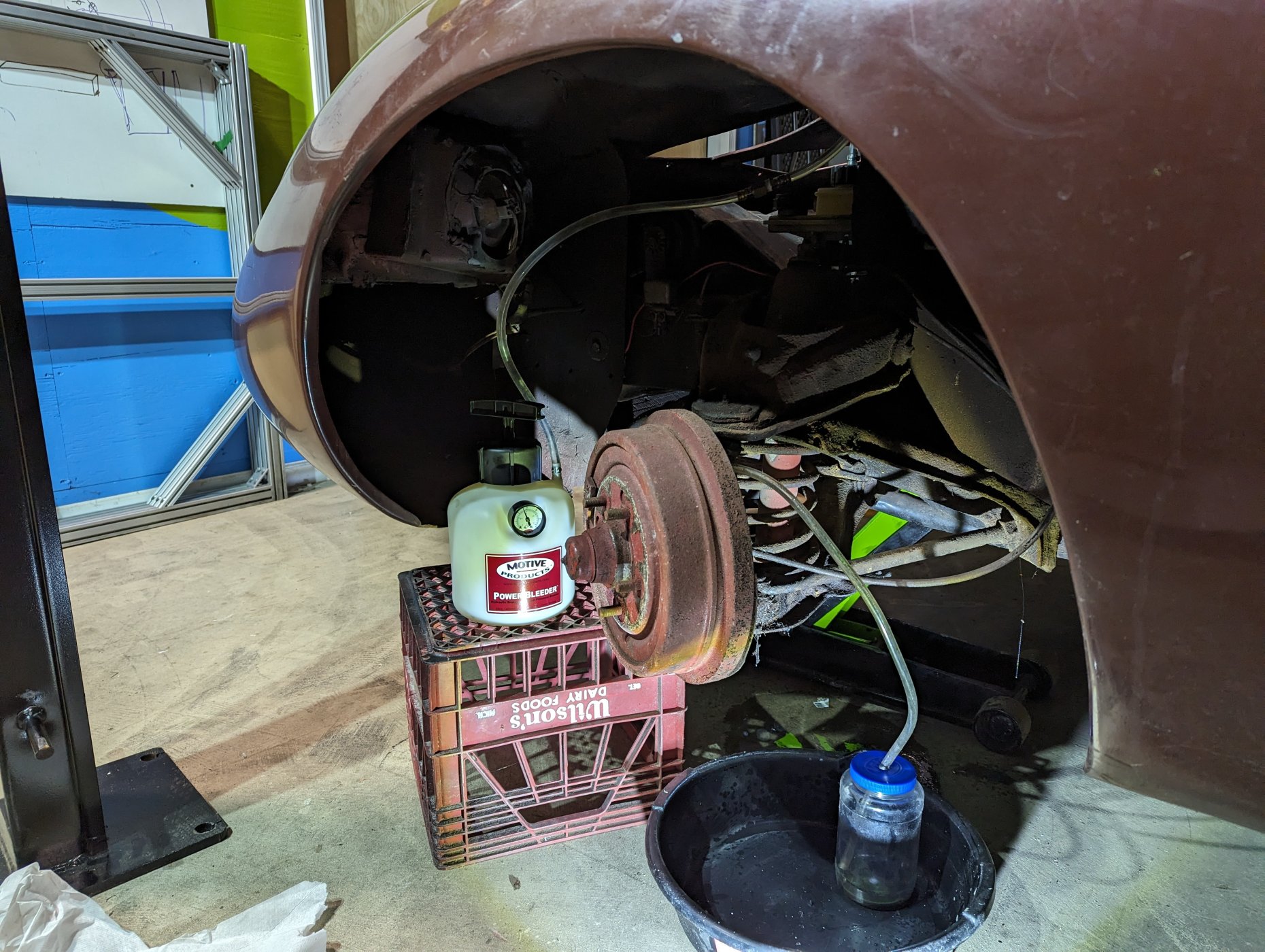

- Brake and clutch pedals have at least some feel. Next step is to flush and bleed the hydraulic systems. I have a pressure bleeder and the bleeder screws that I have tried so far were not too stuck, so this should not be hard.
- Next up rebuild the carb and put in fresh gas, see if it will start. If I can drive it even around the parking lot that will give me a lot of reassurance and enthusiasm to continue the project.

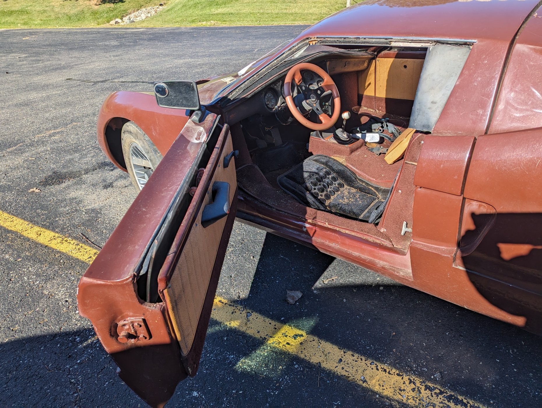

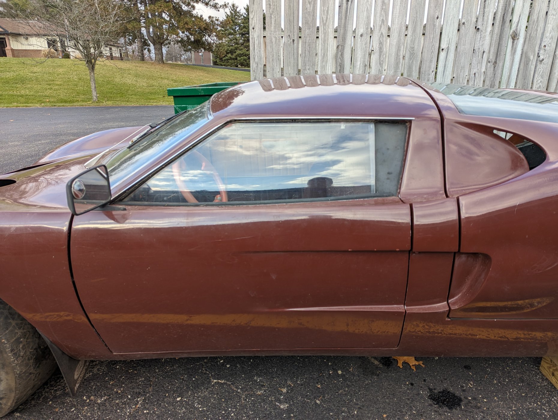

The things I like least about the car so far are the side window situation, followed closely by the difficulty of getting in and out of the cabin.
The drivers side window is plastic, looks home-made. The crank regulator does not work but I can push the window up and down and it more or less stays put. The passenger side window is missing. The rollers in the door and the regulator crank are there so it may once have existed.
As you can see it has no vent windows, does this make it a 'long door' car? But look at those fixed black panels behind the windows, I think a previous owner added them to go with the homemade windows. They make ingress and egress even more difficult. I'd sure like to find a window solution that lets me eliminate these. Any suggestions?
I can imagine a long list of things I'd change on the car, from minor to major. But I'm not going to start into those before I get it running and driving.
I’m pretty sure that the rear glass is from a 65-66 Ford Mustang Fastback. Perhaps some of the other glass was similarly sourced?
The plastic side window is gently but definitely curved. Flat would be a lot easier.
I have read that the vent window is 60-something Mustang and the accompanying side glass is 60-something LTD hardtop rear door glass. I dunno how hard that would be to find.... And I don't know what the one piece glass (without vent window) is from.

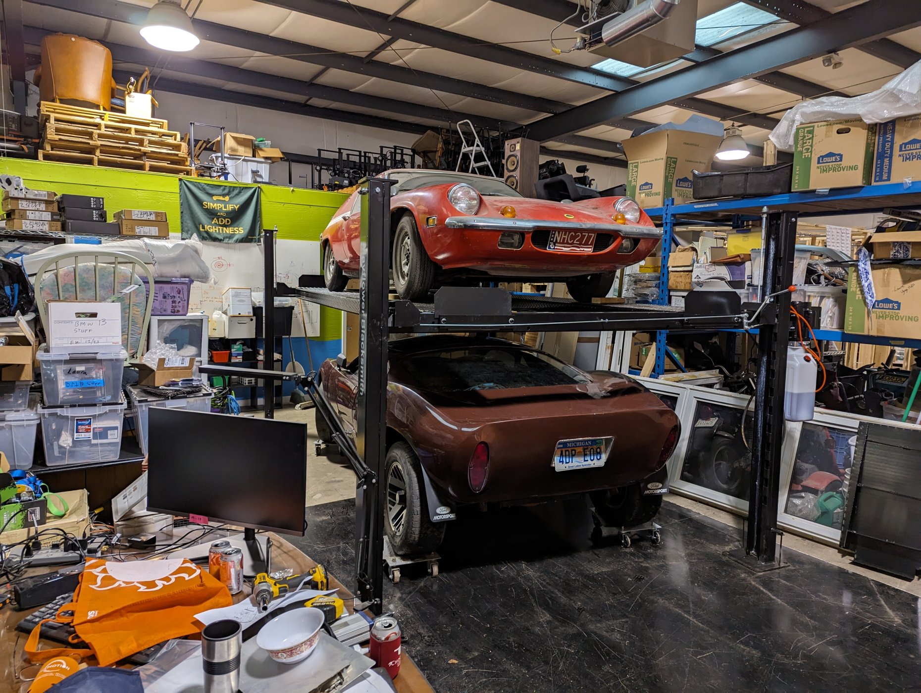

With some helpers, yesterday I assembled this four post lift, and today got the Lotus out of the way and the Valkyrie parked indoors where it will be safe from the snow and easier to work on. This is the view from my desk, hopefully it will inspire me. The Valkyrie is up on casters to make it easier to roll around, that's why it looks so tall.

After rebuilding the carburetor and hanging a temporary gas tank, the engine started right up. It shows good oil pressure. This makes me feel much better about all the long hours this project will require.

- flushed and pressure bled the brakes, now it has reasonable pedal feel.

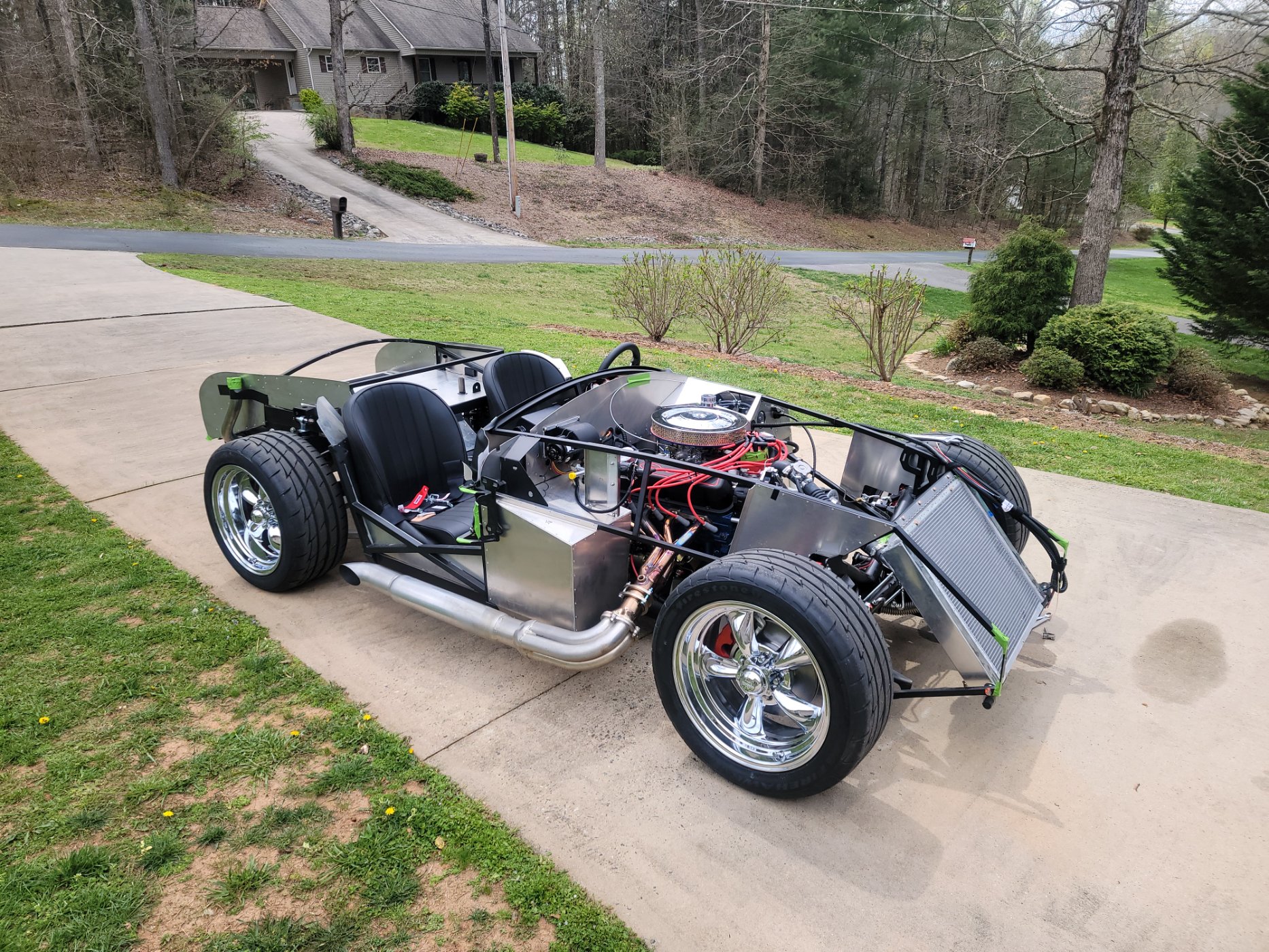

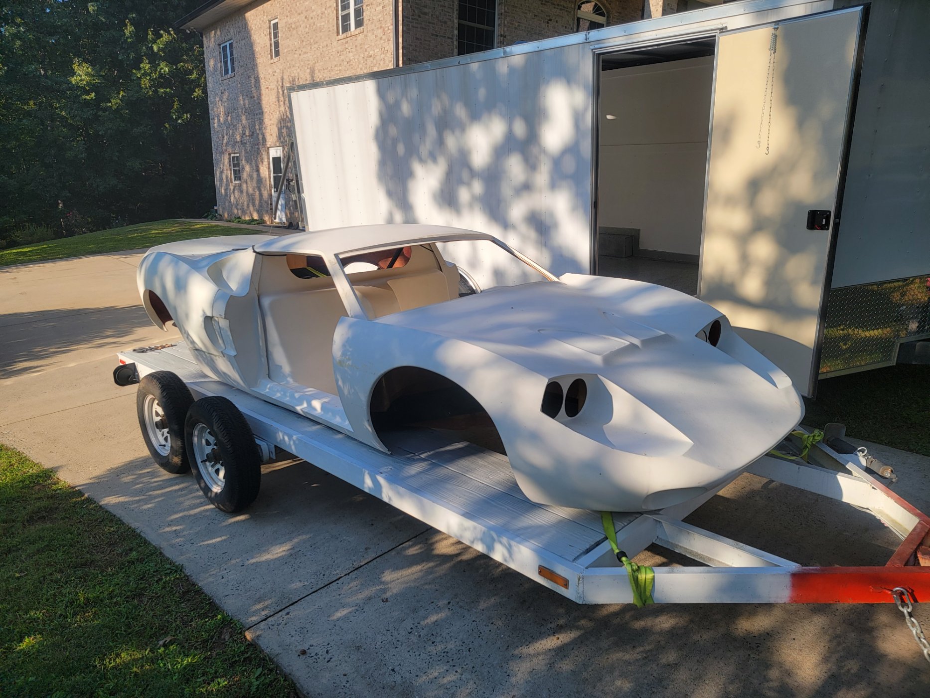

I am thrilled to see your post! I have been infatuated with GT 40s my whole life. I too am a mechanical engineer. I have done a good bit of car restorations primarily 440 mopars and some minor racing. I acquired a VW or corvair powered Avenger not done and in parts recently. Then I came across a "new" 2004 vintage Valkyrie body and frame I could not pass up. I plan to build my Factory 5 cobra kit next and then in a year or so jump on my Valkyrie project after I retire formally. Plan to go 302/347 small block Ford (like in my Cobra) and probably Porsche Boxter S transaxle and Corvette C5 rear suspension. I would love to hear back and see how you are coming. This my first post on the site. I would love to hear from other Valkyrie guys too...we certainly are the minority.

Erik K,
Thanks Michael
Wow, a clean and un-molested Valkyrie frame and body, that is a find indeed!
Small block Ford and Porsche transaxle is solid choice. This is much shorter than the Corvair transaxle that the car was designed for, so the engine will sit farther back and you could use that to make more room in the cockpit. I have no experience with Corvette rear suspension but it seems to be popular.
There are Valkyrie resources on the web, there are I think three relevant forums on that Face thingy. ;) And the original build manuals are still available, I think there is a link in a post above.
I've been making progress on my project, a test drive is so close I can taste it. Compared to building a new car my task is much simpler, there is much less to do. And also sometimes more frustrating or unpredictable, as I find messes the previous owners have left. So far in general the car has been easier to work on than I expected, I'm enjoying it.

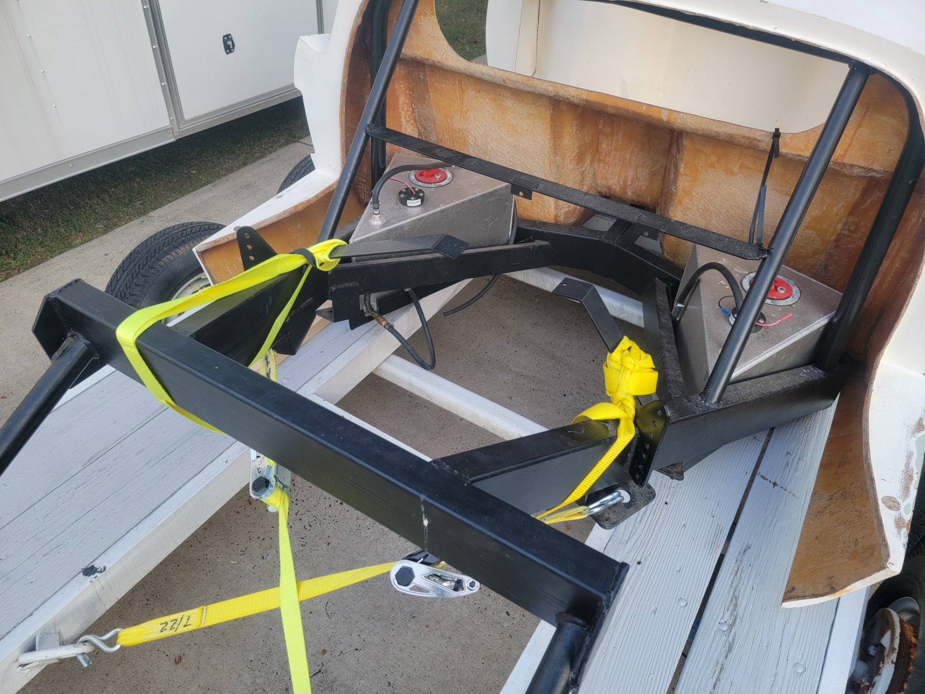

Attached is the VW/Corvair based Avenger I acquired that is now on the "back-back" burner since I acquired by 302 based Valkyrie body and frame. Also attached is the first Cobra my car buddy and I built less body mounted...
