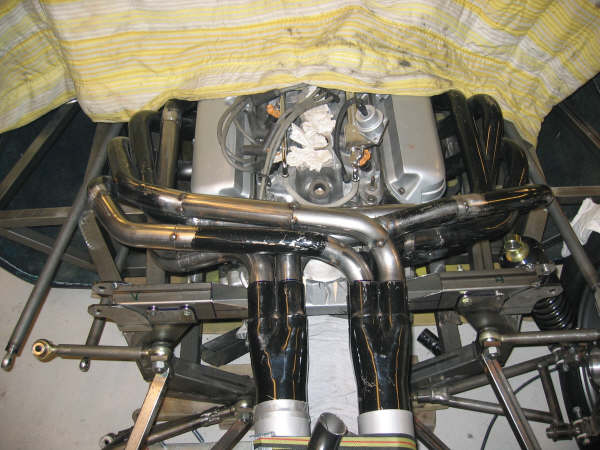

Or you can make it by yourself - much cheaper. I ordered a system from Speedwaymotors www.speedwaymotors.com + a couple of bends and put about 5 hours of work to a finished system. Not so fancy as a professional made but it will look OK when painted. Cost in total including silencers was less USD500
Br
Henrik

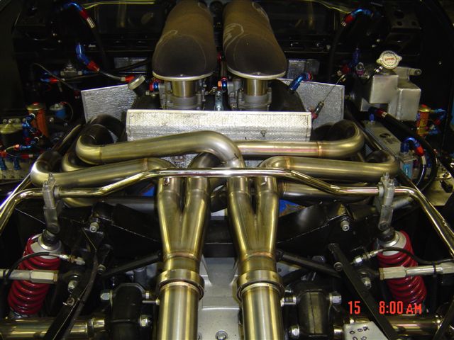

Simpson exhausts sent me this picture of the system they made for Adrian Neweys car (1 3/4"), this is one of the nicest I've seen & also the most expensive!

a very beautiful exhaust i take it the top of the prices you have been quoted it looks fantastic, have you made any choices as who to go with yet?
