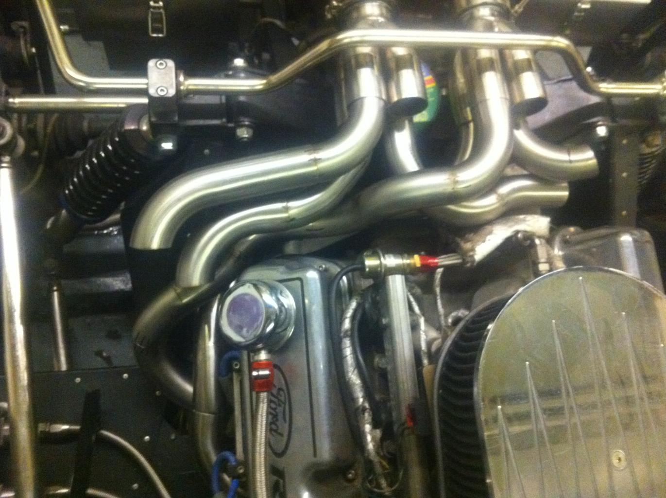

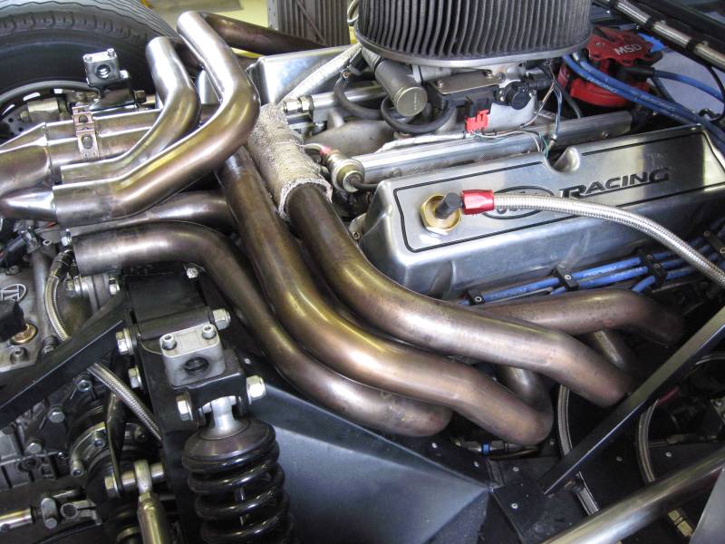

What is the result of the 351 firing order in place of the 302 ‘normal order’ and the variation in manifold/header length on the tone/beat of the exhaust note?<?xml:namespace prefix = o ns = "urn:schemas-microsoft-com<img src=" /><o:p></o:p>
<o:p></o:p>
My car has a Ford Racing 347 engine that has a 351 firing order and the exhaust system was supplied with the deal ( I heard the system on a 302, it sounded nice). The engine is running fine without misfires and on a rolling road gives 400+ hp and 380 Lb/ft. At a distance and on song everyone says it sounds great.<o:p></o:p>
However driving the car more normally, there is a distinct beat that is very wearing on longer trips and is more prevalent below 3000rpm when there is a more distinct flat tone and harsh beat to the note. The tone is a bit like a Subaru Impretza; there’s no shortage of urge it just is not nice.<o:p></o:p>
<o:p></o:p>

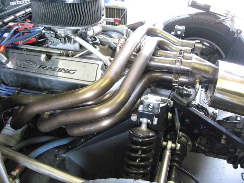

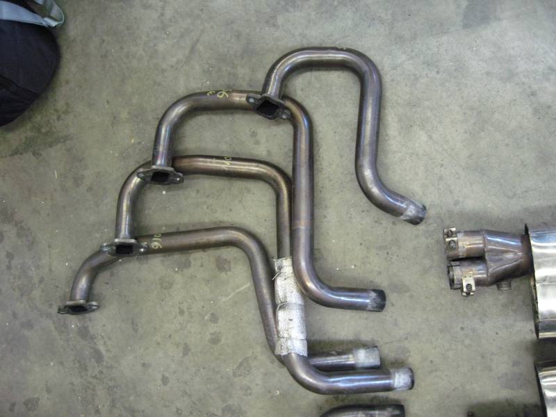

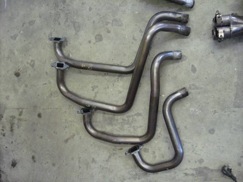

I have put some pic’s of the pipes and on the spread sheet I have detailed the firing orders and pipe lengths (measured for comparison with a nut and string) also the sequence of the collector events etc.<o:p></o:p>
It can be seen that #4 and #8 are the shortest pipes and with the 351 firing order are sequential in the firing order. If the pipes are half the length can this cause a double pulse effect at particular rpm’s that set up a resonance, would reworking the pipe lengths to be close to equal correct this effect? A 302 has two other cylinders fire between #4 and #8<o:p></o:p>
It can also be seen that the pulses on the collectors are dissimilar the RH pulses rotate clockwise and the LH in figure eight; would this have any effect on the exhaust tone?<o:p></o:p>
<o:p></o:p>
Short of starting again, my plan is to do Option2; swap pipe #8 and #5 in the LH collector and remake the pipes of #4 and #8 to more equal length to the others. What if any effects will this have on the exhaust note?<o:p></o:p>

Jim Rosenthal
Steve, without getting into the details of this, which you clearly know better than I do, the original pipes were set up with the two center cylinder pipes crossing over- this worked with the old SBF firing order. What about changing to a camshaft with the original firing order- wouldn't that be easier than remaking the pipes? I think the 351 firing order is the same as the updated SBF firing order, isn't it?
In attached drawing of both firing orders, note that if you flip the 13726548 order from top to bottom the firing order pattern is exactly the same as the early 15426378 order, so the motor doesnt really see this as different & neither should the human ear, the only thing the motor 'feels' is the loads imparted to the crankshaft & bearing which is exactly why Ford went to the later order.... I think the sound difference you hear might be due to the rather large spread of primary lengths, but could be due to a combo of this plus other factors like muffler, cam , plus possibly a balance issue in the rotating assy. I should also point out that the modern practice of dumping the collector into the muffler without adding a tailpipe length is fundementally flawed, the correct way is to either build the appropriate tuned tailpipe length into the muffler as per Russ Nobles first muffler system or do it like 'Dimi' did on his DRB, or better still go with totally un-PC open pipes.

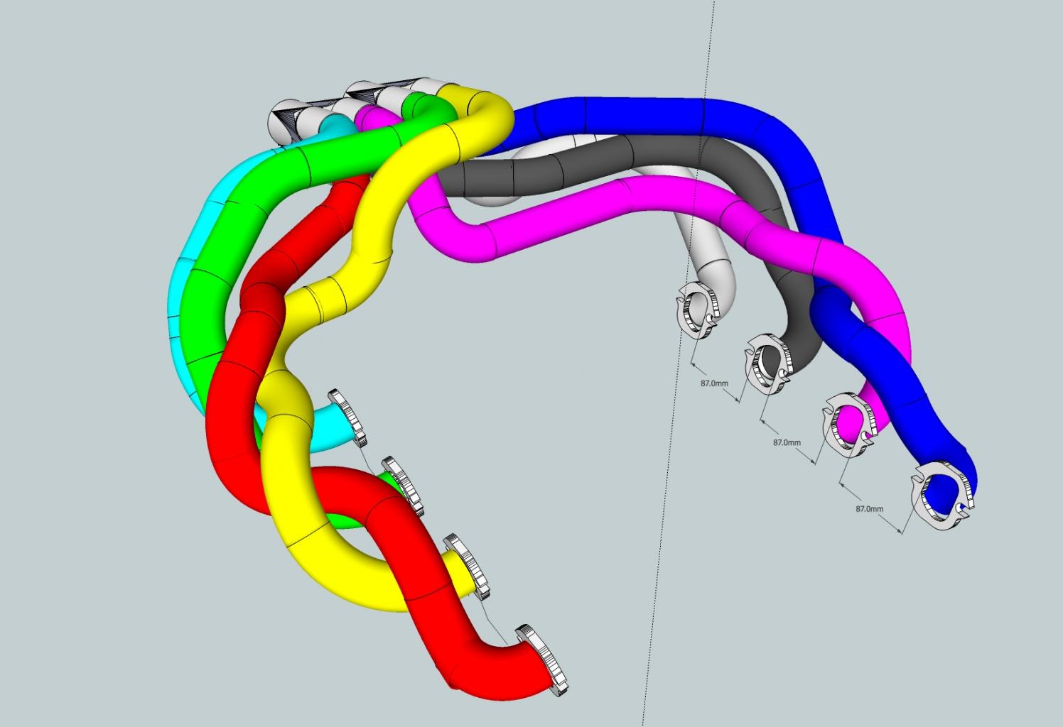

Great posts guys, really helpful! I think have read and understood everything but i thought i would post and ask what you all thought of this as a design for the headers on mk1 replica?
Also does anyone know anywhere i can buy 1 3/4 inch stainless steel tubing in pre bent sections?

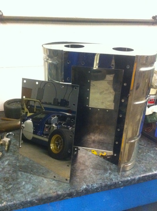

This may be slight thread drift, but I'll ask the question anyway - what's the effect of putting a catalytic directly after the collector? Most of these cars are so space constrained that if you need a catalytic to pass emissions, there's no other place to put it.
Also, as I understand it, a chamber muffler acts as a termination for the exhaust pulse, whereas a muffler which uses a perforated tube surrounded by wadding acts more as a megaphone.

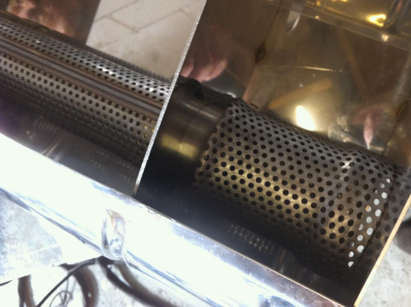

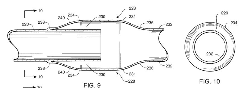

This pic of an anti reversion exhaust pipe may help. The physics of pipes is that a gas in a pipe behaves like an organ pipe and it will set up a standing wave inside which can have a fixed set of natural frequencies. The standing waves can be so that the fundamental frequency is for there to be a quarter of a wave in the tube with a node at the port end and an antinode at the open end. There are further overtones at 3/4 of a wave in the tube, 1 1/4, 2 1/4 etc. The exhaust pulses set the gas resonating.
Additionally when a positive exhaust pulse hits the open end of the exhaust a negative pulse is sent back up the tube. The idea of a tuned exhaust length is that thsi negative pulse arrives at the exhaust valve just as it opens and this pulls the gas out of the cylinder.
This is all a bit too simple for the reality of the situation as we have the additional issue of the gas actually moving down the tube at a range of speeds and the fact that the gas temperature varies constantly. The speed of sound in the gas is therefore constantly changing so calculation becomes impossible without using a powerful computer and cfd. The engine sends pulses in a continuously changing range of frequencies. The pipe can only resonate at certain points in the range where the frequency of the exhaust pulses match the natural freqency of the pipe.
To all intents and purposes we are left with trial and error.
The anti reversion idea is to try to prevent the gas in the exhaust moving back up the exhaust tube by creating a kind of one way valve. I think they do work but are better at low rpm or where large resonances are set up in the pipe.

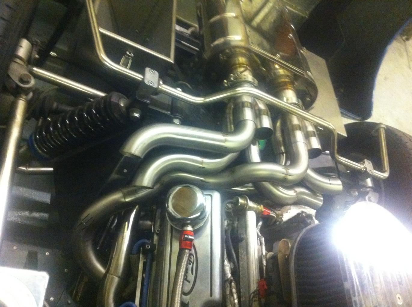

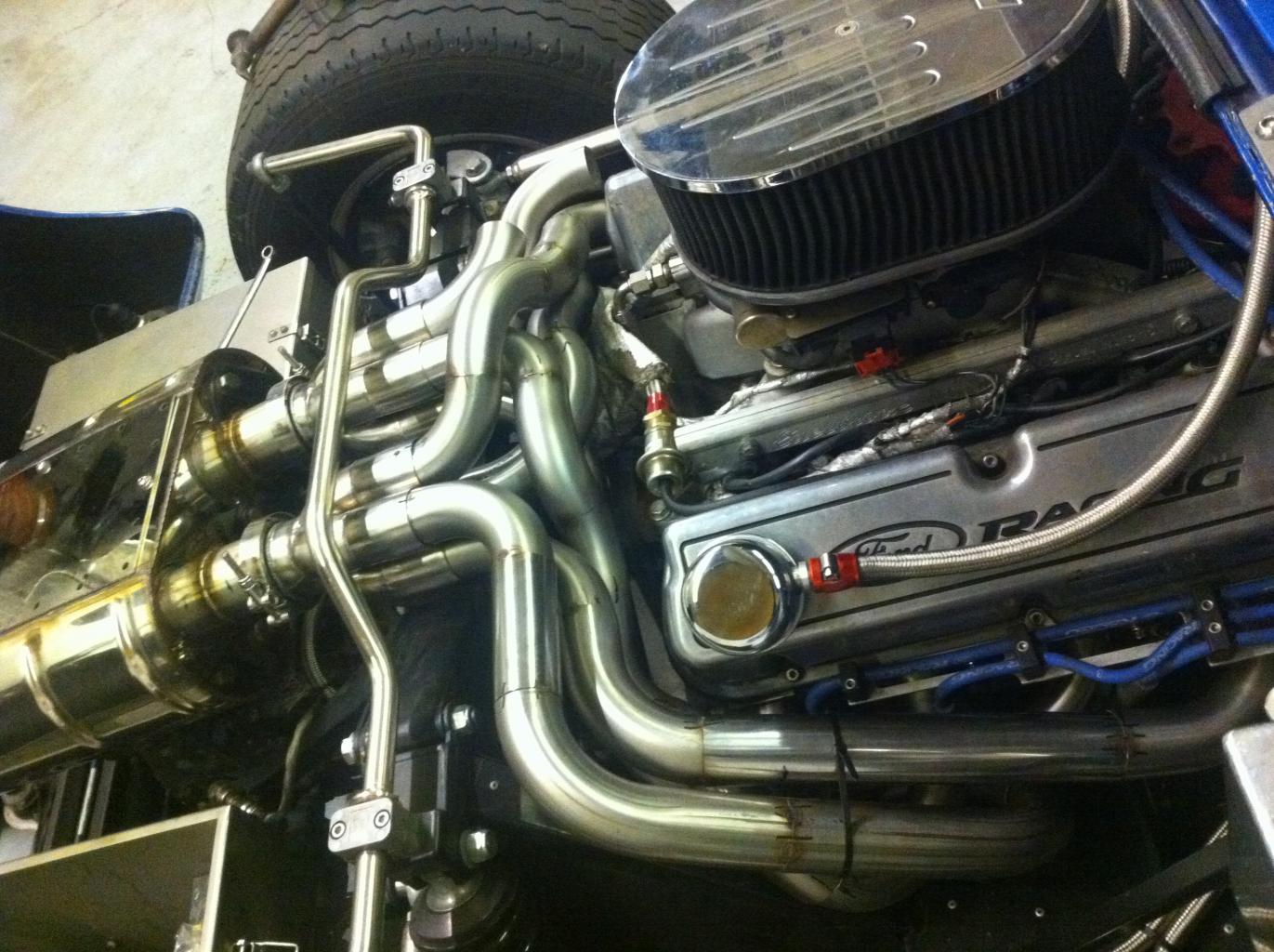

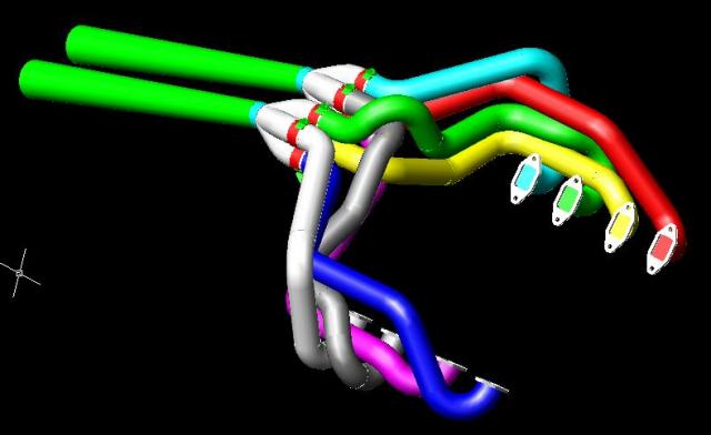

I have thought long and hard to justify remaking the system on my car, that had me start this thread. The original worked fine but had an odd back beat that sounded quite flat with the configuration of my Ford Racing 347.
The old stainless system is now looking for a new home!
The pictures show the start of the new system that will be built to be like the MkII in 'Adam's posts with the primary tubes as equal in length as can reasonably done. The collectors will be made to rotate the firings. From each of the two 4-1 collectors the two entries into the single silencer will be into anti reversion chambers for each with cone ends to feed into the main perf pipes through the silencer. The silencer box will be repackable. If I have the theory right the anti-reversion chamber acts as the first low pressure area and the remainder of the perf tube and tailpipe act together, I will make the tailpipe as long as practical.
It will be done in time for the Isle of Man Classic I hope.
Steve

Looks interesting with the equal primaries and circular firing in the collectors being the main features. I am not sure if the anti reversion effect will work well with the combined pulses after the collector. The anti reversion is usually applied in the primary pipes where there are more clearly defined and separated pulses and there is more opportunity for back flow to happen. However it won't do any harm even if the full effect doesn't operate.

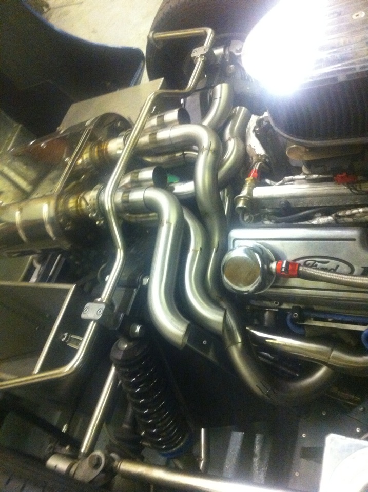

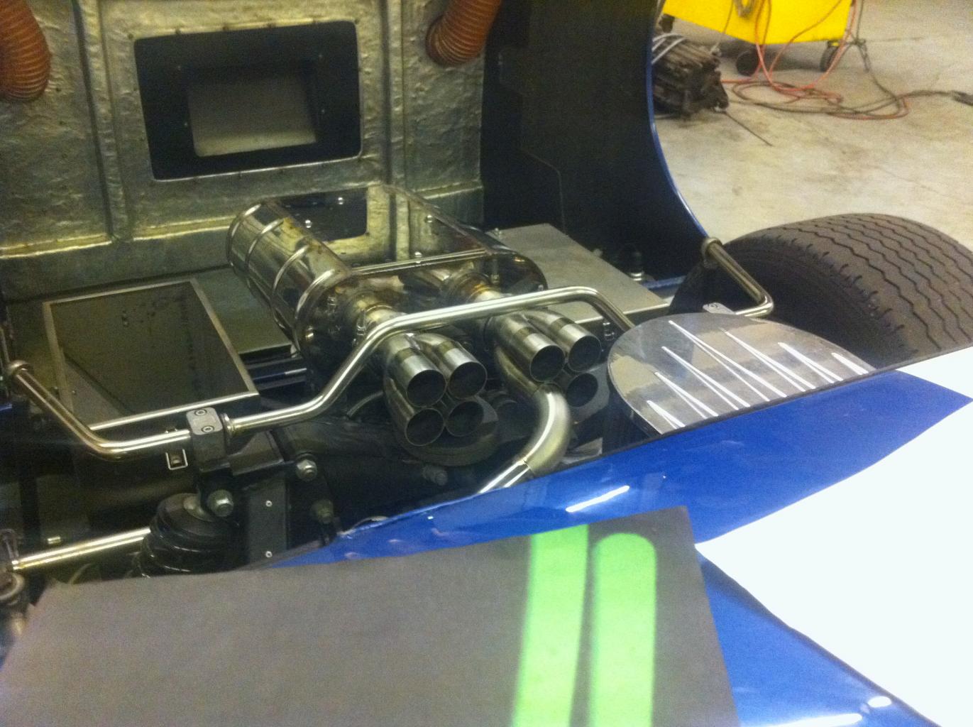

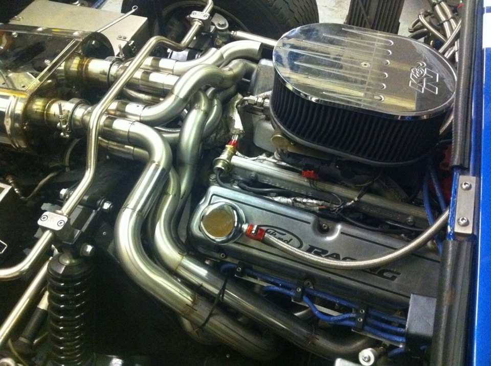

More progress, here are a couple of shots as the system builds up getting a bit complex now.
Looking forward now to how it will sound and run with the revised layout and pipe lengths, it will be soon.
Steve
