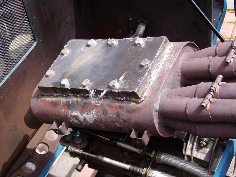

I guess this'd be why then...... (see pic)
Simon
Incidentally, it's built out of steel thick enough to build a battleship from (well...almost) /ubbthreads/images/graemlins/smile.gif

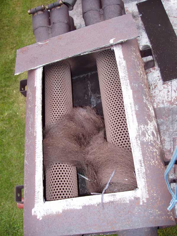

I've taken the plunge and ordered two rolls of exhaust "wrap" that goes around the baffle and a bag of loose wadding to fill up the void. Will let you know how it goes.
Simon
Update:
Finished re-packing the exhaust and fitting my removable "door" (please don't laugh at my welding)
Hell of a difference! Still loud (big lumpy cam) but MUCH better than before, it's taken the hard "edge" off the exhaust note and turned into a loud rumble. Hopefully it will stop me getting a headache every time I drive the car.
Simon

I have always used the Merlin Motorsport exhaust packing. It is about 10 GBP per square meter. I think it is called E Glass. A repack lasts about a season for me and I get a couple of sq metres at a time. I pack it in very tightly.
The higher the rpm you go the quicker the wadding blows out. Over 5000 rpm seems to be a break point for accelerated exhaust wear!
The wire wool I have used in the past just melts. Once I blew one of my covers off and the wool was just glowing bright cherry red. HOT!
On making the covers for access to repack, I cut my hole with a grinder but chucked away the off cut. I had my local supplier cut me new covers that made a 1 inch overlap all round so there was no need to make a raised bolting down platform. I then used large 5mm self tapping screws with bolt style heads and cut them in using some oil on each initial use. Some exhaust sealant could be used but I found that the 1 inch overlap sufficient to get me through RAC scrutineering.
Just another way of doing the same thing I guess!
