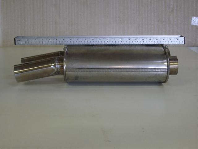

After lowering my engine, the stock CAV muffler exhaust tips were too high in the body opening. A quick slice and weld in 2006 lowered the angle of the tips and re-centered them. This is an easy cosmetic improvement that just makes the rear of the car look more balanced.
