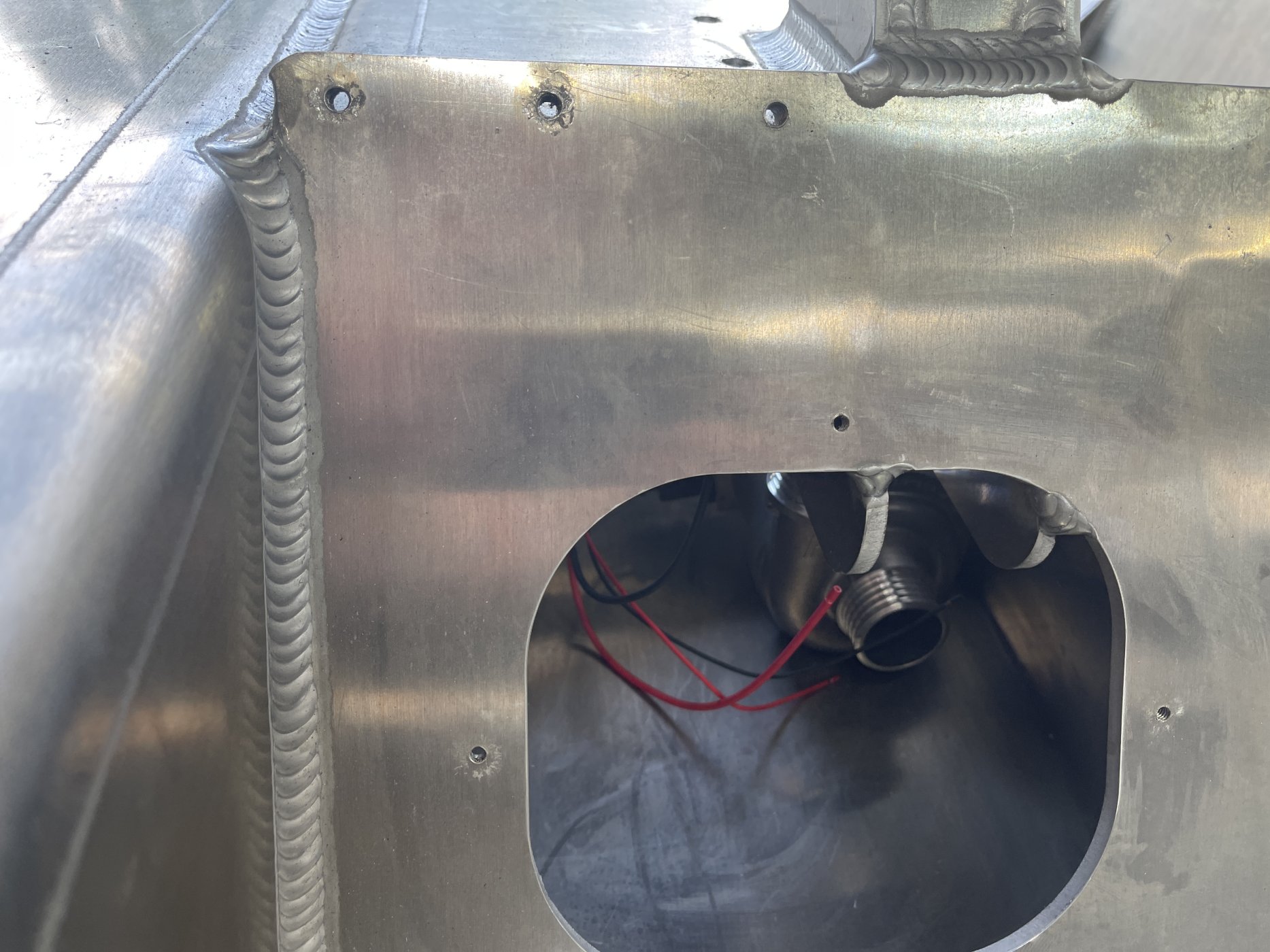

I am going with the Pierburg 400 as well. I saw a YouTube that compared the CD to the PB and the PB won. The DC flow rates are measured with no pressure whereas the PB includes pressure in their measurement. I plan to tuck the pump inside the sponson under the four link mount.
