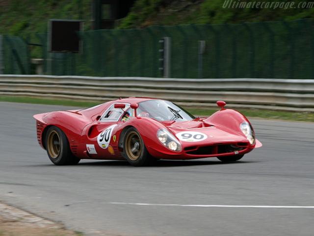

You know Fran still has that 512 S replica sitting around... If I had that motor, THAT'S what I'd build. Oh wait, also need the $$$ for it. Might wanna give him a call about it.
mmmmmmmm......
