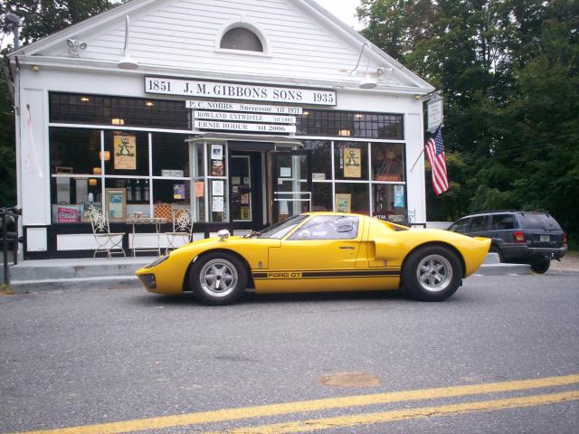

Dylan,
Call me.
The roads have not been salted/sanded yet.
I'll give you a ride in a 2100lb car with 385 HP.
Just make sure you wear a "Depends" for the resulting incontinence!
Just to wet your appetite for the future....
Cheers,
Scott
