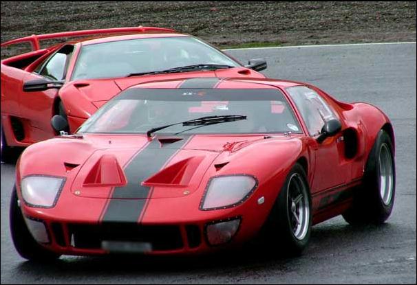

Engine was fine, but the car seemed quite twitchy on right handers (most of the track /ubbthreads/images/graemlins/grin.gif) trying to be as smooth as I could, I could feel the back end kinda giving way and I had to steer out of it and keep it slow. So while I could drive the car and give it head on the straights, the corners were tricky. Here's where I found out how soon not to wellie it out of the hairpin /ubbthreads/images/graemlins/blush.gif

Sounds like you had a grand time. I think that driving in the wet will sharpen your skills and knowledge of your car much quicker than driving only in the dry. However hairy it might be! That is a good action shot you posted!

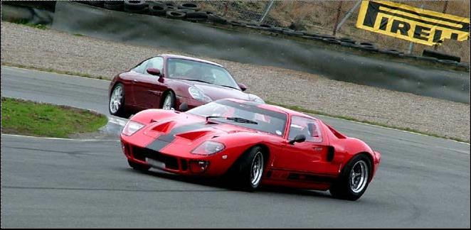

Here is one of my favourite pics, but don't mean to imply that my marine engine was able to hold a Diablo on the straight that followed /ubbthreads/images/graemlins/grin.gif
