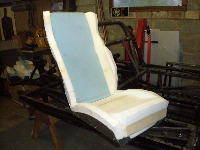

I used a local upholstery supplier, Comfort Zone in Thetford, who were extremely helpful. They can supply different grades and they recommended the base & back in the blue grade and the sides in the yellow. Have a look at their website as they have information on the different grades & uses etc.
Comfort Zone : : Comfort Zone Contact us
They provided the basic shapes & I then tailored them to fit
