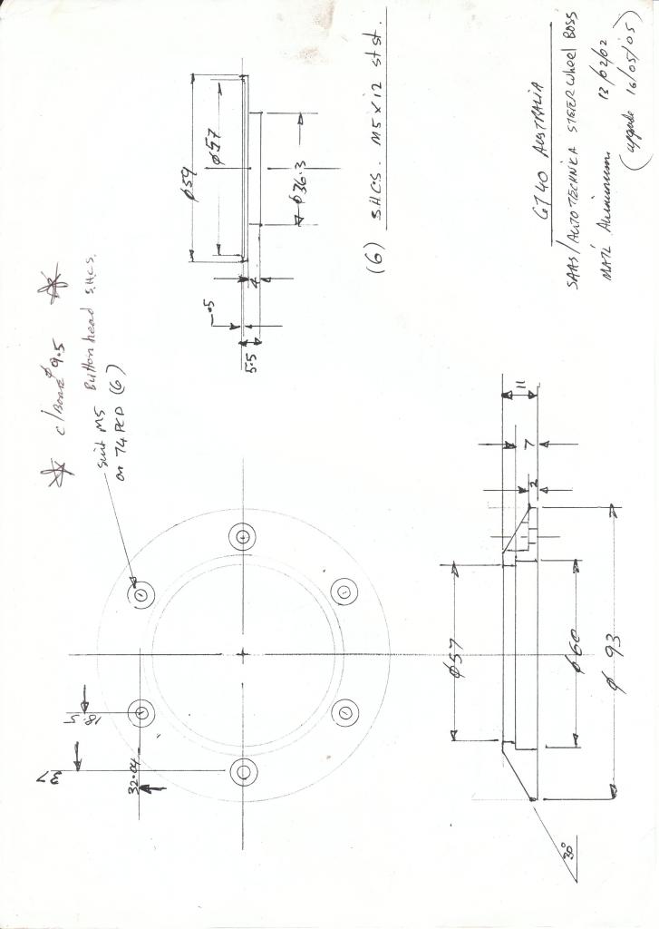

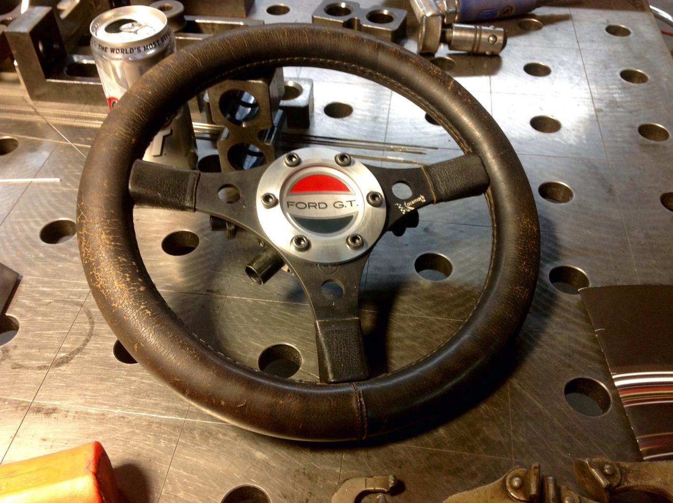

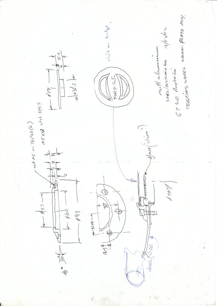

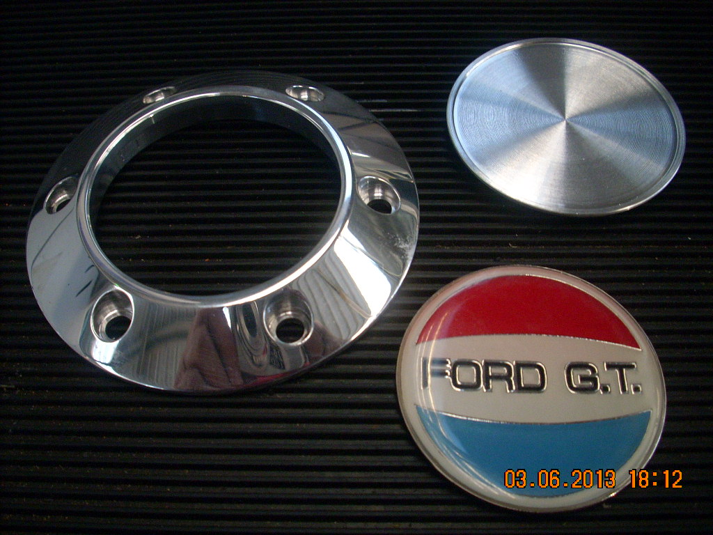

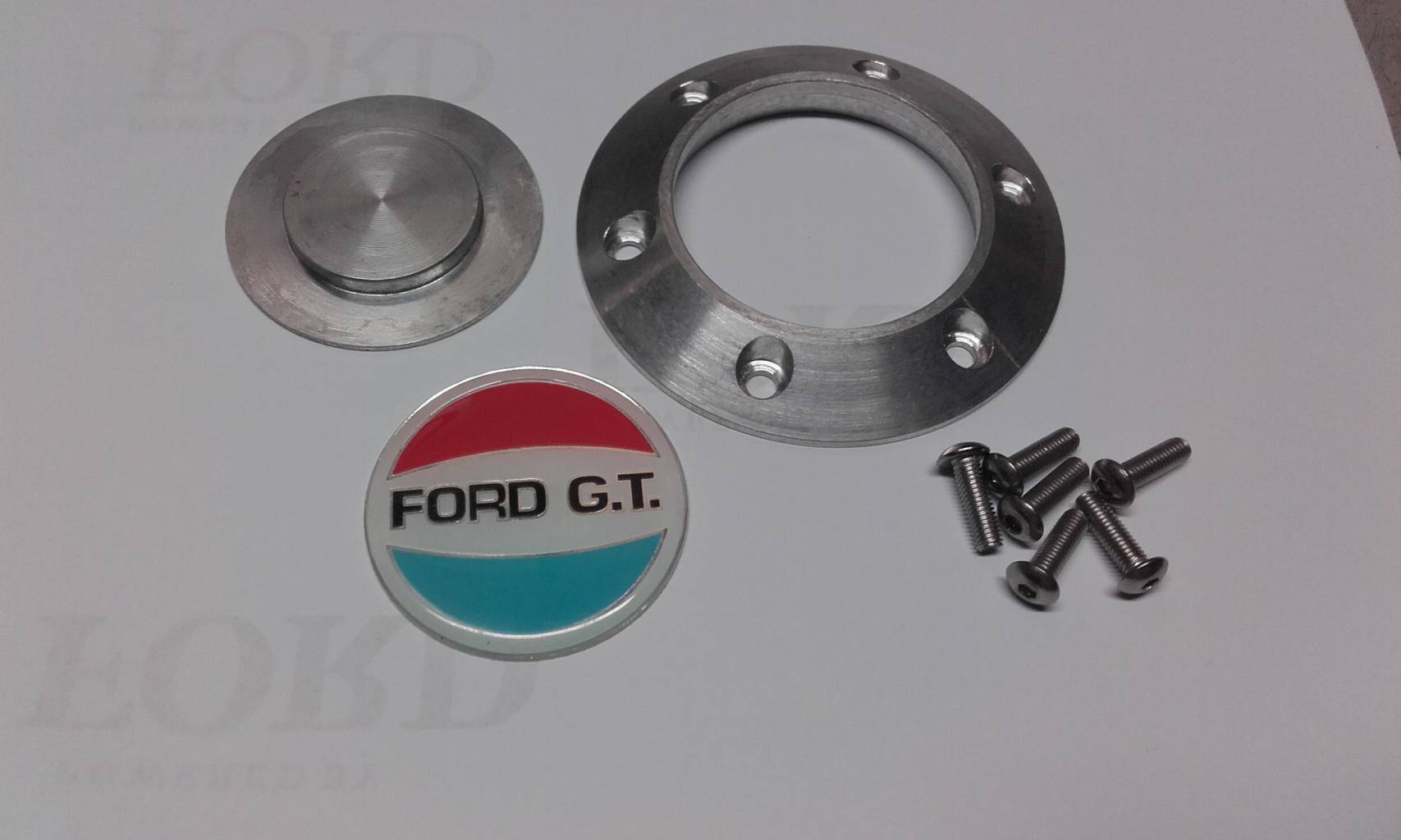

flatchat(Chris) Supporter Dec 17, 2015 #22 For the DIYers --for SAAS and Autotechnica Swheels Attachments IMAGE0073.jpg 49.6 KB · Views: 386 GT40 horn badge and bezel 017.jpg 236.9 KB · Views: 381 IMAGE0072.jpg 49.8 KB · Views: 393 Last edited: Dec 17, 2015
