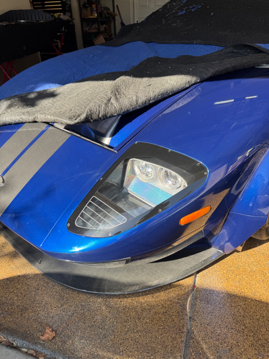

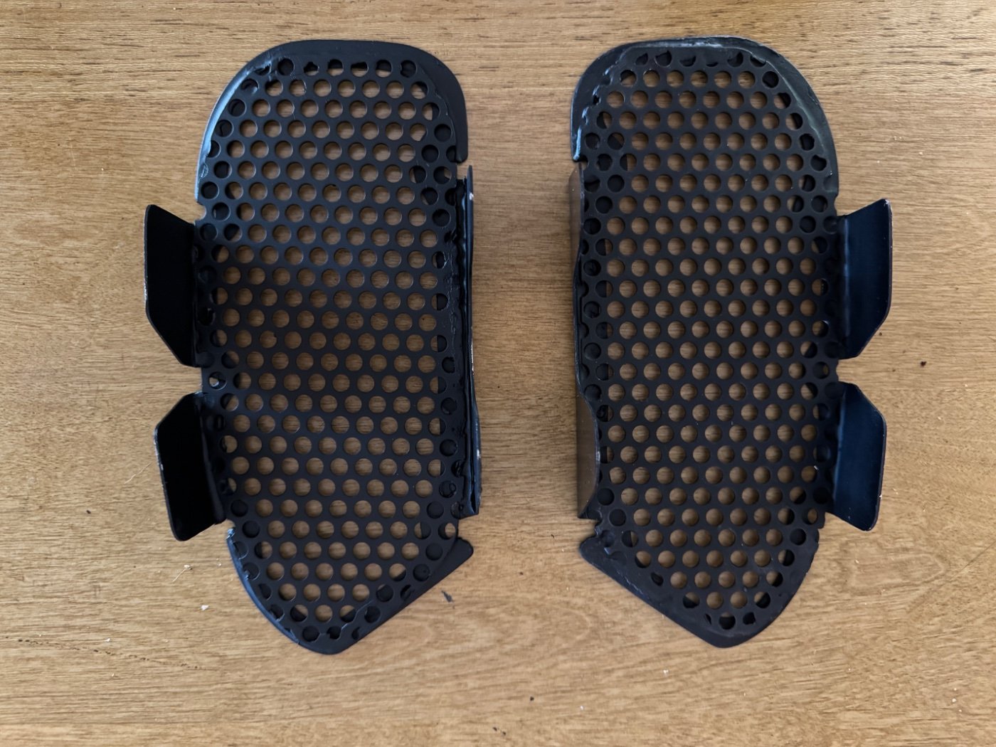

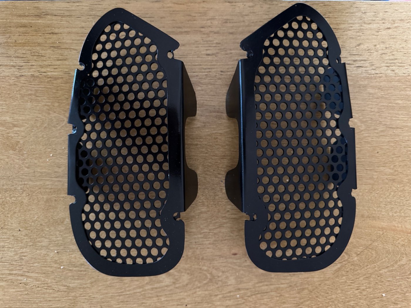

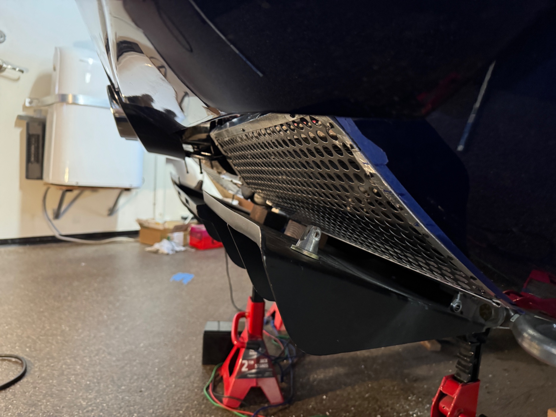

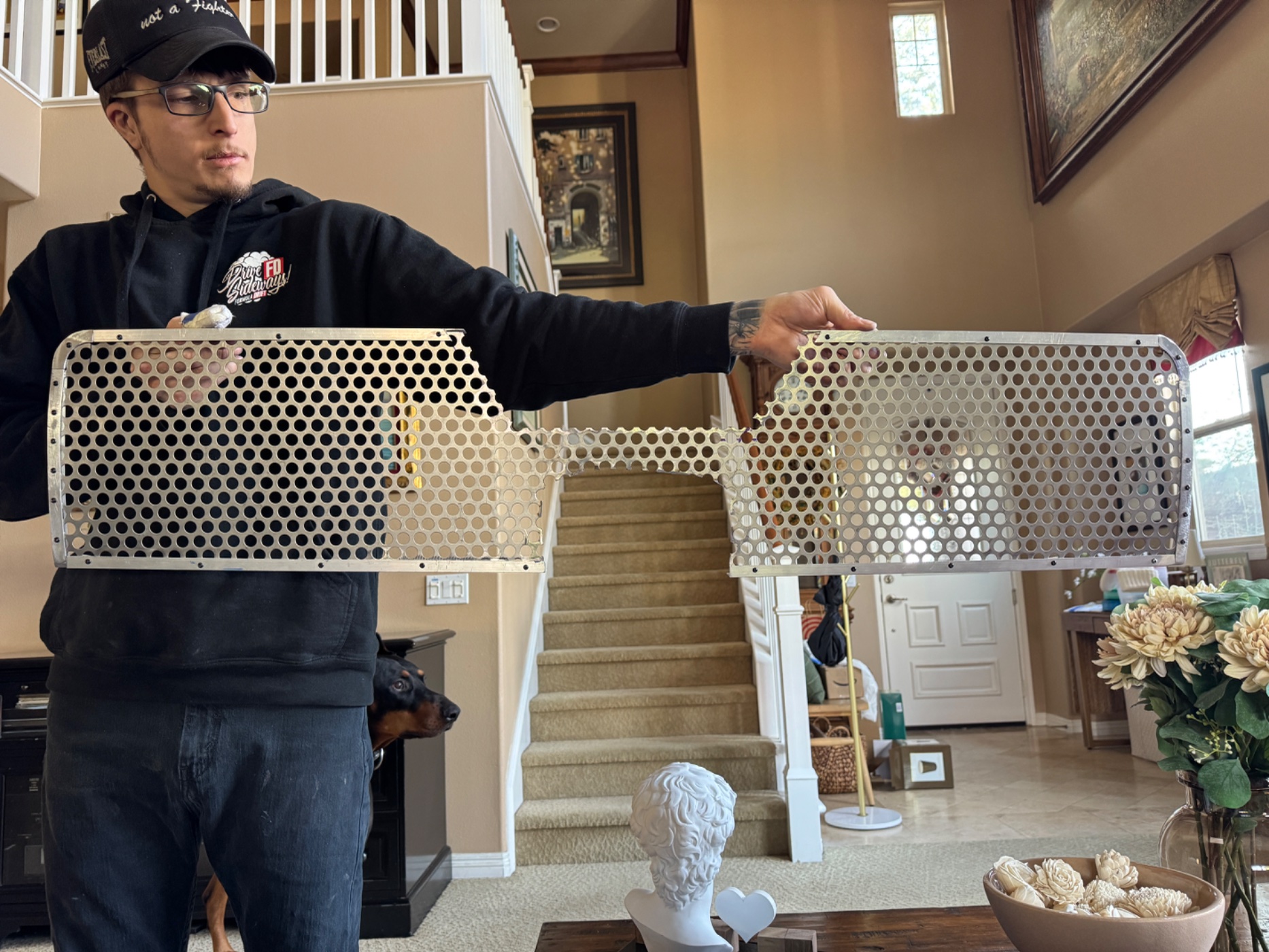

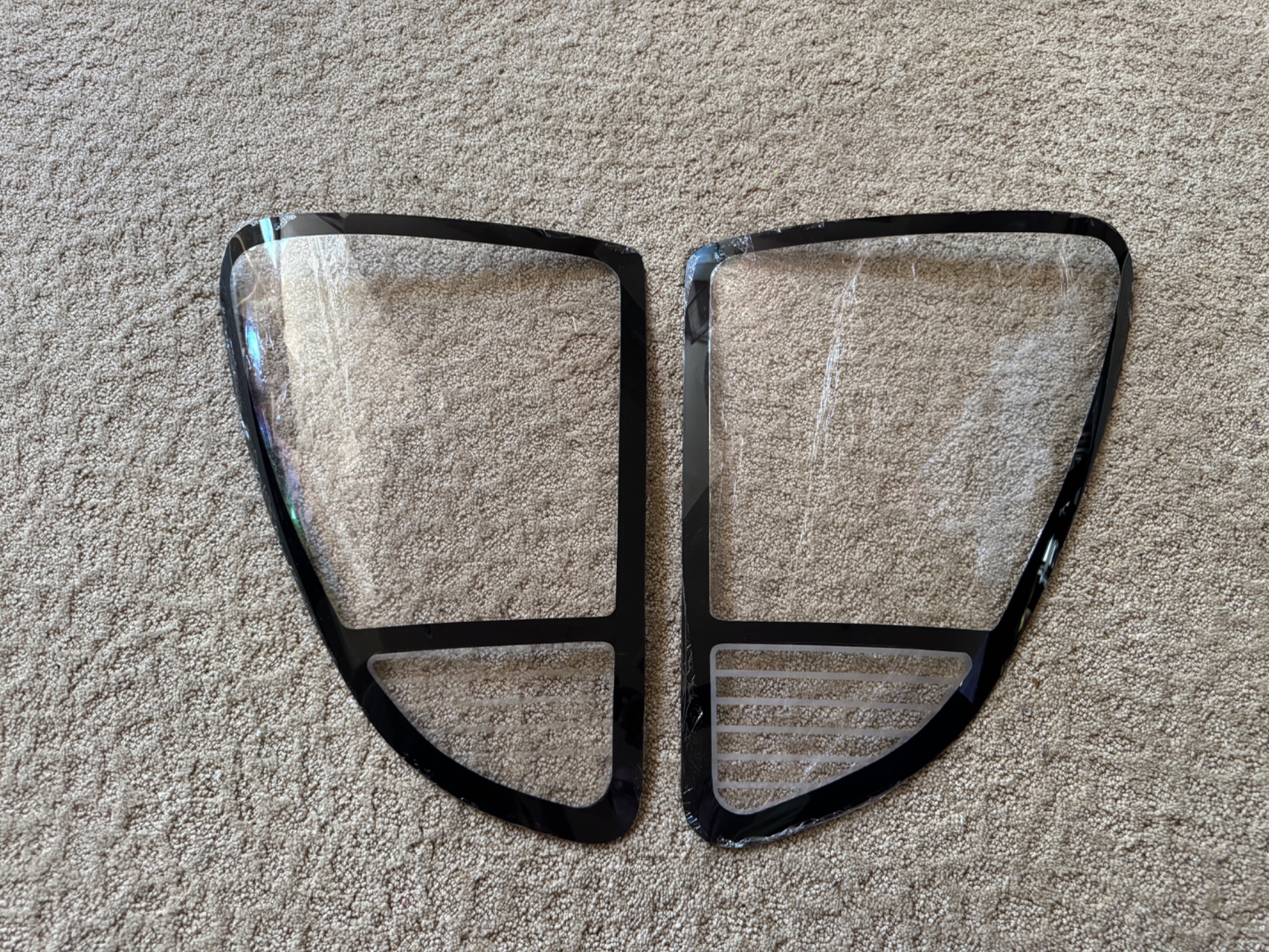

I made these grilles for anybody needing them.
They are the exact size to the original air scoop grilles used on the left and right scoop of a factory Ford GT. These have the same 1/4” hole size but the hole spacing is slightly different
Please contact me if needed.

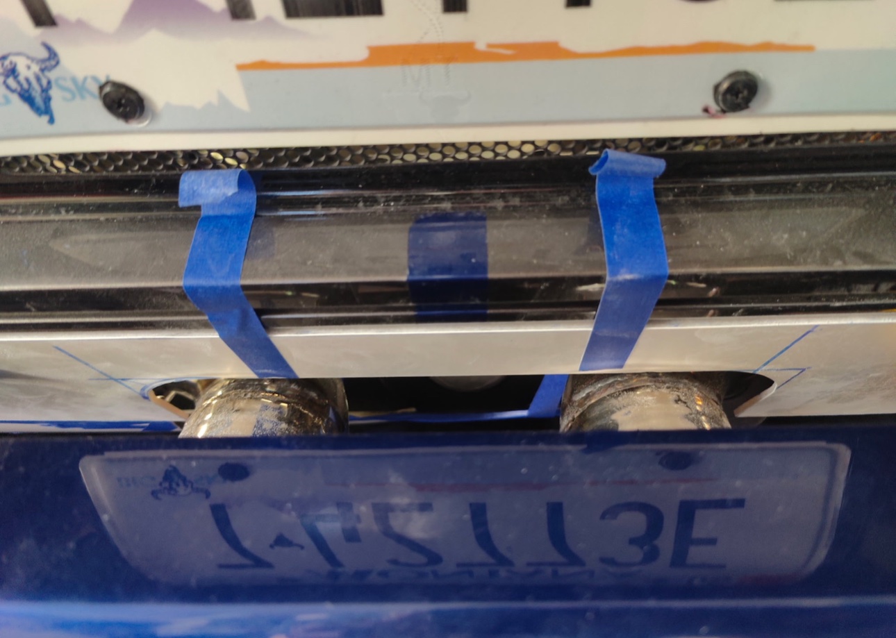

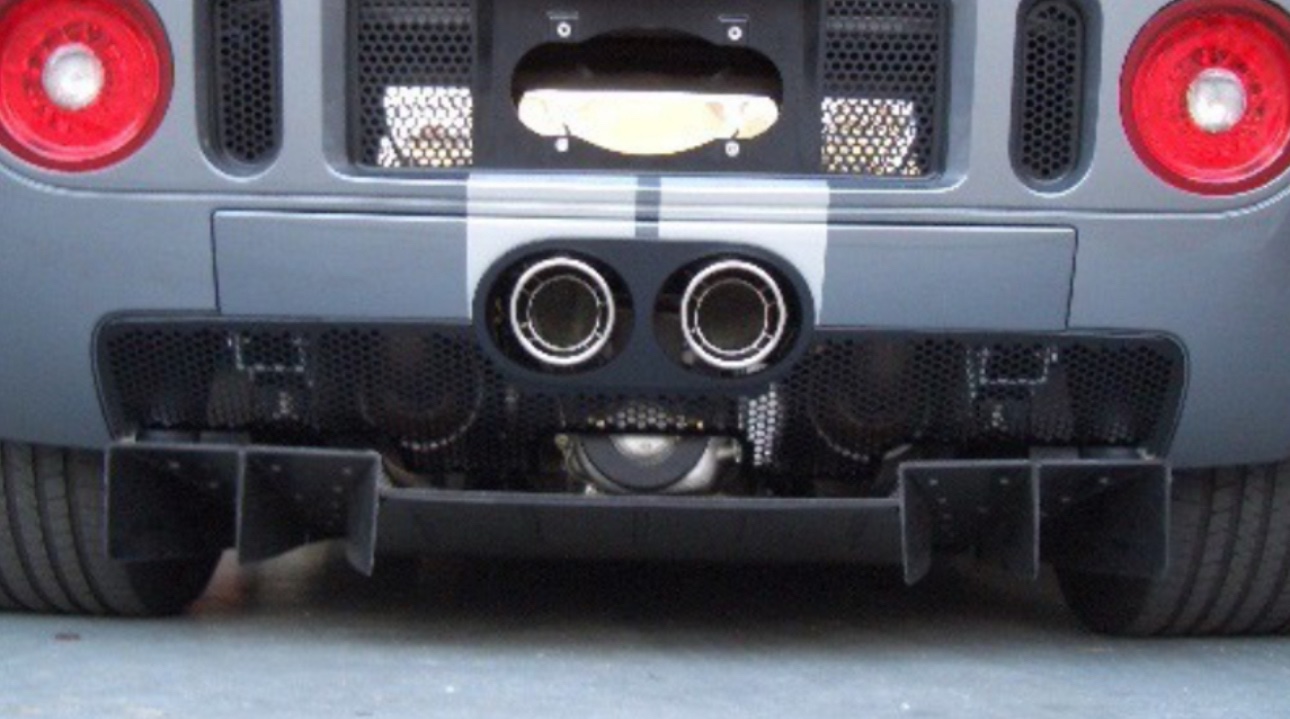

Building a back grille for the tail with a delete plate as well. The Ford GT shows what the delete plate does.

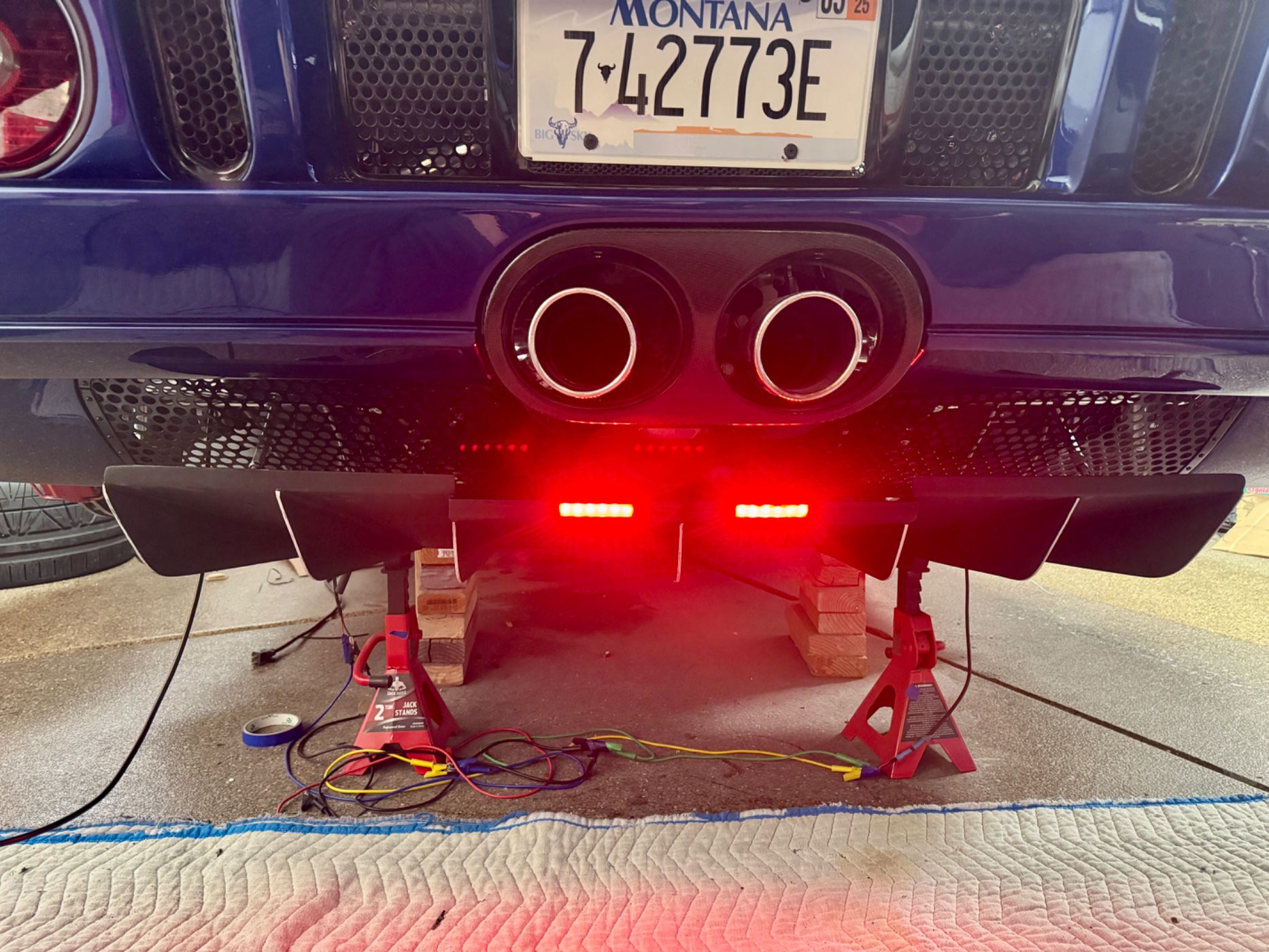

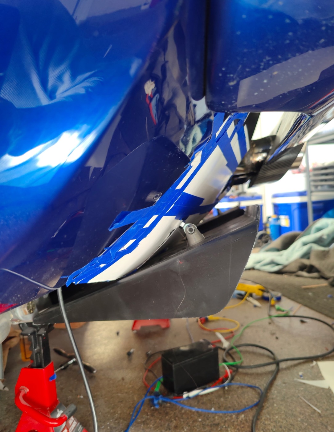

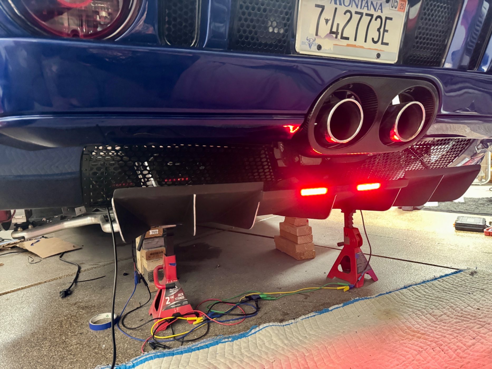

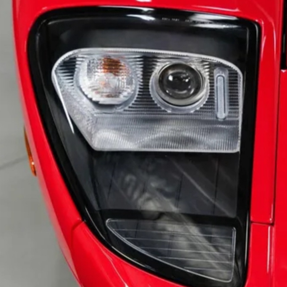

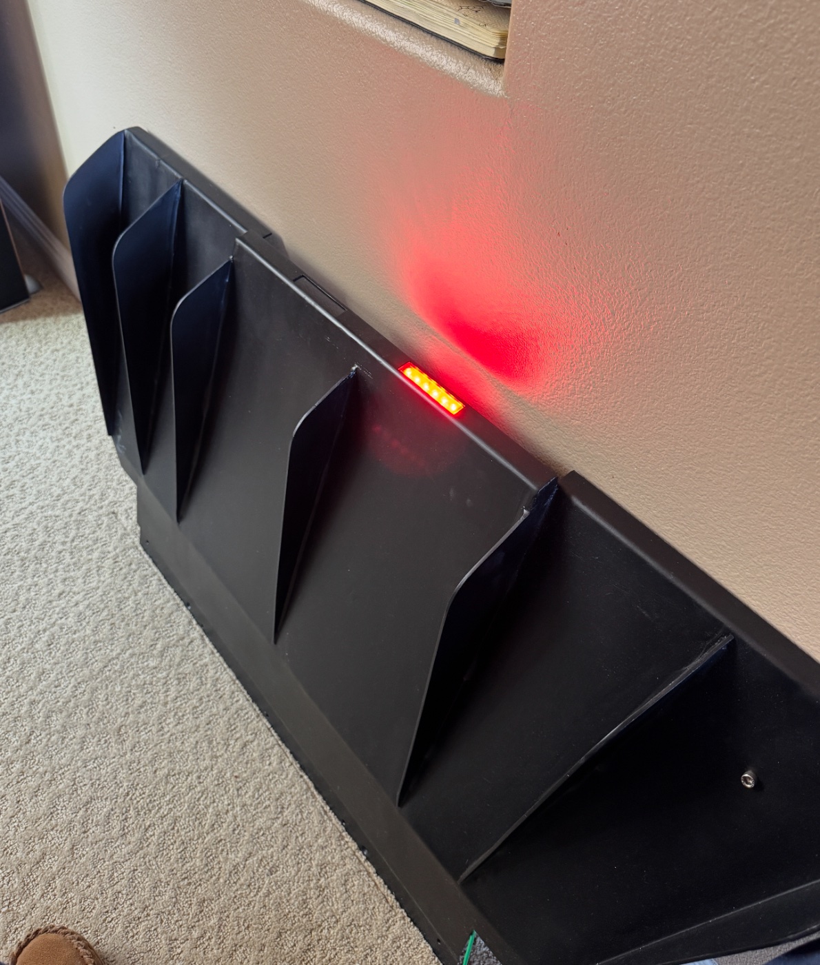

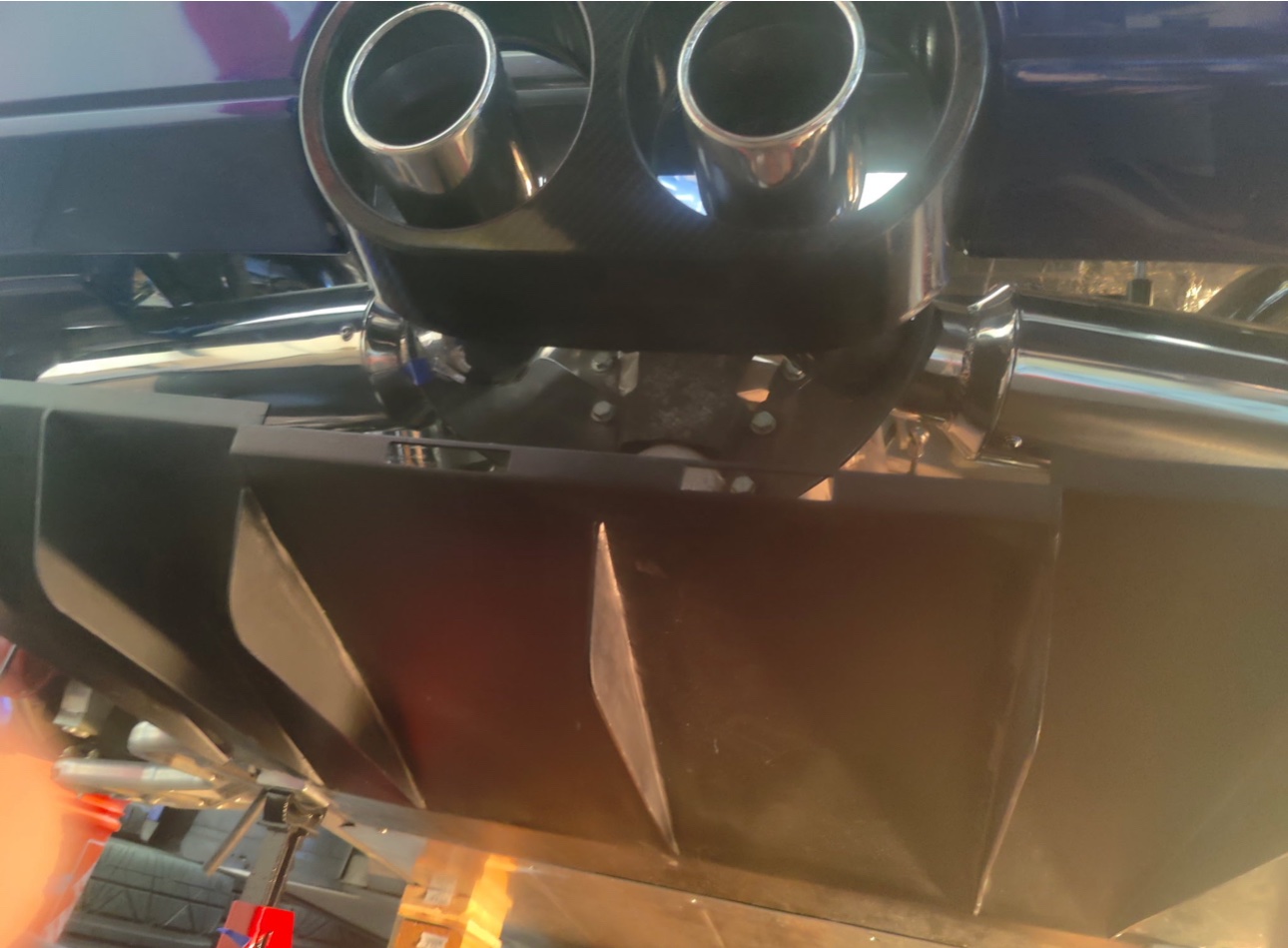

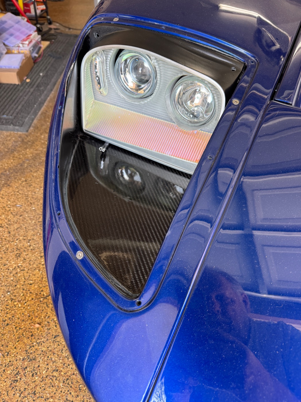

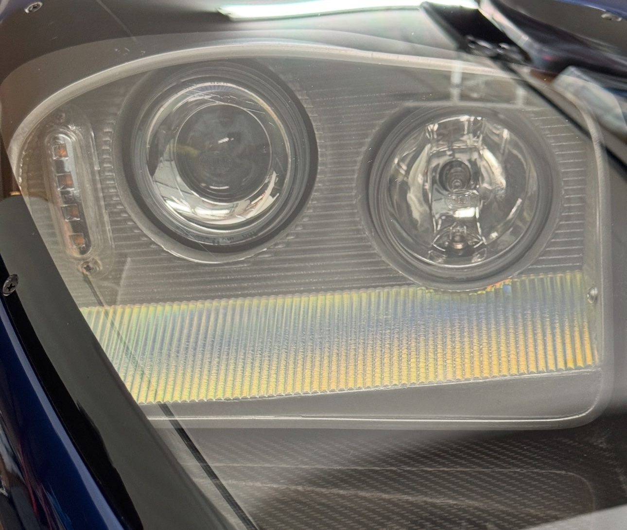

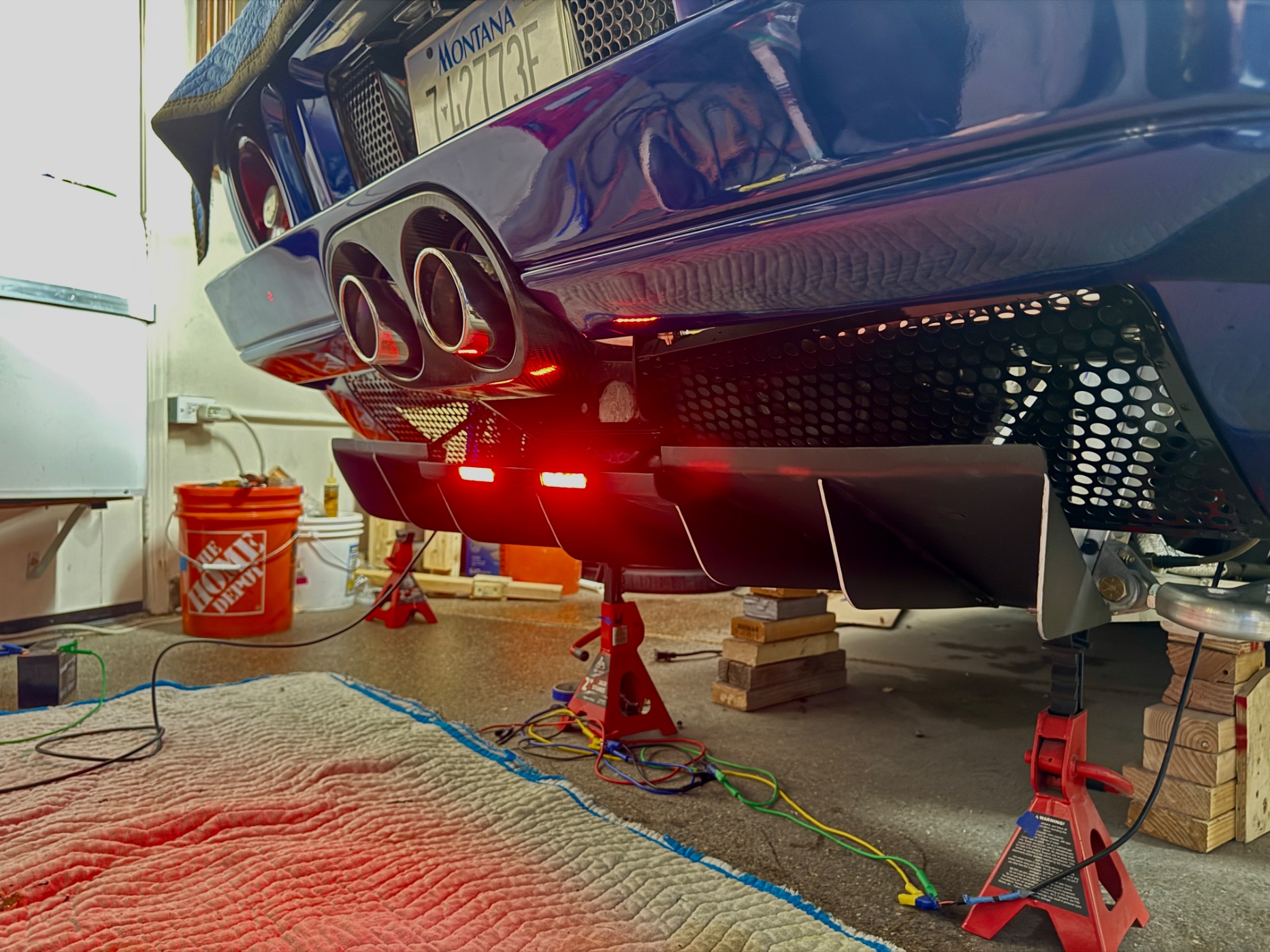

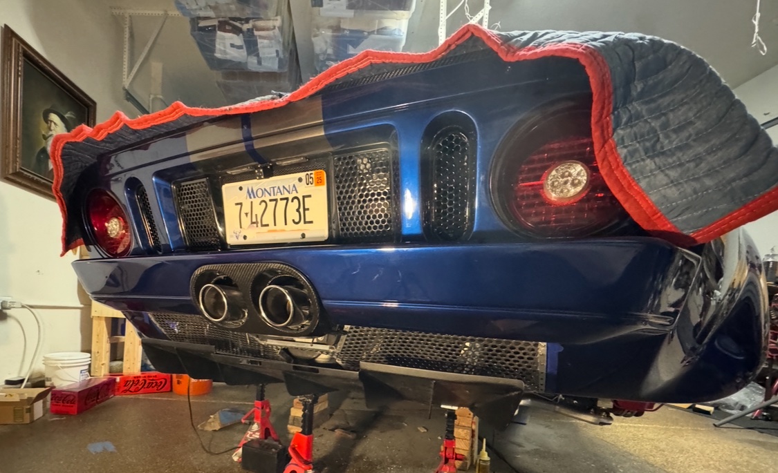

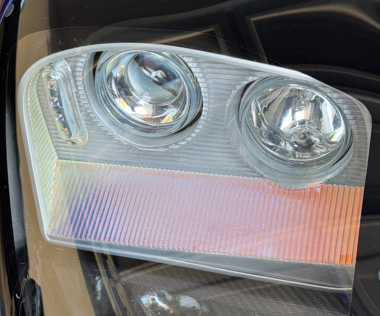

I custom built a new diffuser that is 8 inches wider that the typical diffuser. I also installed custom rain lights the phot shown is of the first of two lights installed

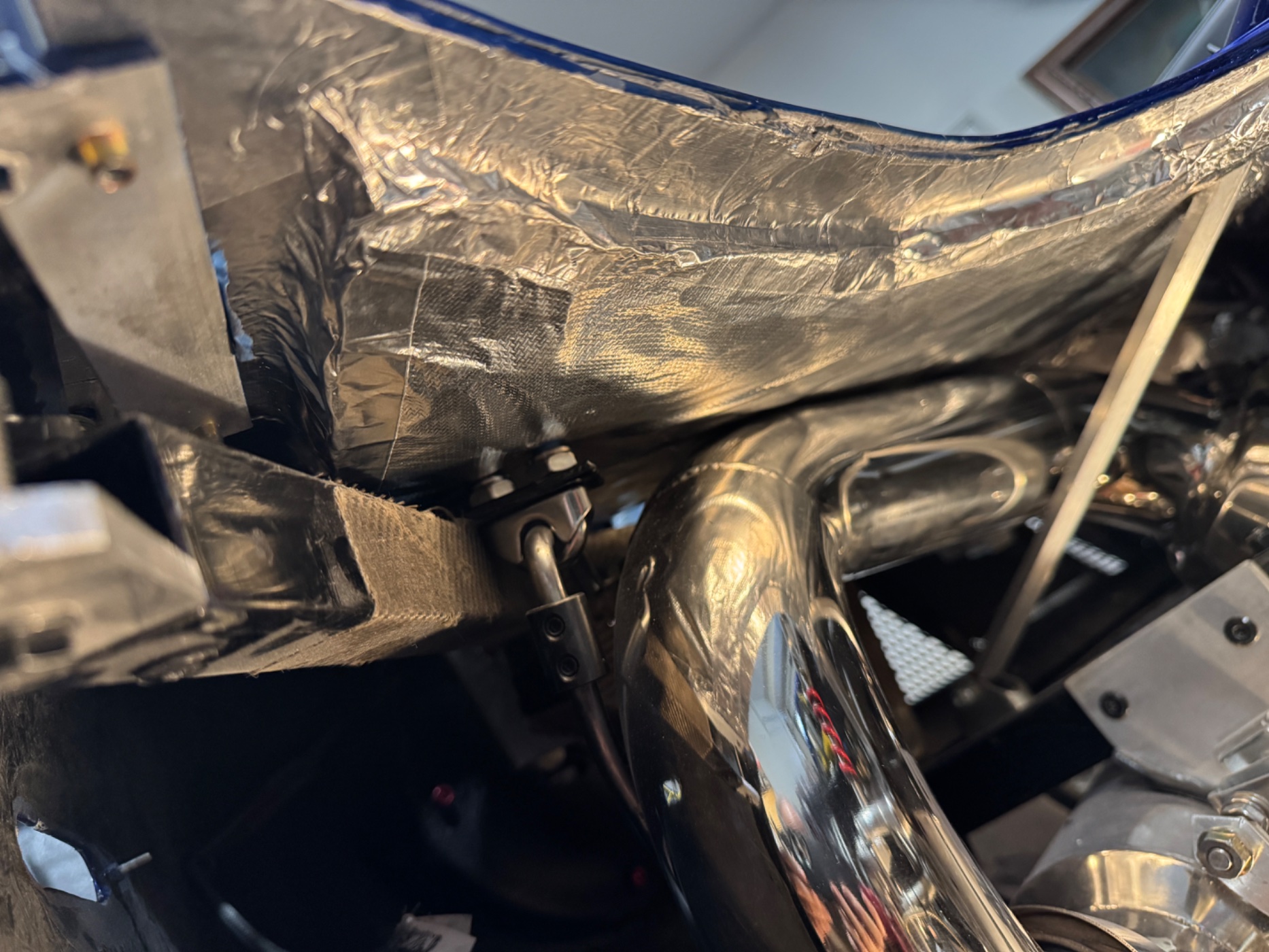

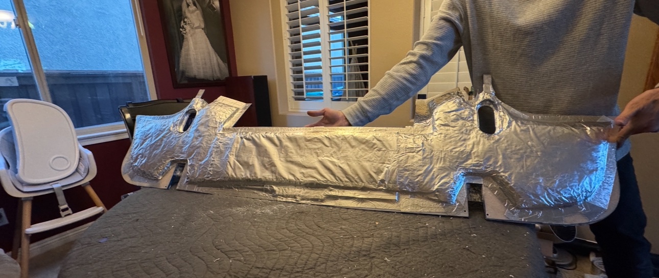

I custom built a partial carbon fiber heat shield installed over the exhaust. The shield is blanketed with 2500 degree material on the bottom of the shield.

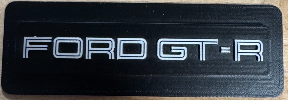

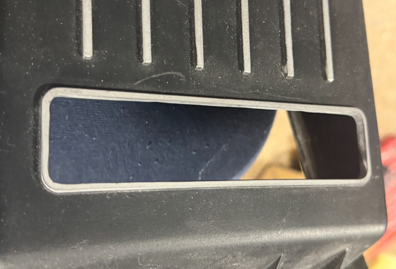

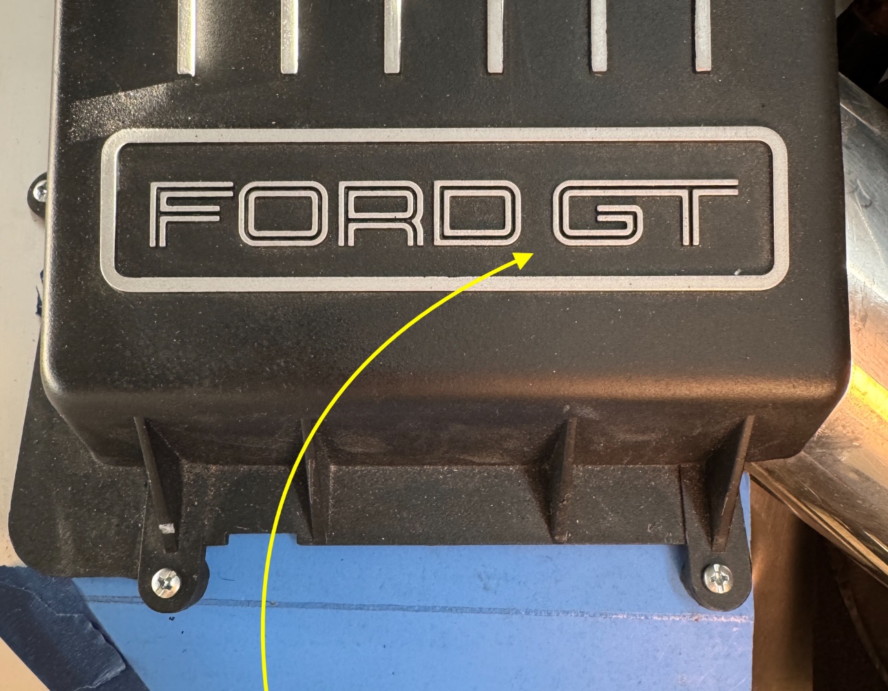

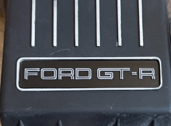

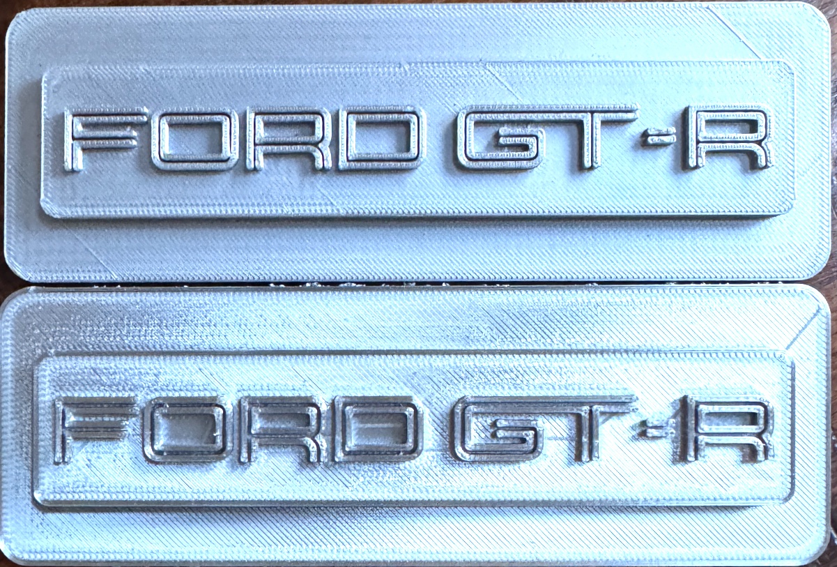

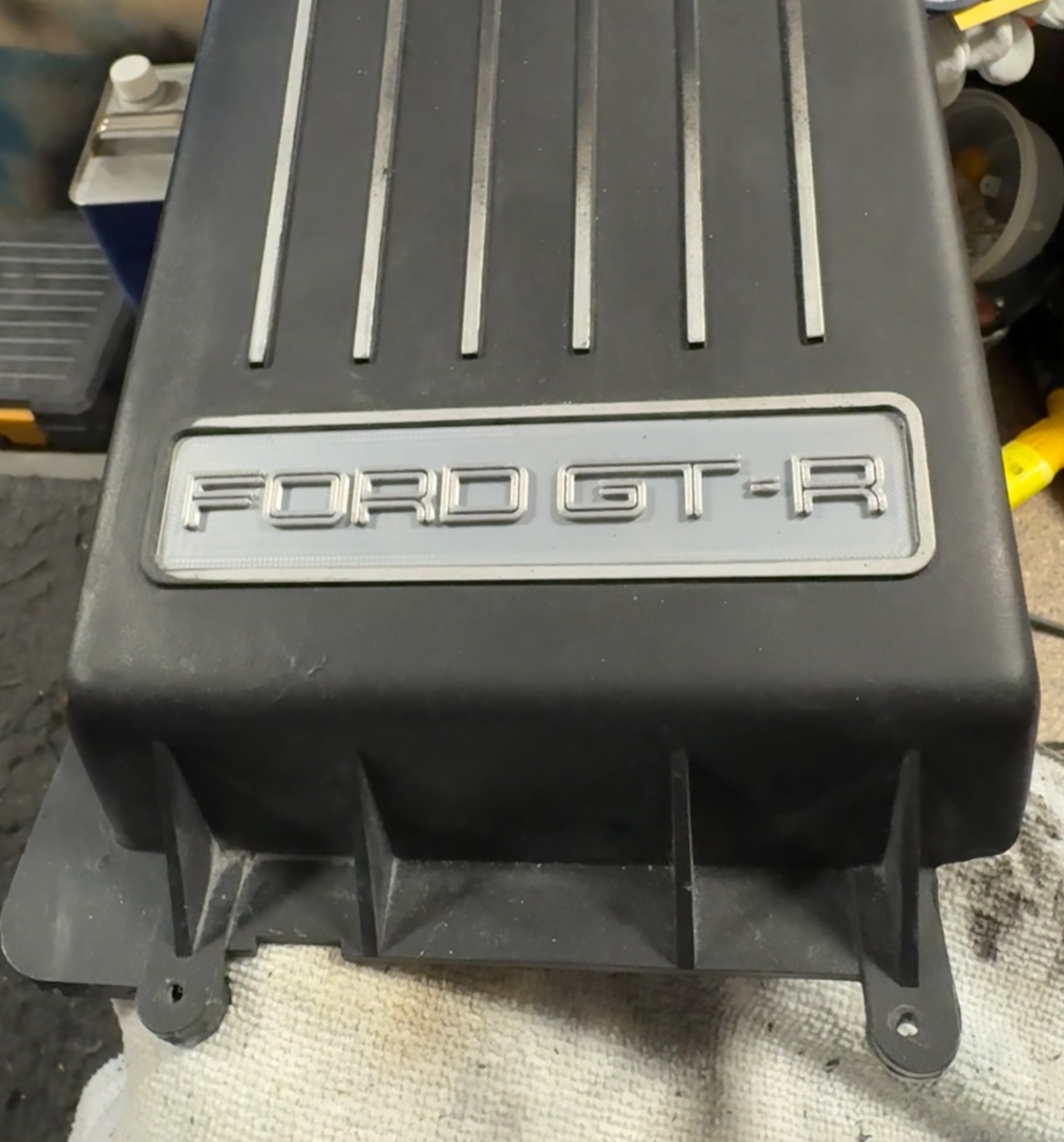

I 3d printed FORD GT-R placards that are designed to fit into the cut out FORD GT emblem on the intake airbox.

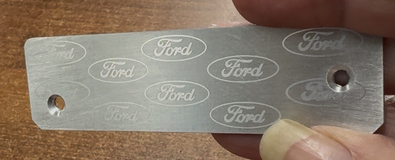

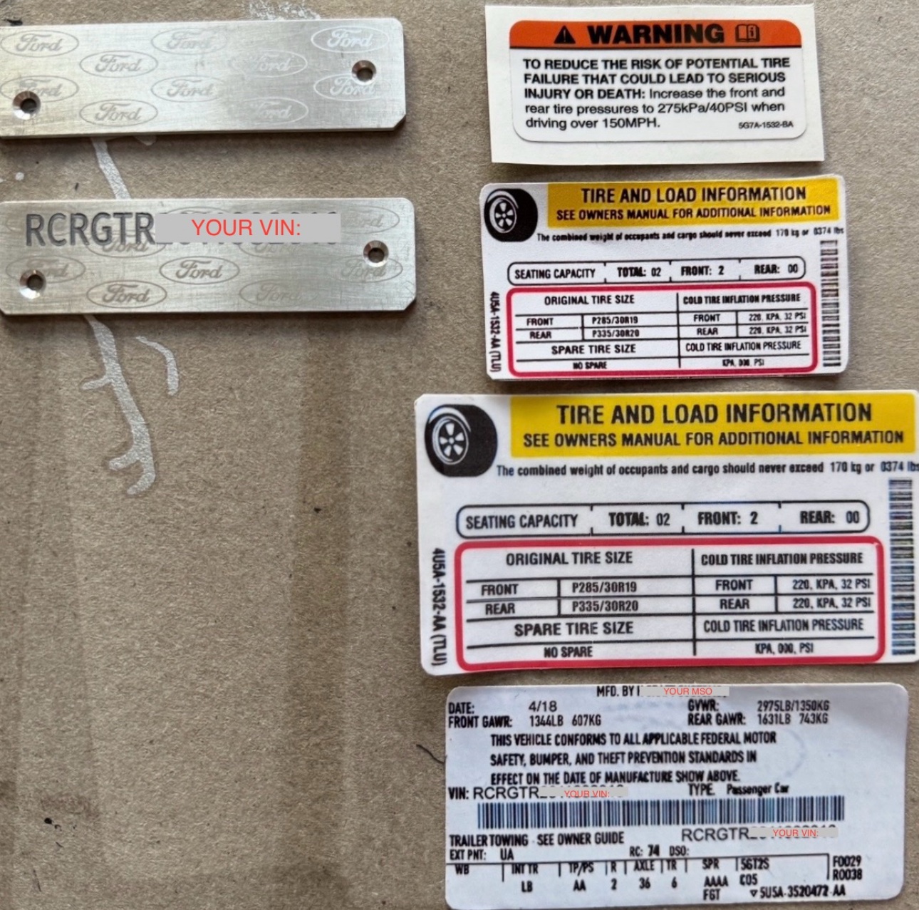

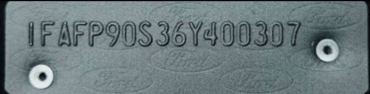

Here are items I created that are needed. I this is what I created and can offer them to whoever would want them VIN: placards and stickers

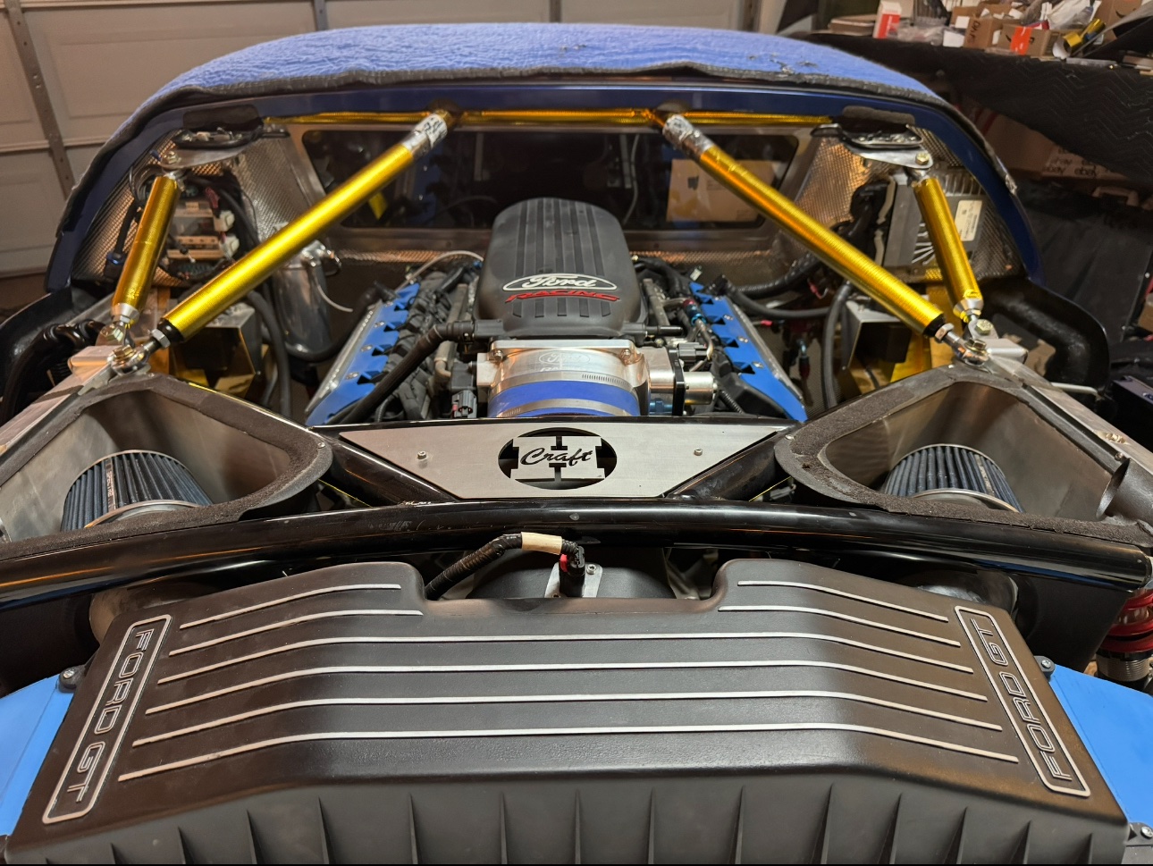

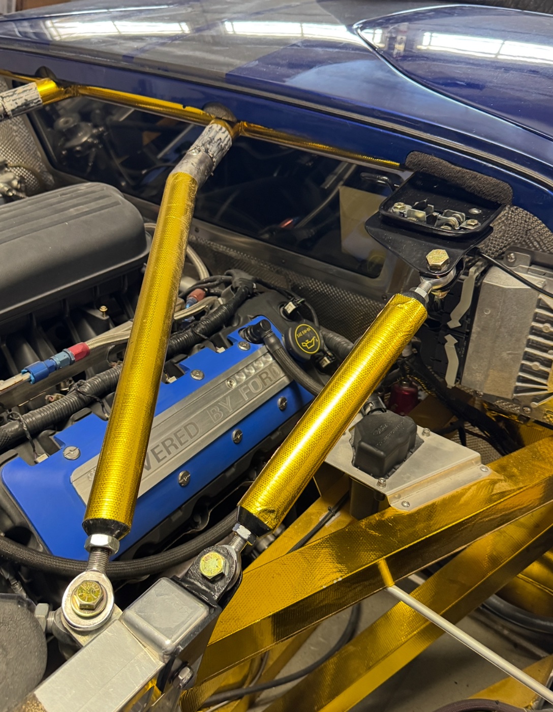

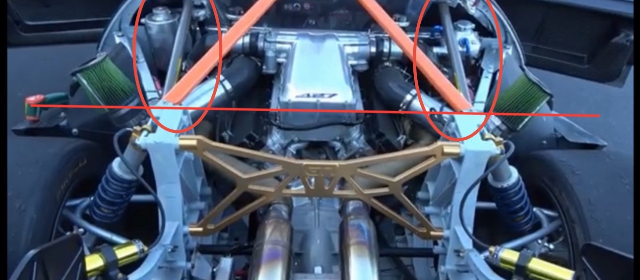

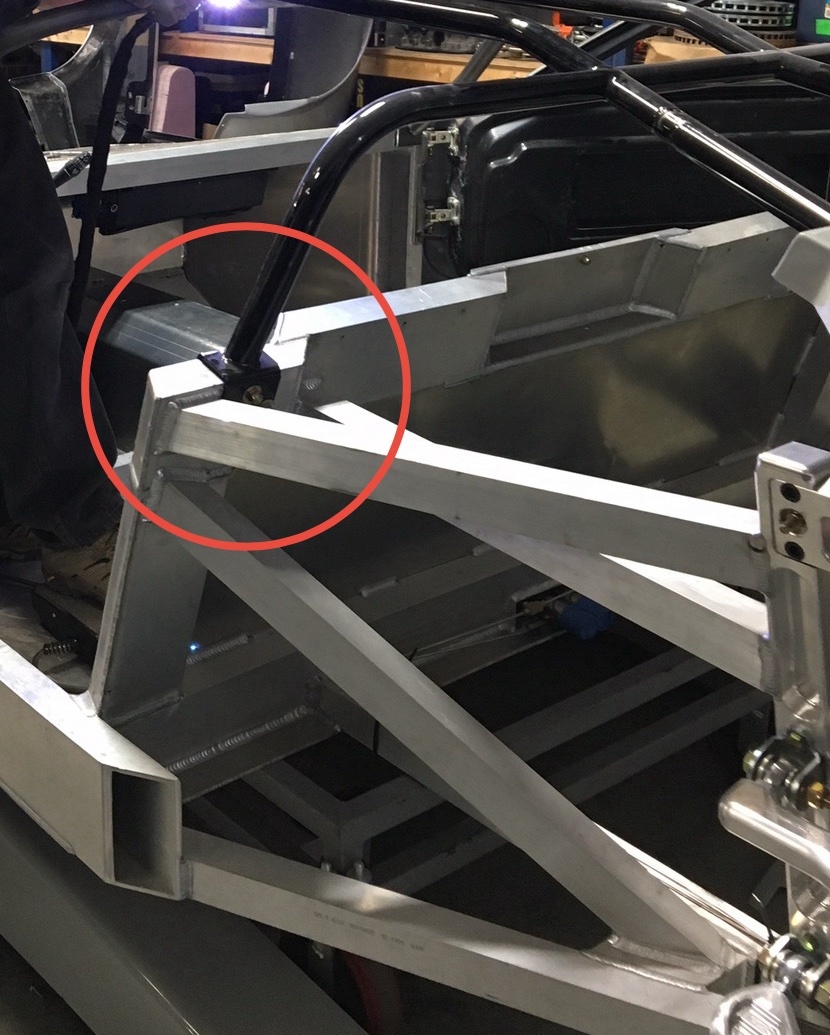

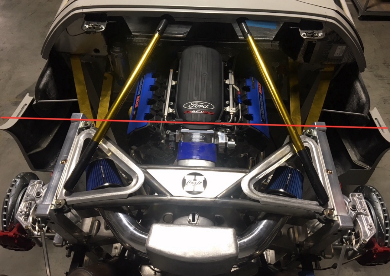

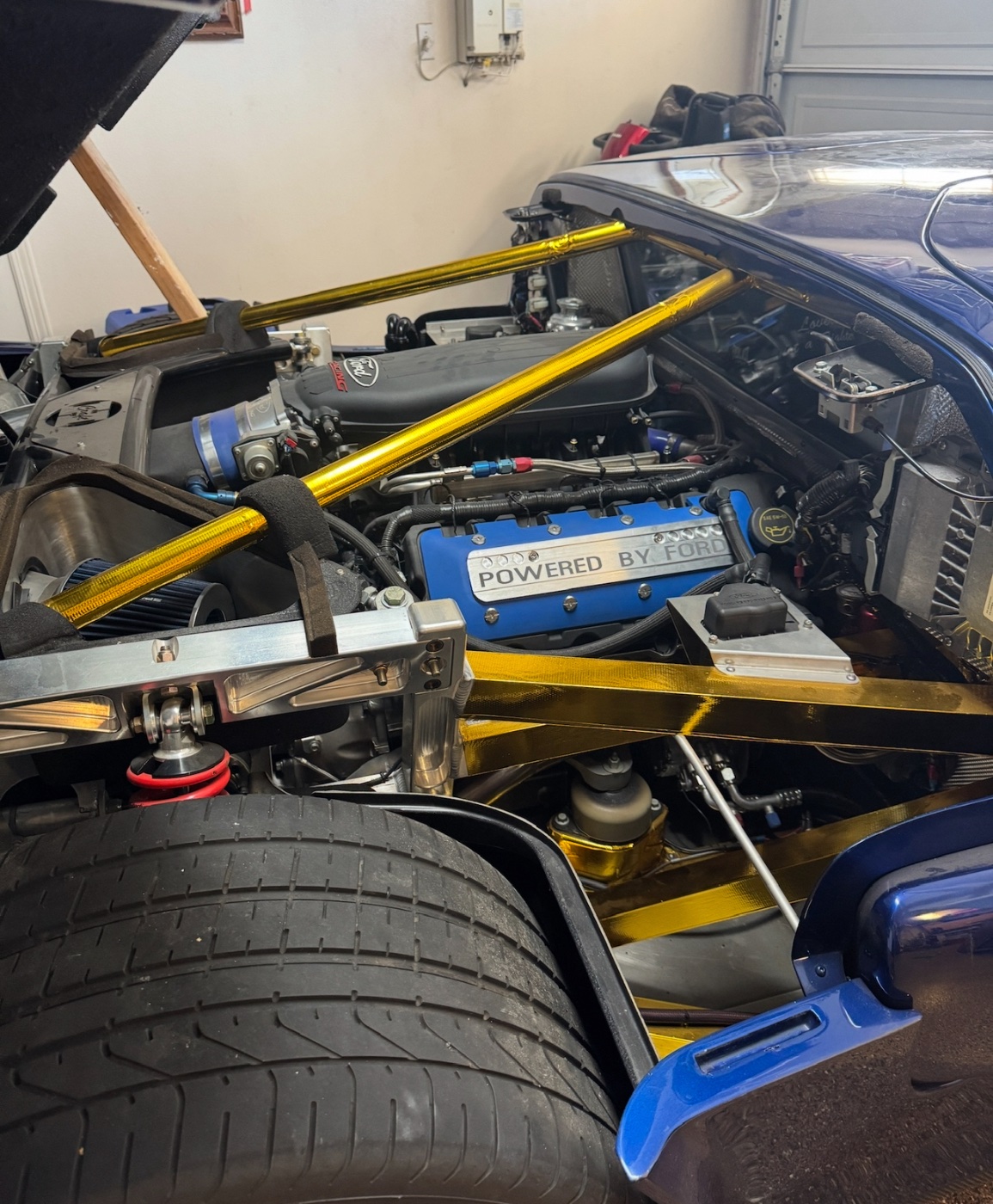

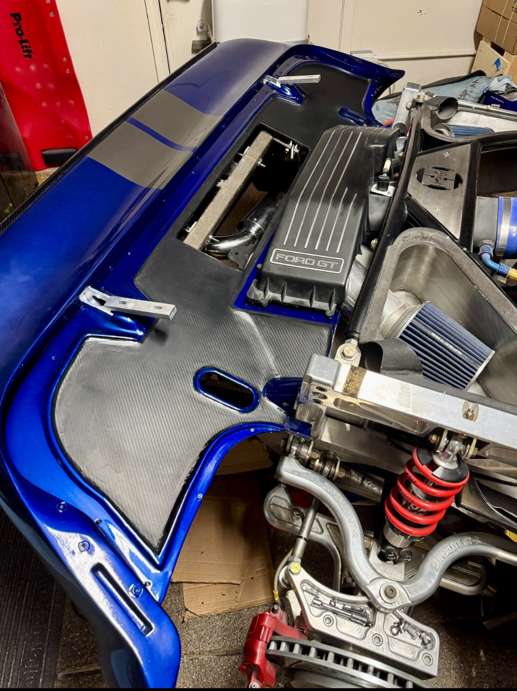

I modified the typical way the horizontal forces are canceled on the RCR Superlight frame in the engine compartment.
That tubular bars that move back from the top of the roll bar cage put the vertical mounting point of the cage to the firewall at mid height. Please last photo.
This is allowing for movement in the frame at that location and is referred to as hinging. The bars on the angle moving back to the rear connection point on the rear shock towers helps but because they are angled, lateral torsion to the centerline of the car is possible and that can translate to as much a 1/16” at the clamshell to body rear cab in the longitudinal direction.
Moving these tubes anywhere does not reduce this condition but the added tube brace in longitudinal alignment with the shock tower does eliminate the movement completely, please see photos.
This is not new but is only usually addressed on a race car frame, especially a 05-06 Ford GT frames. please see photos attached.

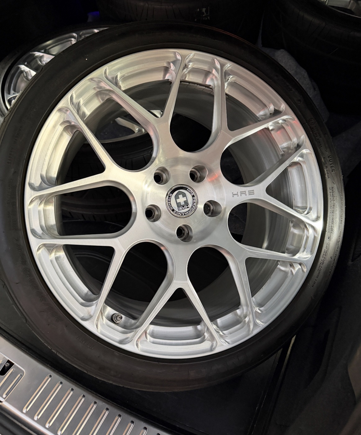

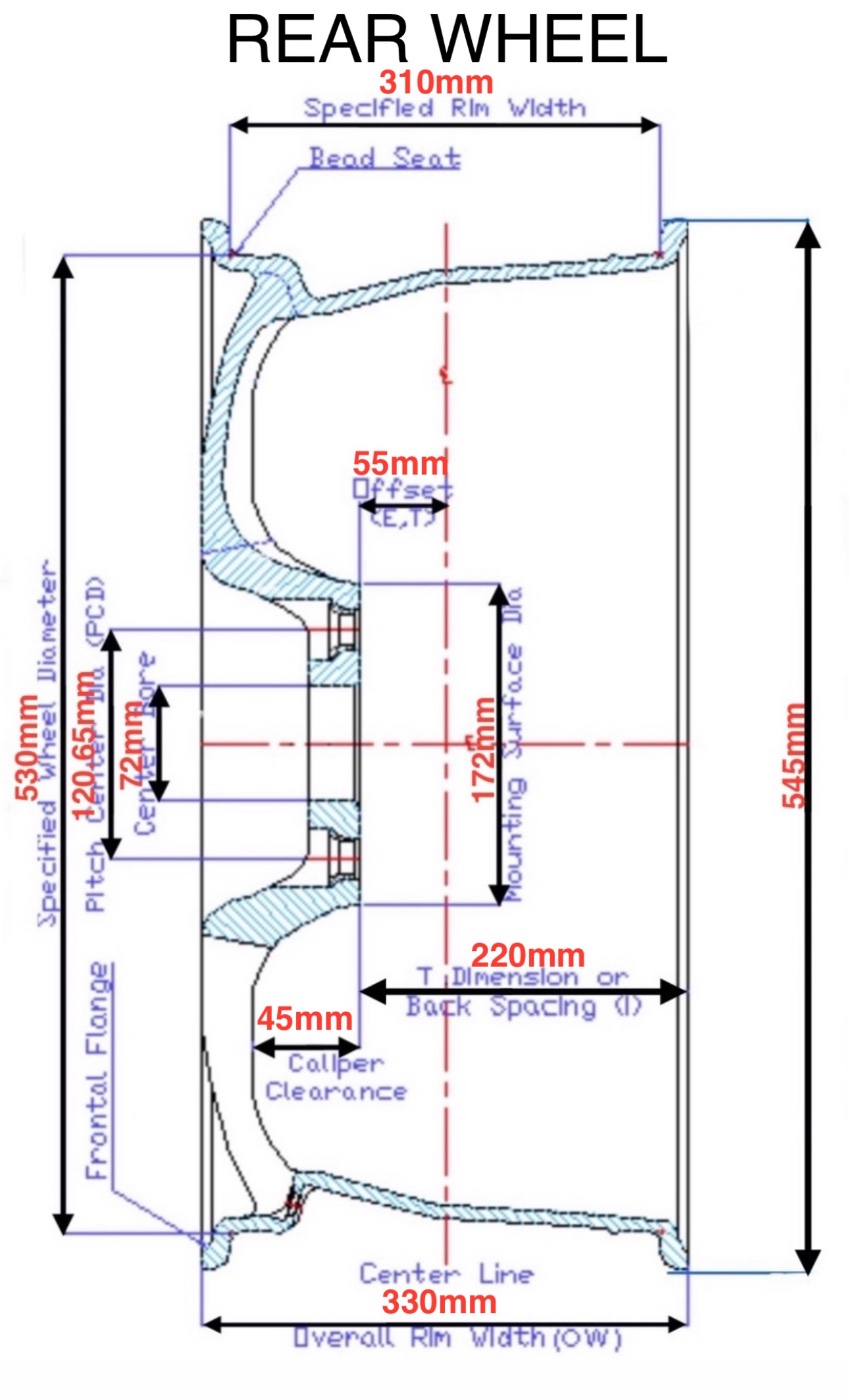

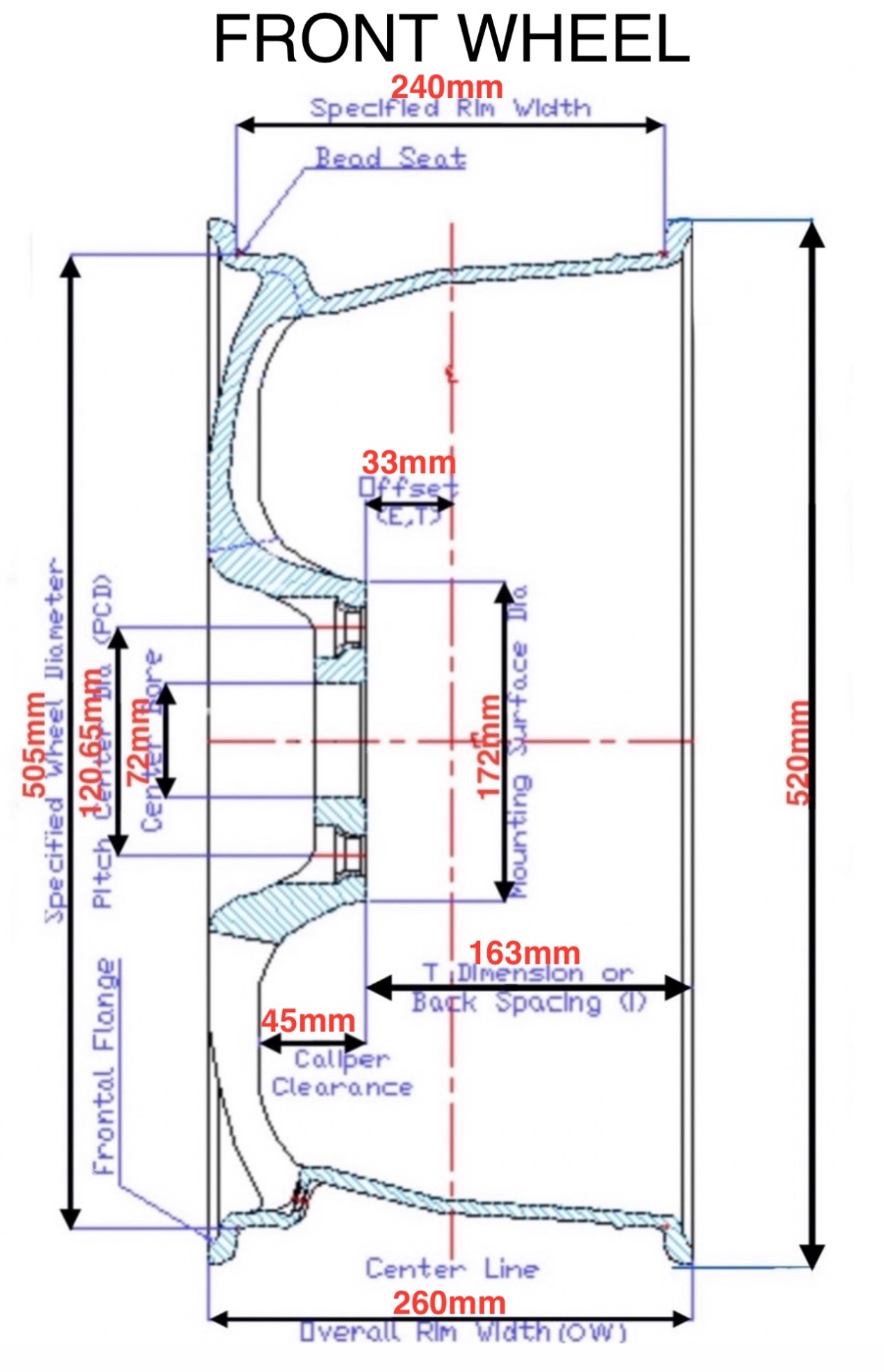

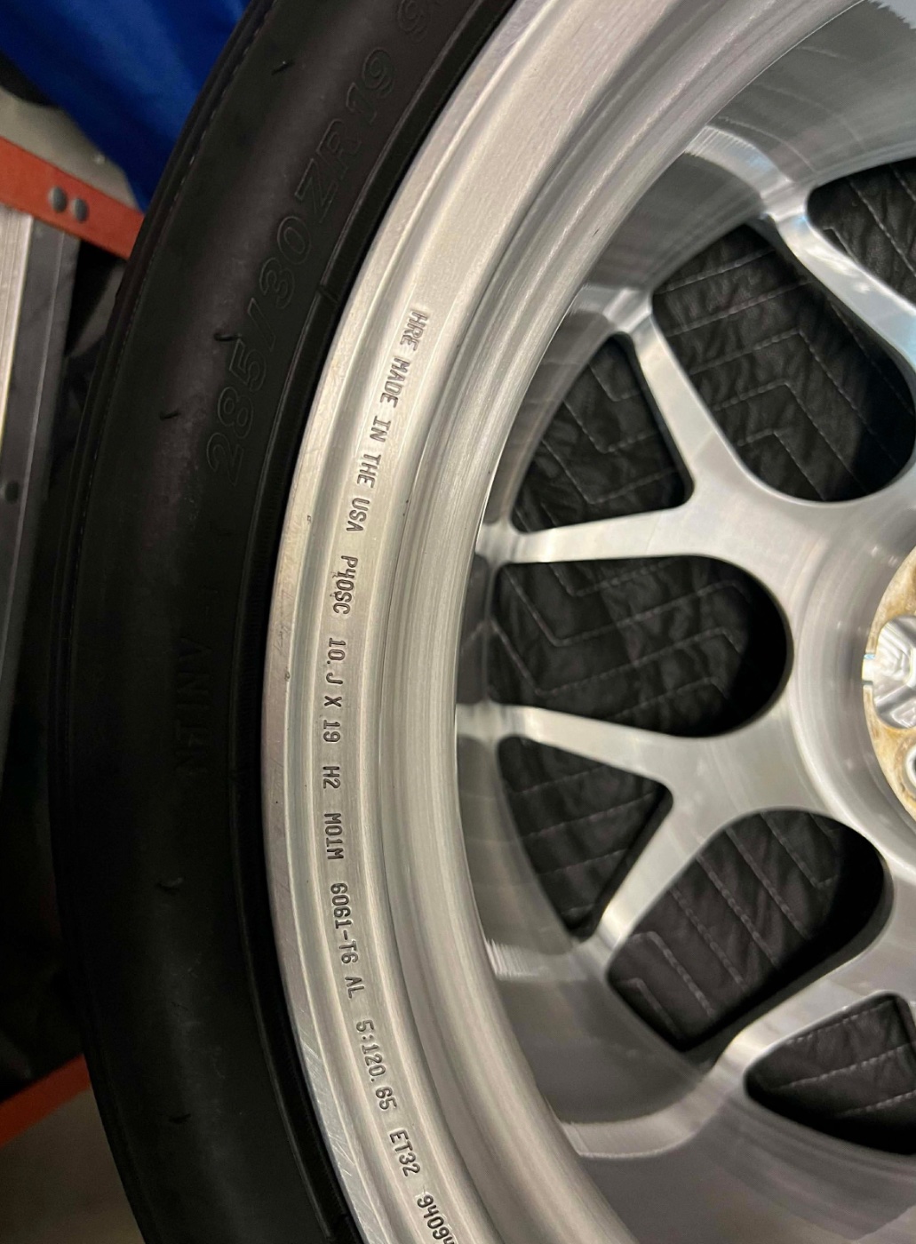

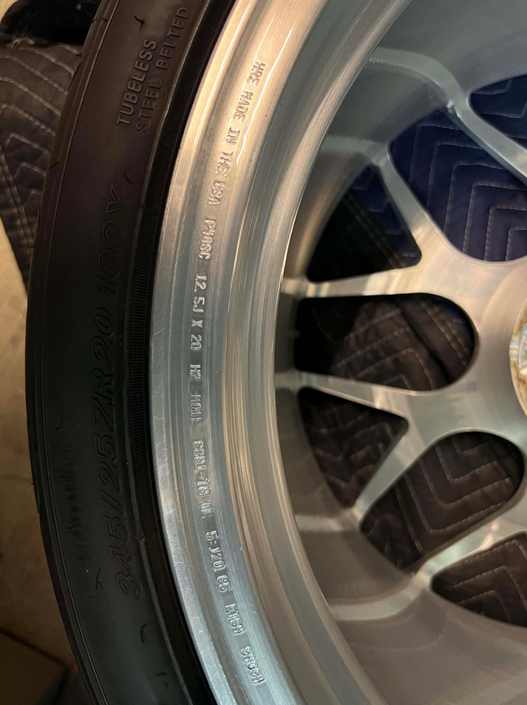

These are the rims I have put on the car
HRE. The fitment is perfect for the hubs that are set up for Forgestar’s CF5V. 19”- 20”
The lug pattern is (5)-120.65 not common!
They are HRE P40SC 19”x10” and 20”x12.5” ET 32 and 54
Offset (ET) is 33 front 55 rear these rims are within 1mm
